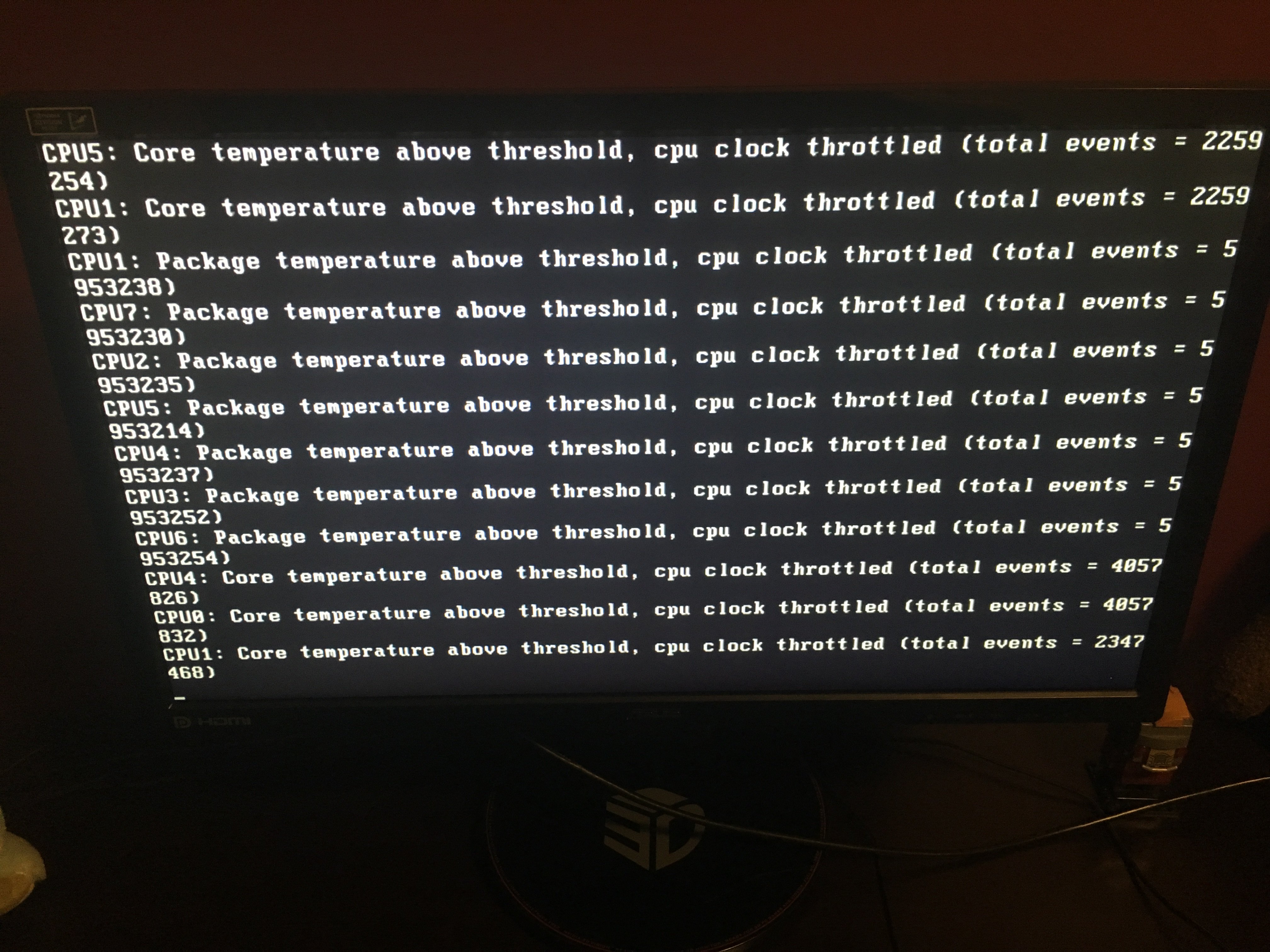

Open up the case.  Clean it out with compressed air.  (Do this is a place when the dirt won't be a problem!!!)  Pay particular attention to the CPU cooling fins.  Check to see that the fans are all running.  The CPU fan would be a prime suspect,.
it's actually extremely clean in there =\ I blow out all my system twice a year.
Leaning more towards a possible bios issue at this point. That or maybe the pump is not working as it should. it's on older i7-4770k with a 120 Corsair AIO (forget the model) but at this point yea totally worth a clean to rule it in or out. Also wonder if I have a random stock cooler that would fit to test.
Are you over-clocking this computer?  It is a general recommendation not to overclock Unraid.  (You want a stable a platform as possible when you are running a server!)

no the cpu had never been over clocked. It was a old "first" build were you just buy the "best" everything whether you are ever gonna use it's potential or not :D
