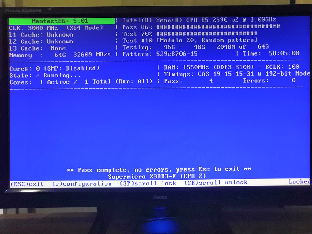

July 22, 20197 yr Author hi ! memtest result passed: 0 errors after 58 hours. the server has crash again, so i came after the memtest result. here the log from rsyslog the day before the crash, nothing in the log this time... Jul 19 13:51:07 THE-BEAST kernel: eth0: renamed from vethe9c74f1 Jul 19 13:51:07 THE-BEAST kernel: IPv6: ADDRCONF(NETDEV_CHANGE): veth167ddcd: link becomes ready Jul 19 13:51:07 THE-BEAST kernel: docker0: port 6(veth167ddcd) entered blocking state Jul 19 13:51:07 THE-BEAST kernel: docker0: port 6(veth167ddcd) entered forwarding state Jul 20 00:20:02 THE-BEAST sSMTP[12660]: Creating SSL connection to host Jul 20 00:20:02 THE-BEAST sSMTP[12660]: SSL connection using TLS_AES_256_GCM_SHA384 Jul 20 00:20:05 THE-BEAST sSMTP[12660]: Sent mail for [email protected] (221 2.0.0 closing connection m3sm12585949qki.87 - gsmtp) uid=0 username=root outbytes=1591 Jul 20 06:00:16 THE-BEAST crond[2661]: exit status 1 from user root /usr/local/sbin/mover &> /dev/null Whats next ? ++ the-beast-diagnostics-20190722-2243.zip Edited July 22, 20197 yr by ibasaw
July 25, 20197 yr Author tonight freeze again, nothing in the log .... becoming realy annoying ! i had updated to 6.7.rc2, wait and see
July 25, 20197 yr You still have a bad dimm module. As stated, memtest may or may not catch it because of ECC
July 25, 20197 yr 15 minutes ago, ibasaw said: how to find the bad one ? Pull 1 at a time and run without it. Errors continue implies bad DIMM is still installed, so switch the one you pulled with a different one and try again. When the bad DIMM is removed, the errors will stop.
