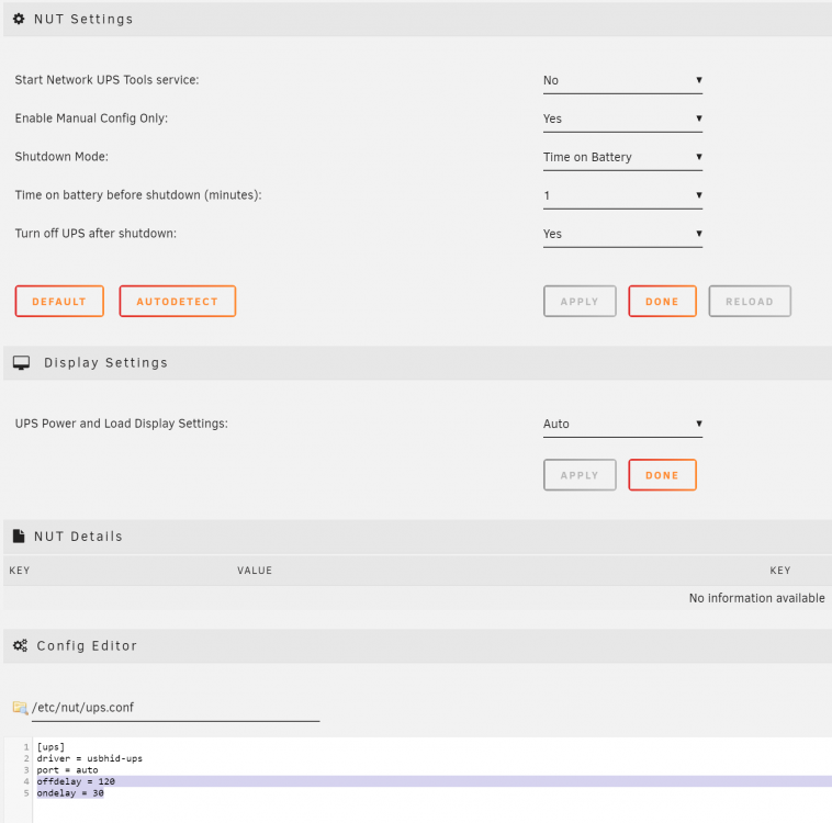

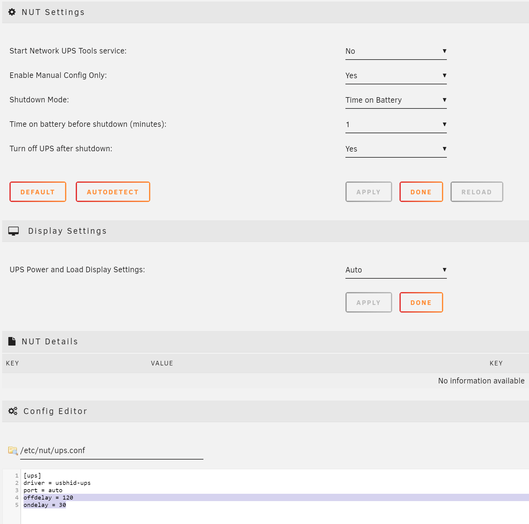

UPDATE:
I returned one of the ADATA drives and purchased a HP EX920. Both drives will now show up now.
I was doing testing on my UPS setup to make sure the server will come back on after a power outage. I have a CyberPower CP1500AVRLCD UPS and am using the NUT plugin for communication. I noticed the UPS was turning off before the server would shut down. This was causing a hard shutdown and the ADATA drive would not show up after powering the server back on, not even in BIOS/UEFI. It also wouldn't show up on subsequent reboots either. I would have to swap the drives between the M.2 slots and boot it back up for both drives to show up again (not convenient!!). I was able to tweak the settings and config files in the NUT plugin to get my desired shutdown sequence in order to avoid this problem.
In case anyone was wondering, I effectively ran the Autodetect function in NUT, switched the 'Enable Manual Config Only' option to Yes, then added the two highlighted lines in the screenshot to the ups.conf file. Adding the 'offdelay' instructs my UPS to delay its shutdown for roughly X seconds. This allowed more time for the server to shutdown. The default is 20secs which is simply not enough. I tried adding the same to the ups.conf file when the 'Enable Manual Config Only' option was set to No, but the value would default when the service was started, thus I had to set it to Yes. Below are the settings I'm using for visual reference(I didn't have the service started in the screenshot as I was still testing, I also only had the shutdown time set at 1min for testing purposes as well). Of course, your mileage may vary. Hope that helps someone!
