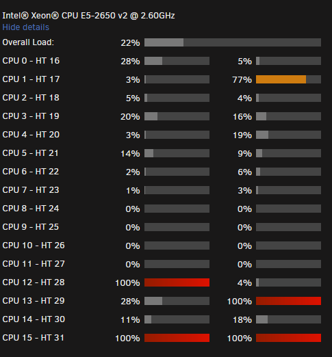

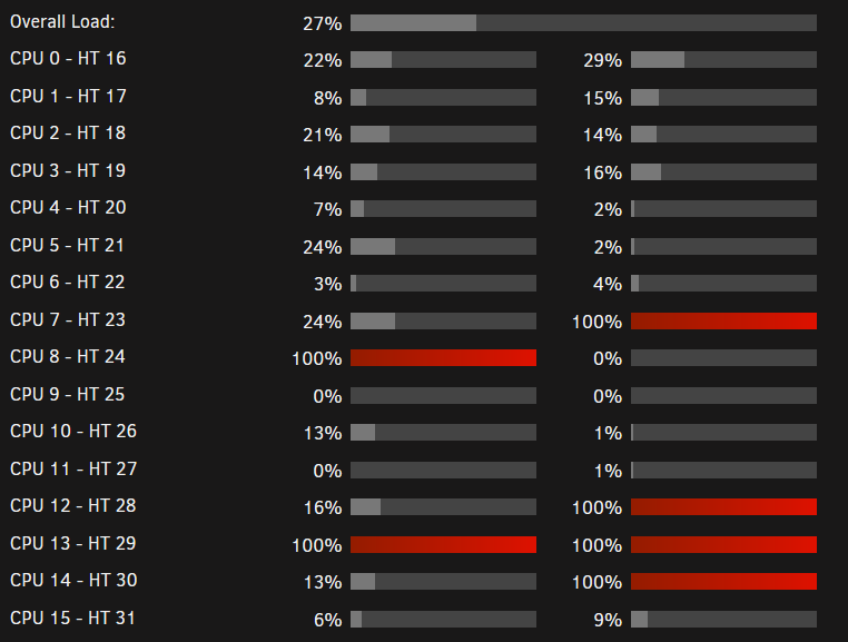

July 13, 20197 yr Hello Everyone, I'm having quite a disturbing problem on my unraid box. Every time I write something to my VideoLibrary Share - the whole system slows down. Some CPU's are then on 100%, PLEX Docker stops responding, and the disks are writing/reading even if the copy is finished. After 10min or so all is back to normal. I can't understand why. That CPU usage for a copy of a file, seems a little bit extreme... I've also tried to copy a file directly to a disk - but same issue occurred ... Has anyone an idea why this is happening and how to fix it? It's really annoying. Edited July 14, 20197 yr by TDA

July 16, 20197 yr On 7/13/2019 at 4:35 PM, TDA said: the whole system slows down. Please be more descriptive in what is slowing down. Does it take longer to navigate around the webGui? On 7/13/2019 at 4:35 PM, TDA said: Some CPU's are then on 100%, PLEX Docker stops responding, and the disks are writing/reading even if the copy is finished. Try disabling Plex and see if the same behavior occurs. First step is to isolate the issue.

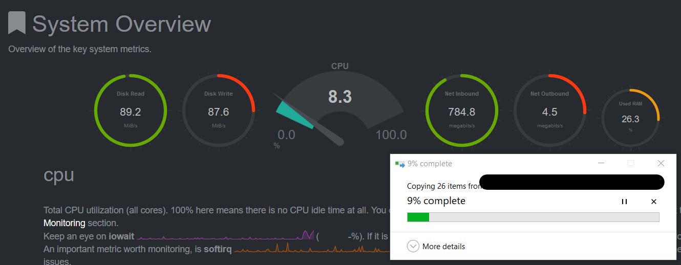

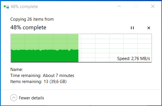

July 16, 20197 yr Author 1 hour ago, jonp said: Please be more descriptive in what is slowing down. Does it take longer to navigate around the webGui? Try disabling Plex and see if the same behavior occurs. First step is to isolate the issue. Please be more descriptive in what is slowing down. Does it take longer to navigate around the webGui? WebGUI isn't particularly slower - but it is. But access on via unc isn't possible. Try disabling Plex and see if the same behavior occurs. First step is to isolate the issue. I'm trying right now and it's not good at all ... the copy itself hangs now an then: After a little bit: Also - why it's W&R ? Should only Write or? After finishing the copy: Defragmentation hasn't a role in all of this? Edited July 16, 20197 yr by TDA Finished copy

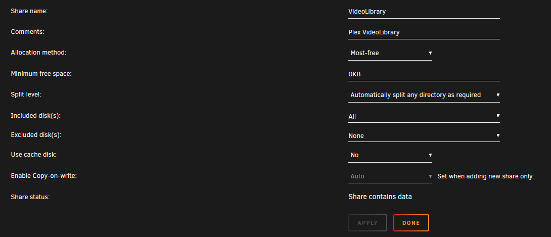

July 16, 20197 yr Due you have a cache drive? Is the share to which you are writing set to Cache Yes. What schedule do you have mover set to run? About your question on why read&write .... because when files are written to a parity protected disk a write operation actually requires a read from the parity and data disk + write to parity and data disk.
July 16, 20197 yr Author 2 minutes ago, remotevisitor said: Due you have a cache drive? Is the share to which you are writing set to Cache Yes. What schedule do you have mover set to run? About your question on why read&write .... because when files are written to a parity protected disk a write operation actually requires a read from the parity and data disk + write to parity and data disk. Hello, For the Share in question, is not Cache enabled. Edited July 16, 20197 yr by TDA

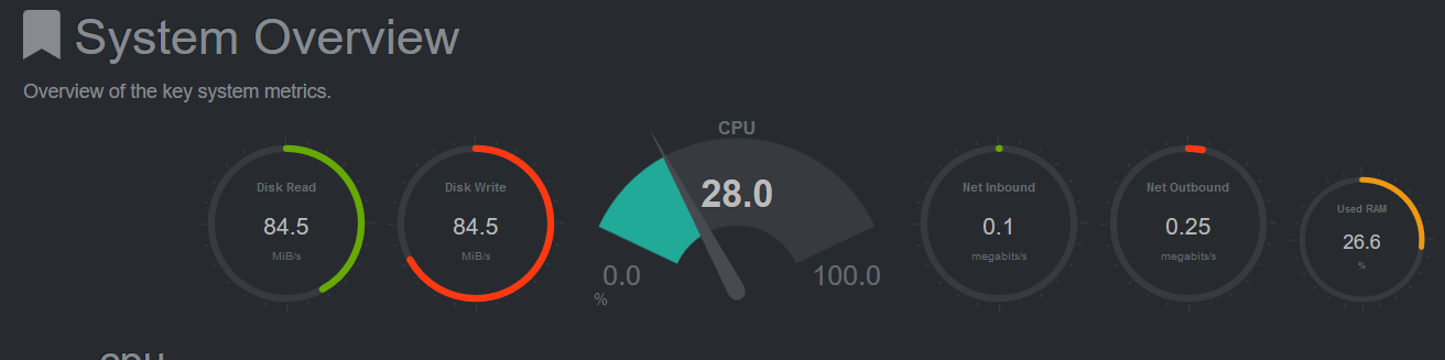

July 17, 20197 yr On 7/14/2019 at 5:35 AM, TDA said: Every time I write something to my VideoLibrary Share - the whole system slows down. Depends on how much data write and array performance, usually it need wait to complete write, if lot of RAM cache and large amount data sitting in cache, then you will got "hang" symptom. Disk array pool always worst then a high performance cache pool. On 7/14/2019 at 5:35 AM, TDA said: Some CPU's are then on 100%, PLEX Docker stops responding, and the disks are writing/reading even if the copy is finished. Since 6.7 CPU usage include I/O wait, so you no need too worries if I/O in waiting. For about PLEX docker stops responding, it seems due to disk array in busy too. 3 hours ago, TDA said: After finishing the copy: I see it still have 84.5MB R/W, so speed is normal. Suppose you already turn-on "turbo-write". May be you can try setting some turnable to see have improve or not Edited July 17, 20197 yr by Benson

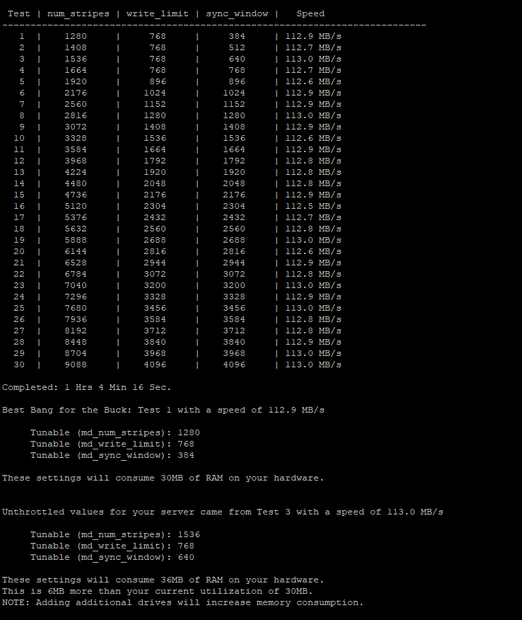

July 17, 20197 yr Author 25 minutes ago, Benson said: I know you said not use cache pool, but I am talking about RAM cache and you have 128GB, if disk array write performance lower then data input, then lot of data will sit in memory and waiting for write to array. Thats why you say job finish but R/W still ongoing. But disks performance isn't higher as the copy speed - so why should data be cached? 25 minutes ago, Benson said: If you set md_write_method AUTO, then you should try the different if set to ON. I will try 25 minutes ago, Benson said: You should try it, there are no absolute value, too large also no use. Anyway I set 10x current. I'm testing with the test-script to see which value should give better performance
July 17, 20197 yr 20 minutes ago, TDA said: But disks performance isn't higher as the copy speed - so why should data be cached? This almost same as ask why CPU have cache, HDD have cache, SSD have or haven't cache. Unraid disk array not a high performance storage, cache pool or UD much better and that's why they exist. Edited July 17, 20197 yr by Benson
July 17, 20197 yr Author 1 hour ago, Benson said: This almost same as ask why CPU have cache, HDD have cache, SSD have or haven't cache. Unraid disk array not a high performance storage, cache pool or UD much better and that's why they exist. That's the results: I have also enabled : Tunable (md_write_method): reconstruct_write (which should be the "turbo mode") I'll test this evening if there are some improvements. If not I don't really know what I could do to solve this problem (also on Windows SVR I never had such problems)

July 18, 20197 yr Author On 7/17/2019 at 1:09 PM, Benson said: All above may not solve the PLEX problem, as I know people usually set appdata path to cache pool or UD with suitable device. I mainly focus on how to get best performance on sequential R/W, data transfer, network transfer. with the new settings, now I've following scenario: - Copy from cache to disks, or from windows to disks is light fast (cause all of the thing are cached in ram) After the copy is done - disks are still working (obviously). But ... well I can live with that. Only thing (who is also obvious) is that I can't use Plex while copying cause the disks bandwidth is saturated - but that's a physical limitation. At least now I haven't to wait 10min to copy a file which is copied at 86mb/s (which the disks should support) and then wait another 10min but I copy at 500+mb/s and then wait that the files are effectively written on the disks (Luckily I've a UPS... cause otherwise if I have an electricity outage all ram cached files are gone :D) Other technical limitations is that the disks are SATA and not SCSI (with SCSI concurrent R/W is way better). Thanks for help 🙂

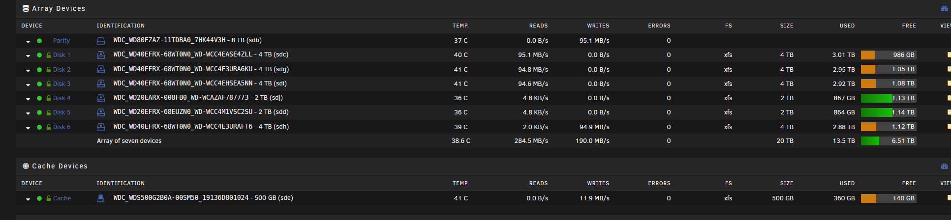

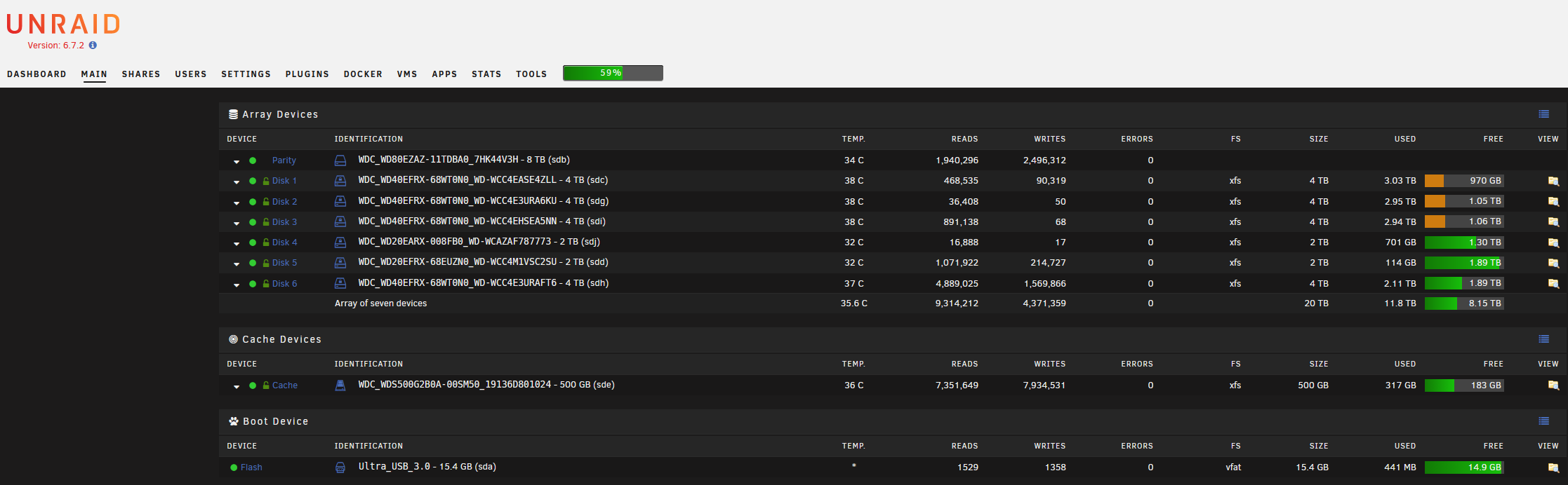

July 27, 20197 yr Author Hello, One thing I discovered, and for which I don't have an explanation is following : Now file are written back to HDD since it was cached into the RAM. That the Parity Disk is writing is clear - it has to. The File which is copying is actually goind to disk 6. So why on earth also disk 1,2,3 are working (reading)? Probably I missed something from the concept ... but this don't seems logic to me. Edited July 27, 20197 yr by TDA
July 28, 20197 yr 19 hours ago, TDA said: So why on earth also disk 1,2,3 are working (reading)? Do you have Tunable (md_write_method): reconstruct_write (which should be the "turbo mode") enabled? If so, that's how it's supposed to work.
July 28, 20197 yr Author 4 hours ago, jonathanm said: Do you have Tunable (md_write_method): reconstruct_write (which should be the "turbo mode") enabled? If so, that's how it's supposed to work. A more technical answer would be welcome 🙂
July 28, 20197 yr 1 minute ago, TDA said: A more technical answer would be welcome 🙂 A quick search would have found your answer.
July 28, 20197 yr Author 12 minutes ago, jonathanm said: A quick search would have found your answer. Thanks 🙂 Then I think I'll disable the turbo mode; every time I copy new film to my library and I or a friend is watching a movie it block all 🙂
