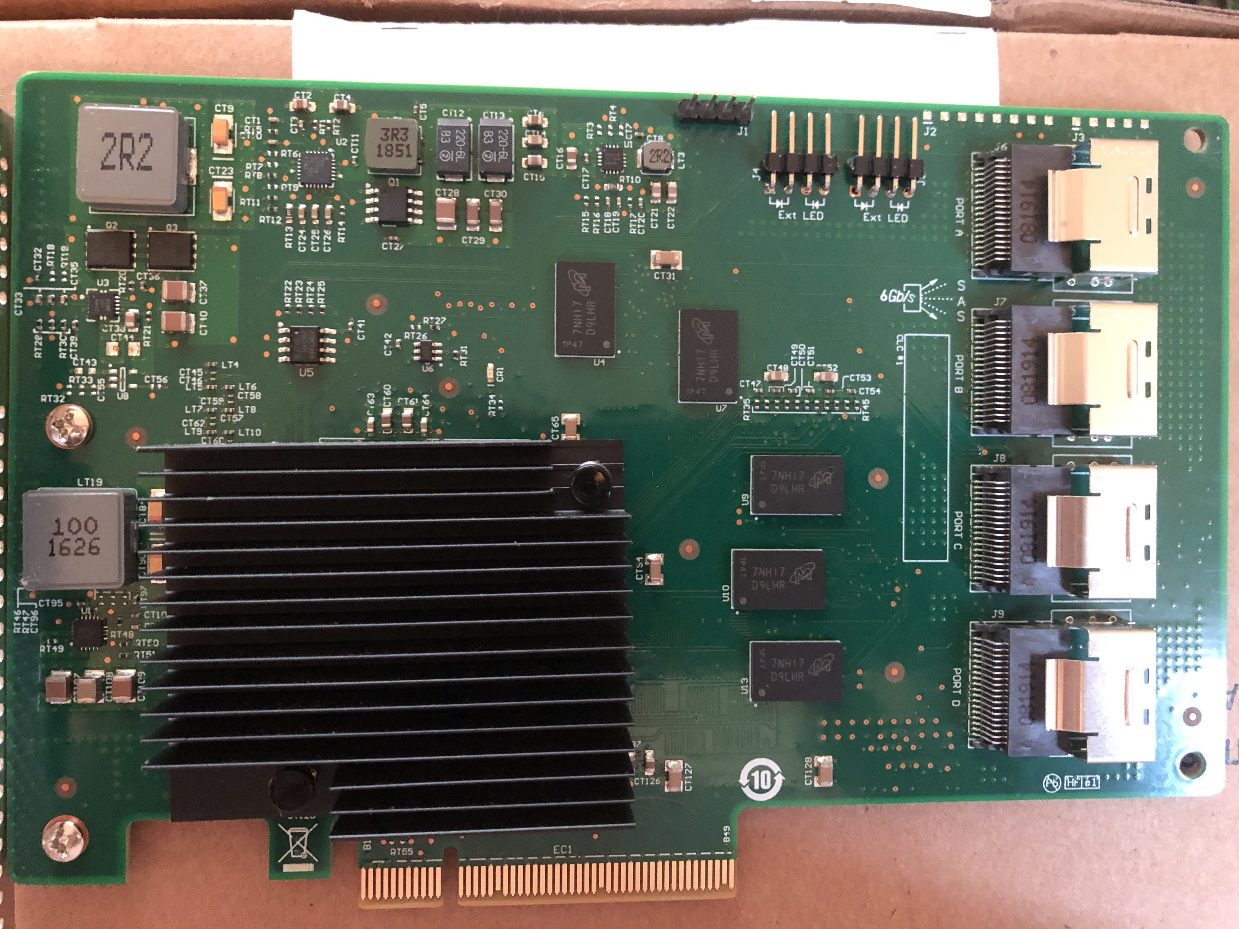

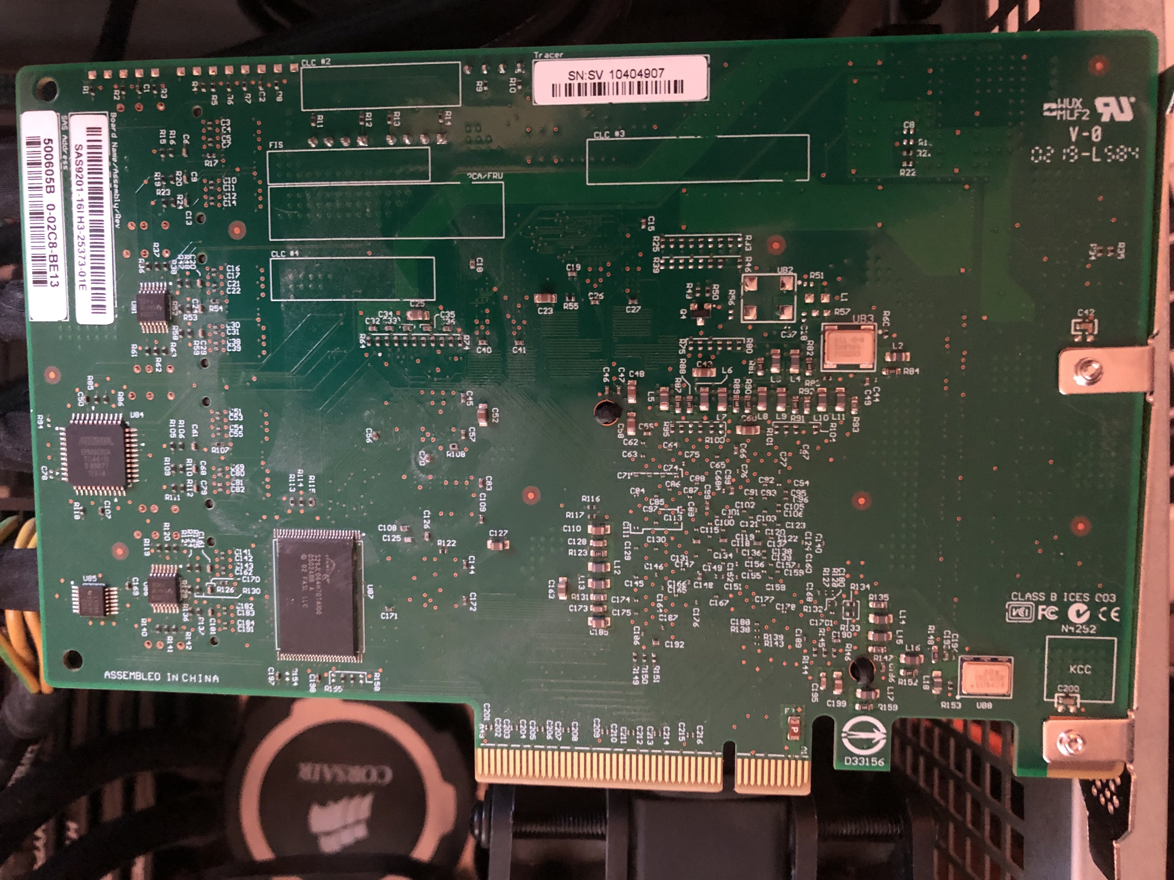

July 15, 20197 yr Author Before I follow the procedure completely, I decided to spend a little more time investigating the cause of the UDMA CRC errors. It looks like my LSI controller might not be genuine, but I'm not able to confirm that yet. I did cancel the parity read check but decided before I try the rebuild on my spare drive, I've decided to run one more zero pass. I know it isn't strictly necessary, but I wanted to confirm the drive is OK. I've been doing the zero pass using the Preclear plugin and just disabled the pre and post read stages. At first I was seeing some more UDMA CRC errors, but no actual read or write errors. And no re-allocated sectors at current. I've got another couple of hours to wait before the zero stage completes. At that time I'm definitely going to shut down and move one of the 10TB UD mounted drives off the MB SATA. Temporarily I'll re-attach it via USB rather than take my chance on more errors from the possibly fake LSI controller. I will of course attach the spare 8TB to the MB SATA for the data rebuild. Does anyone have any suggestions on how I can test the LSI to see if it's actually causing some of these issues? I'm planning to order a genuine LSI card from a US vendor as a backup, but have to wait until I get my next disability payment next week. In the meantime, if there are procedures anyone can recommend, I'm willing to give it a go. Before I try and go back to eBay and/or the Chinese supplier of my LSI controller, I want to try and confirm if it's part of the problem. I'll take some close-up photos so I can try and verify if the card is indeed a fake or if it was just pulled from surplussed servers. It did come in a plain brown box like a lot of generic items, but I've found one supplier in California selling them in the genuine LSI box: https://www.ebay.com/itm/312653733132 Suggestions?

July 15, 20197 yr Author Just heard back from Broadcom/LSI and they are fairly certain that the controller is a fake. I'm going to wait until the zero pass finishes on the replacement 8TB spare drive and then I'll shut the system down and take some photos of the card to send back to LSI for confirmation. Looks like I should order the 'genuine' card ASAP.

July 16, 20197 yr Author Update: the zero of the 8TB completed with no more UDMA CRC errors and no reallocated sectors or anything else to worry about. I shut the array down and moved the disks so that the 8TB replacement was attached to a motherboard SATA port. I did place the 10TB drive into another bay, but since it's UD mounted and read-only data (movies/TV) for Plex, that shouldn't cause any real issues. While the array was powered down, I also removed the LSI controller and took some pics that I've now sent to LSI to see if they can identify the card. Also, since I had removed all the cables from it, I then booted off a Win10 SSD as the only device attached to the motherboard. From there I proceeded to use the LSI sas2flash utility for x64 so I could download the firmware, bios and nvram files just in case LSI wants to take a look at them. I then proceeded to update the 9201-16i with the latest IT firmware (P20) and the latest bios that came with the firmware package. After verifying it all looked fine, I shut down again and disconnected the Win10 SSD. I then re-connected all of the cables to the motherboard SATA and LSI controller. The boot was normal from what I could see. Once booted to the login screen, I opened the webgui from my main system and assigned the replacement 8TB to the Disk 8 slot. Upon starting the array it proceeded with the start of the parity rebuild for Disk 8. I'll be waiting about 15 - 20 hrs for that to complete. Once it's complete, I'll then stop the array and add the new 10TB Ironwolf (which also finished its preclear/stress test run) and assign it as my 2nd parity drive. I'm sure that will take another 20 hrs or so to build the 2nd parity drive. But for now, the system looks good. I'll try to not add any new data to the array and instead use the cache drive and/or a temporary disk mounted in UD if I need to. I'm attaching the pics of the suspected fake 9201-16i controller, just in case anyone here wants to take a gander. Thanks again @johnnie.black, @Benson and also @Squid who responded in a related post in the Hardware forum. Dale
July 17, 20197 yr Author The rebuild of Disk 8 was successful while connected to the motherboard SATA port. I've now stopped the array, added the new 10TB Ironwolf as the 2nd parity drive, and restarted the array. The parity sync/build for Parity 2 is underway.... 20 hrs to go for dual failure protection to be active. LSI got back to me re: the pictures and although the card looks good physically, the labelling is good except for the serial number. The number is not in their manufactured database and is in a format that's wrong for this series of card. They've given me some instructions and tools that should work from a terminal session under unRAID to do some diagnostics. I will wait for the 2nd parity disk to finish syncing before doing anything else. I also got shipping confirmation on the replacement miniSAS cables and they could be here by the end of this week. Once they arrive I'll shutdown, swap out the cables, disconnect all unRAID disks and do some testing with the controller and the tools that LSI supplied. I have two spare drives that I can use for testing purposes, one 10TB and one 8TB which I can move between bays of the enclosure to run the tests on each of the 4 SAS/SATA connections per backplane. The only ones I'll not bother testing are the ones that are connected to motherboard SATA ports as none of them have ever reported errors. I may use them initially, since they have been reliable and would be a good indicator if they failed while attached to the LSI controller vs the MB SATA. When attached to the MB SATA ports, those drive bays have been error-free - that would almost definitely point to the LSI controller as the faulting unit. When I get my next disability check, I'm going to go ahead and order a new LSI card from the eBay vendor that guarantees a new-in-box unit from LSI. It won't hurt to have a spare even if the existing controller proves to be OK. More to come when I get some of the testing done.
