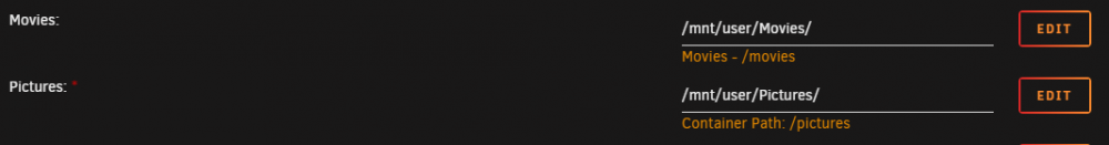

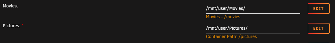

You need to do what Squid said and in the Plex docker edit screen map an unRAID host path (e.g /mnt/user/media) to a docker container path (/media).  In Plex you would then browse to /media to look for the folder names that correspond to each media type.  This of course assumes that you have a different folder for movies, photos, music, etc.  I chose to create a different unRAID share for each media type (rather than folders under a Media share) so I have a mapping to each share.
Here are a couple of mine as examples:
