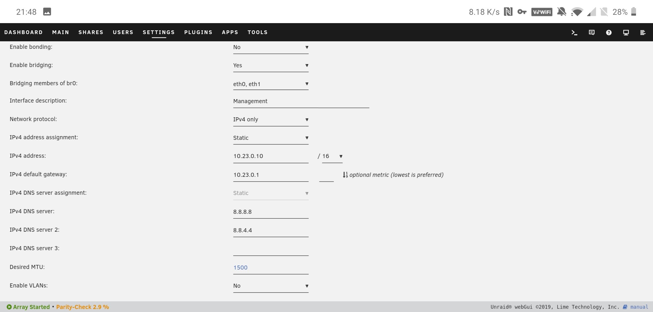

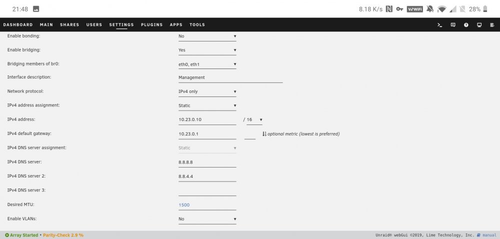

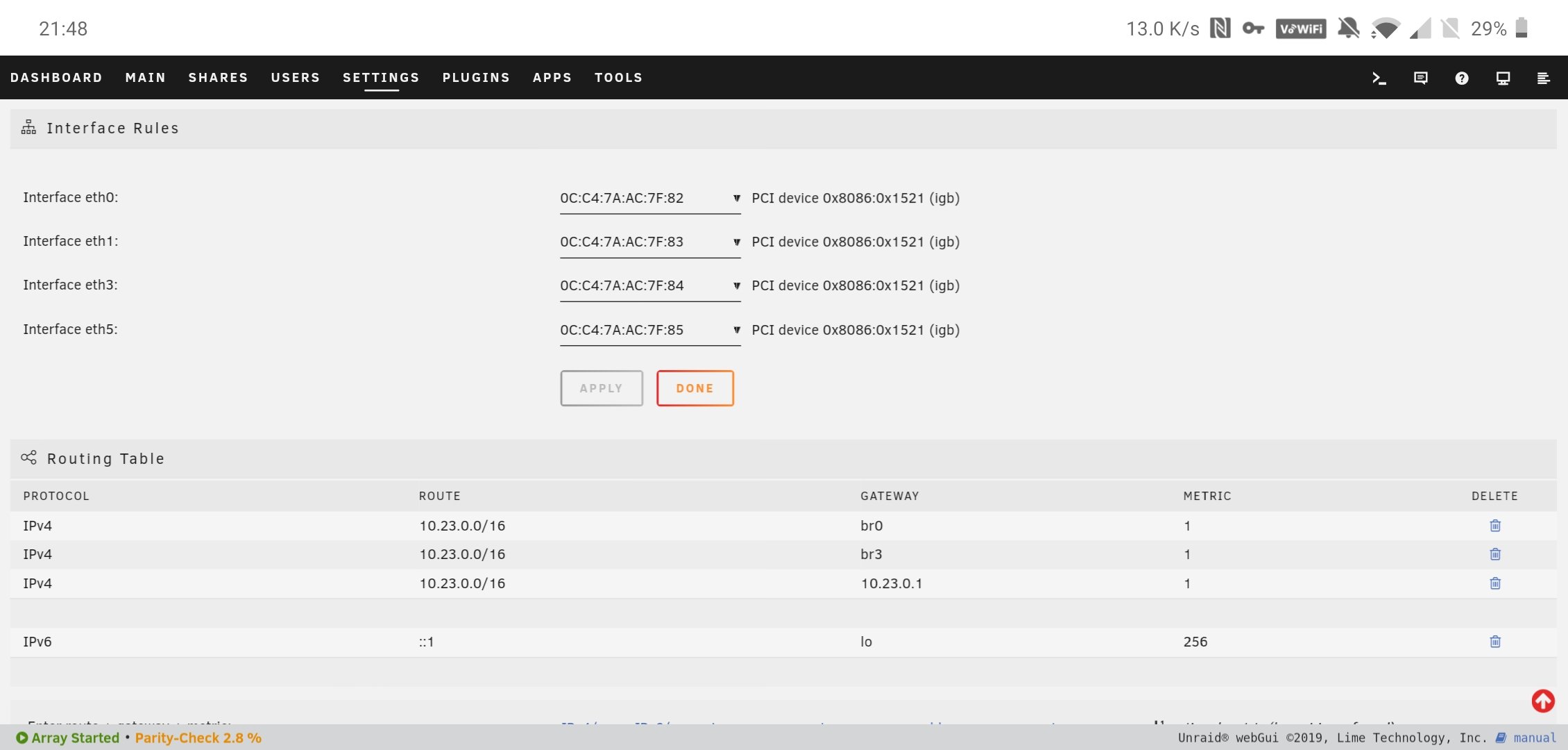

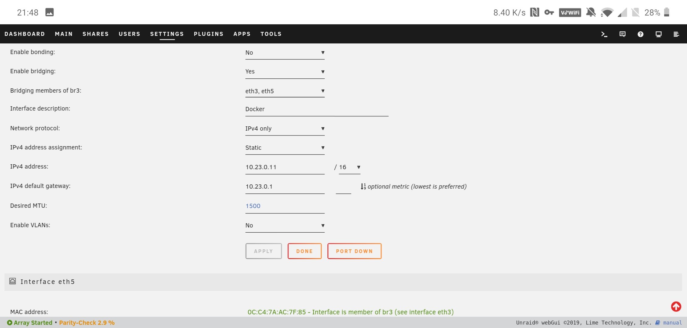

July 21, 20197 yr Author Right I've got a bit further I think....! It seems the host was trying to route through br7 randomly (an old bridge interface that I had removed all interfaces from, but apparently hadn't deleted the bridge itself?) So having done ifconfig br7 down, it's gotten rid of that interface. Now when I ping from terminal I get a reply saying network unreachable, rather than a host unreachable reply from the br7 address. Presumably I need to add a route back in, in order to get everything to route through the correct interface again, which I think I've done, but still having no joy. Attached a screenshot of my routing table. Also attached is screenshots of the br configs. Any ideas? Thanks
July 21, 20197 yr Author More developments... Managed to delete br7 and br6 and setup a default route for br0. Great. Reboot - br7 and br6 come back, default route disappears ☹️ I'm doing all these changes in terminal. Any ideas how to make them stick?
