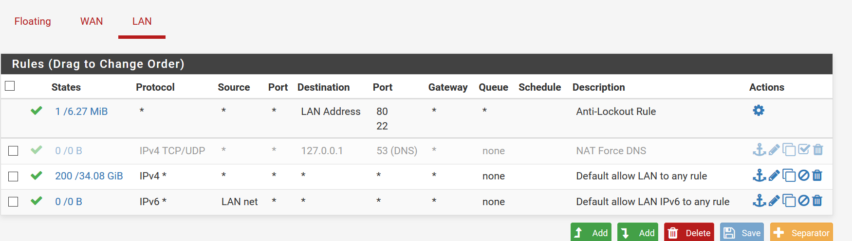

Can you upload a picture of your firewall rules?  Because you shouldn't be port forwarding in pfSense, but allowing through on the firewall tab.
So my rules are like:
Allow IPv4 UDP 1194 WAN
Block IPv4+6 WAN
Allow IPv4+6 LAN
So I block all incoming to WAN, except OpenVPN, and that rule needs to be above my block incoming.  And then I allow everything from LAN out.
That's a basic configuration.
Block IPv4+6 WAN
Allow IPv4+6 LAN
Can you also look at your routes:  Should be System->Routing.  Your new router could be sending IPv6 downstream, and you aren't picking it up or including it in your firewall rules.

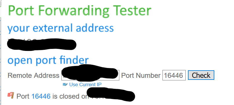

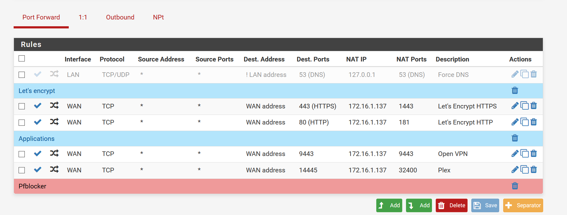

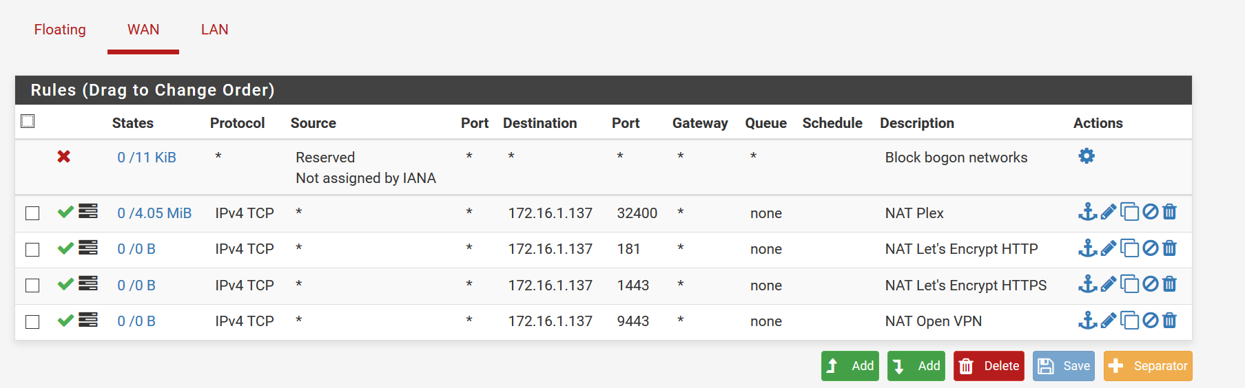

PfSense has an option to port forward and it's basically a rule that creates automatically. Look this is all I have
I also have traffic shapper enabled, but I don't think that will give me issues
And I don't get this.
The ports get open and work. But after you try, they get blocked. If I were to trace connections in PFsense. Where can I go?
If I check in yougetsignal.com I can see the port is open, but after I try to connect it gets rejected. Traffic Shaping will be part of the problem ?

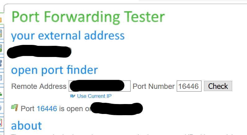

I finished troubleshooting and yes I think Comcast is blocking the ports T.T
To confirm this I did the following. Disconnected my pfsense and connected directly to the core router (Comcast)
I downloaded a free ftp application to my phone using port 16446 and forwarded the port.
You see the port open and everything. And I'm bypassing pfsense. I'm connected directly to main router coming from the ISP. Now If I try to connect, it works for a second and then they block.
Edited by gacpac
