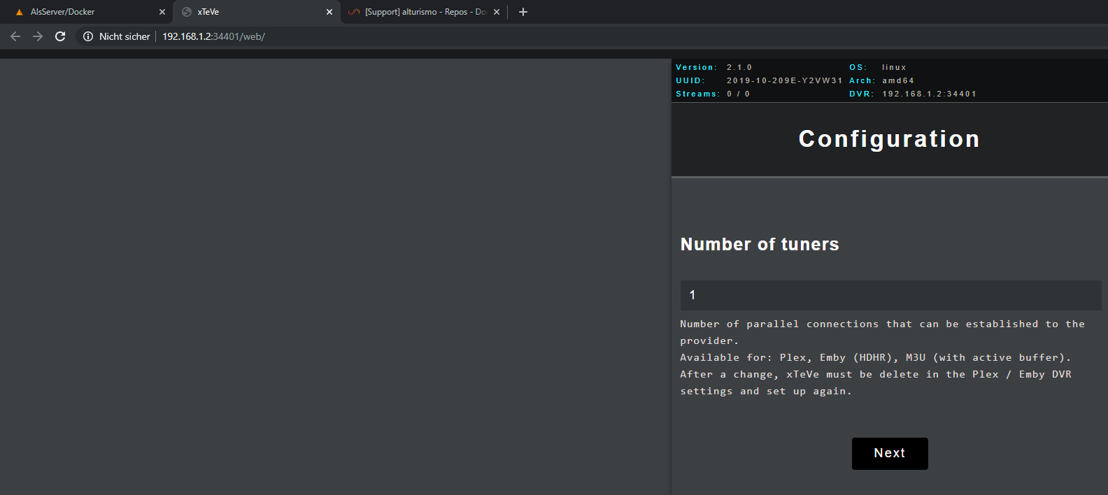

Hi, thanks so much for taking the time to reply!
This is what I would like to do but I can see no way of changing the port?  otherwise I would have 2 instances of xteve running on 192.168.0.44:34400 ?
there should be a sample_xteve.txt file in your /_config folder ... when you open it ...
i added a optional startup for xteve extra for cases like this so you can choose ...
may check the readme, so when u edit and rename the file, xteve should start with those options.
i hope this answers your question ;)

Hey, hoping you can help me.
When trying to connect Plex Media Server to my Xteve container, the Xteve "tuner" appears and then disappears while I'm reviewing channels.
I was able to get it to configure eventually, but now Plex indicates "Device not found. Ensure your device is powered on and connected to your network."  I am able to connect to xteve via the WebGui and via VLC
Both Plex and XTeve are configured as Dockers in Unraid using "Host" network types.  This feels like a network configuration issue for my dockers.
when using host mode theres not much you could do wrong, may one thing, try with dlna off in plex.
also in case u already tested some more tv proxies in plex, may clean up ...
check at the discord channel on xteve for specific help there about the app.

@mbc0
i just made a fresh docker install to test (u did clear /appdata ?)
works as expected ...sorry to say
from the log
2019/10/28 22:17:25 [xTeVe] Version: 2.0.3 Build: 0030
2019/10/28 22:17:25 [xTeVe] Database Version: 2.0.0
2019/10/28 22:17:25 [xTeVe] System IP Addresses: IPv4: 2 | IPv6: 0
2019/10/28 22:17:25 [xTeVe] Hostname: 761e9ed15933
2019/10/28 22:17:25 [xTeVe] System Folder: /root/.xteve/
2019/10/28 22:17:25 [xTeVe] Load Settings: /root/.xteve/settings.json
2019/10/28 22:17:25 [xTeVe] Temporary Folder: /tmp/xteve/2019-10-209E-Y2VW31/
2019/10/28 22:17:25 [xTeVe] GitHub: https://github.com/xteve-project
2019/10/28 22:17:25 [xTeVe] Git Branch: master [xteve-project]
2019/10/28 22:17:25 [xTeVe] SSDP / DLNA: true
2019/10/28 22:17:25 [xTeVe] Update Available: Version: 2.1.0.0100
2019/10/28 22:17:25 [xTeVe] Update Server: GitHub
2019/10/28 22:17:25 [xTeVe] Start Update: Branch: master
2019/10/28 22:17:25 [ZIP] New version (xteve_2): 2.1.0.0100
2019/10/28 22:17:27 [ZIP] Download new version...
2019/10/28 22:17:28 [ZIP] Update file: xteve
2019/10/28 22:17:28 [ZIP] Unzip ZIP file...
2019/10/28 22:17:28 [ZIP] Unzip ZIP file...OK
2019/10/28 22:17:28 [ZIP] Copy binary file...
2019/10/28 22:17:28 [ZIP] Copy binary file...OK
2019/10/28 22:17:28 [ZIP] Update Successful
[33m[0m[0m[0m[0m[0m[0m[0m[0m[0m[0m[0m[0m[0m[0m[0m[0m[0m[0m[0m[0m[0m[0m[0m[0m[0m[0m[0mFor help run: ./xteve -h
2019/10/28 22:17:28 [xTeVe] [WARNING] Don't run this as Root!
2019/10/28 22:17:28 [xTeVe] Version: 2.1.0 Build: 0100
2019/10/28 22:17:28 [xTeVe] Database Version: 2.1.0
2019/10/28 22:17:28 [xTeVe] System IP Addresses: IPv4: 2 | IPv6: 0
2019/10/28 22:17:28 [xTeVe] Hostname: 761e9ed15933
2019/10/28 22:17:28 [xTeVe] System Folder: /root/.xteve/
2019/10/28 22:17:28 [xTeVe] Load Settings: /root/.xteve/settings.json
2019/10/28 22:17:28 [xTeVe] Temporary Folder: /tmp/xteve/2019-10-209E-Y2VW31/
2019/10/28 22:17:28 [xTeVe] GitHub: https://github.com/xteve-project
2019/10/28 22:17:28 [xTeVe] Git Branch: master [xteve-project]
2019/10/28 22:17:28 [xTeVe] SSDP / DLNA: true
2019/10/28 22:17:28 [xTeVe] UUID: 2019-10-209E-Y2VW31
2019/10/28 22:17:28 [xTeVe] Tuner (Plex / Emby): 1
2019/10/28 22:17:28 [xTeVe] EPG Source: PMS
2019/10/28 22:17:28 [xTeVe] Plex Channel Limit: 480
2019/10/28 22:17:28 [xTeVe] All streams: 0
2019/10/28 22:17:28 [xTeVe] Active streams: 0
2019/10/28 22:17:28 [xTeVe] Filter: 0
2019/10/28 22:17:28 [xTeVe] DVR IP: 172.17.0.2:34400
2019/10/28 22:17:28 [xTeVe] Web Interface: http://172.17.0.2:34400/web/ | xTeVe is also available via the other 1 IP.
webui
docker ...
all good here ... please try with a fresh install and not with existing appdata, can be the only thing something is not compatible
I was trying to find a way to recover this without losing all my settings and I did! 🙂
I moved the appdata, re-installed, docker ran then xteve updated and was working so I then stopped the docker and copied the appdata back (all apart from authentication.json which I guess for security would not read?) but all working perfectly again now on 2.1.0 with all my recovered settings! 🙂 hope this helps someone else, thanks so much for this docker and your time @alturismo
