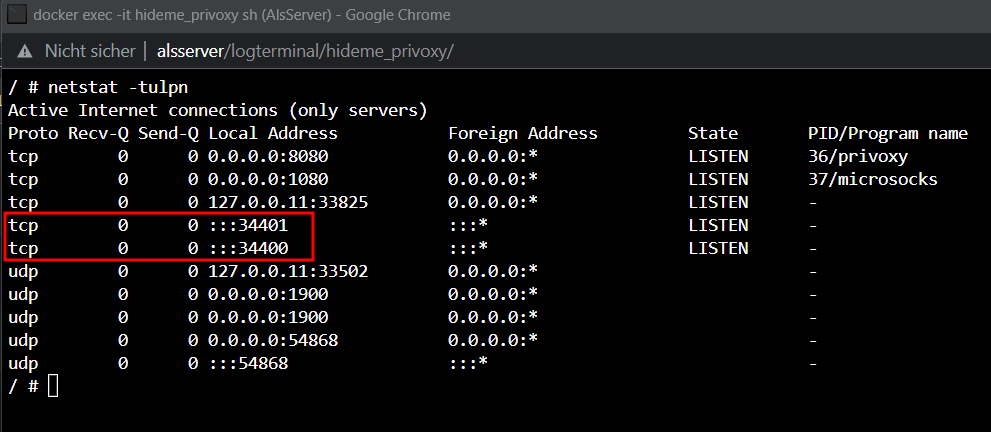

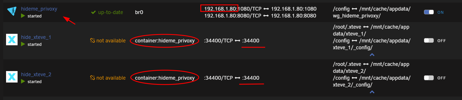

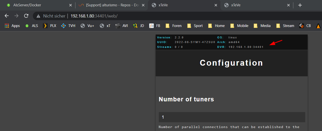

6 hours ago, alturismo said:

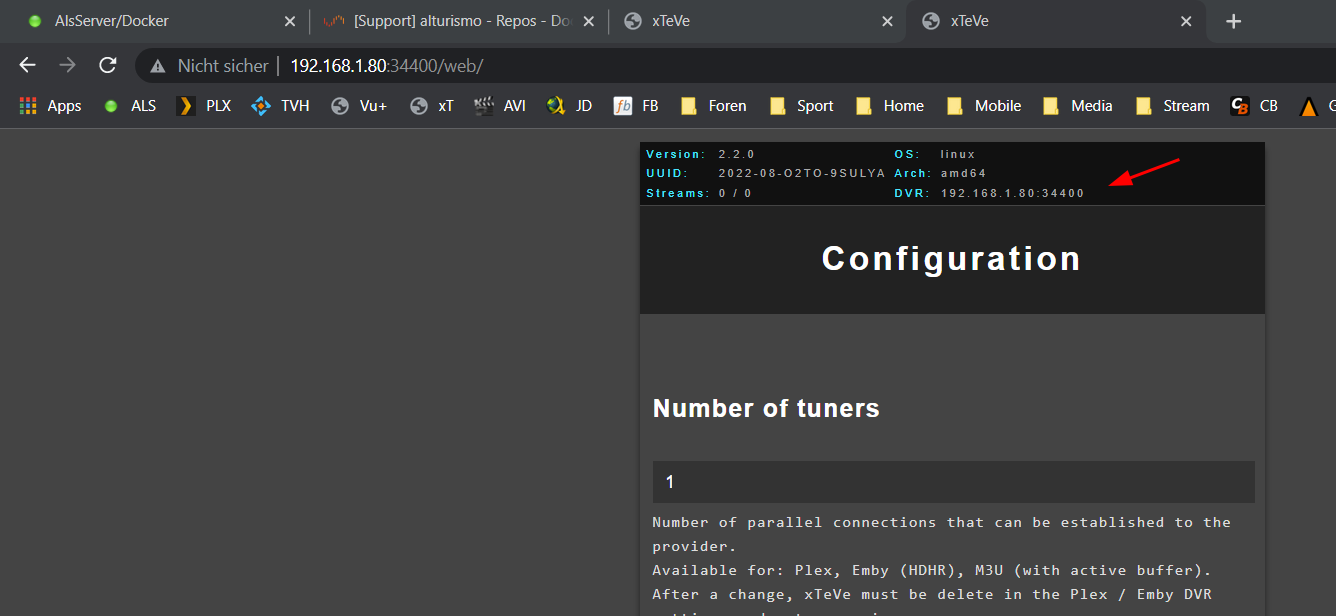

ok, tested here and working fine
as you see it also shows here 34400 on both in dash, while one is running on 34400 and the other on 34401
from the VPN terminal console, you see the 2 listeners ...
here the webgui's
so basically, your setup is looking fine, but somewhere must be something ... i can only confirm this way works as expected.
Delete everything, start from 0.
Doesnt working either.
Open passthroughtVPN, and watch configs, and needed to add new port there. 🤦🏼‍
many thanks @alturismo for make you loose time with this, and for your hard work!

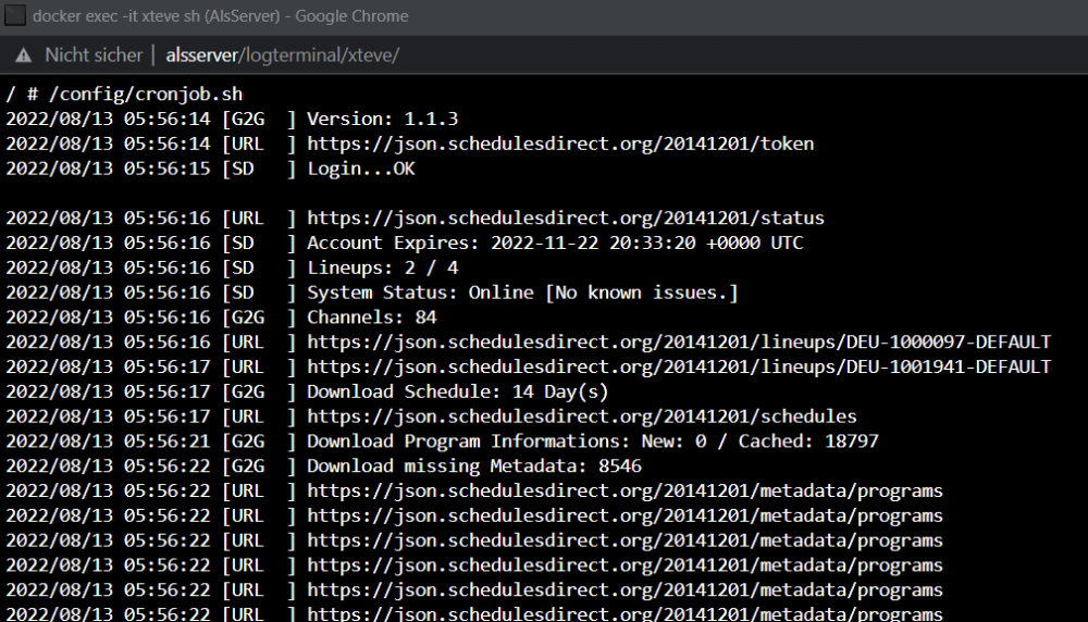

My guide2go docker failed this morning, reporting hundreds of lines of:
[ERROR] Could not find requested programID. [SD API Error Code: 6000] Program ID: EP00003986
Any idea what could cause this?
this is pretty sure not the g2g helpdesk ;) but to give a starter
SD schedules direct ... may just had a hickup, may try to a different time or run it manually in the xteve console
or may this program is just moved, deleted, ... from SD lineup
as test if this is always happening with the same id, may edit your yaml and remove this one channel from your lineup to cross check and see what happens then ...
Thanks for the assistance, just wanted to make sure guide2go itself wasn't causing the issues. I recreated a new yaml with the same info, and it seemed to work so unsure but working now.
Thanks again.

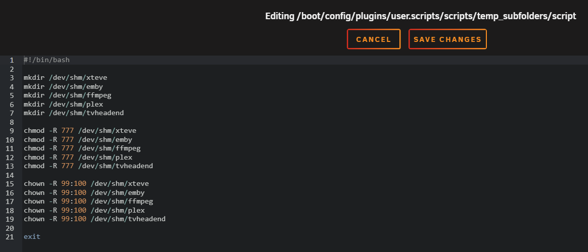

Curious to know if there is a way to have it buffer to the RAM rather than the drive the docker is installed too.

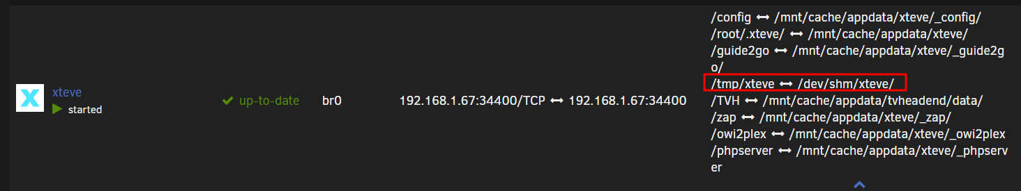

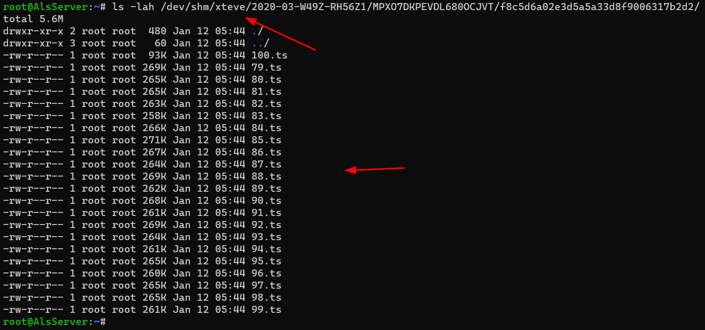

of course, like with any other docker just map /tmp/xteve > to your RAM, there are different opinions howto, i personally use subdirs in /dev/shm/ on the host therefore and map them.
sample on Unraid, user script to create my subdirs, i chown & chmod just to make sure they always work ;)
/dev/shm/ as it results in max 1/2 Ram usage
docker mount
result
there are several tutorials in this forum, mainly when you look for plex transcode to Ram
I see.. Thanks!

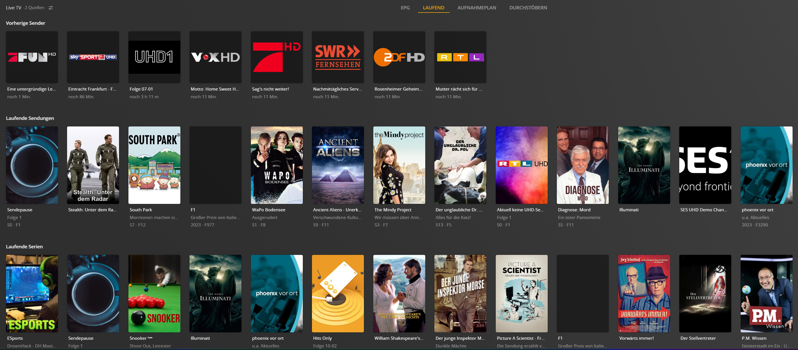

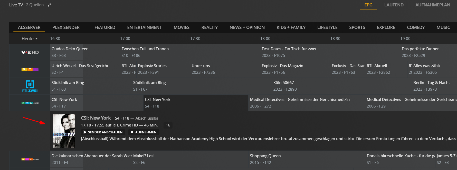

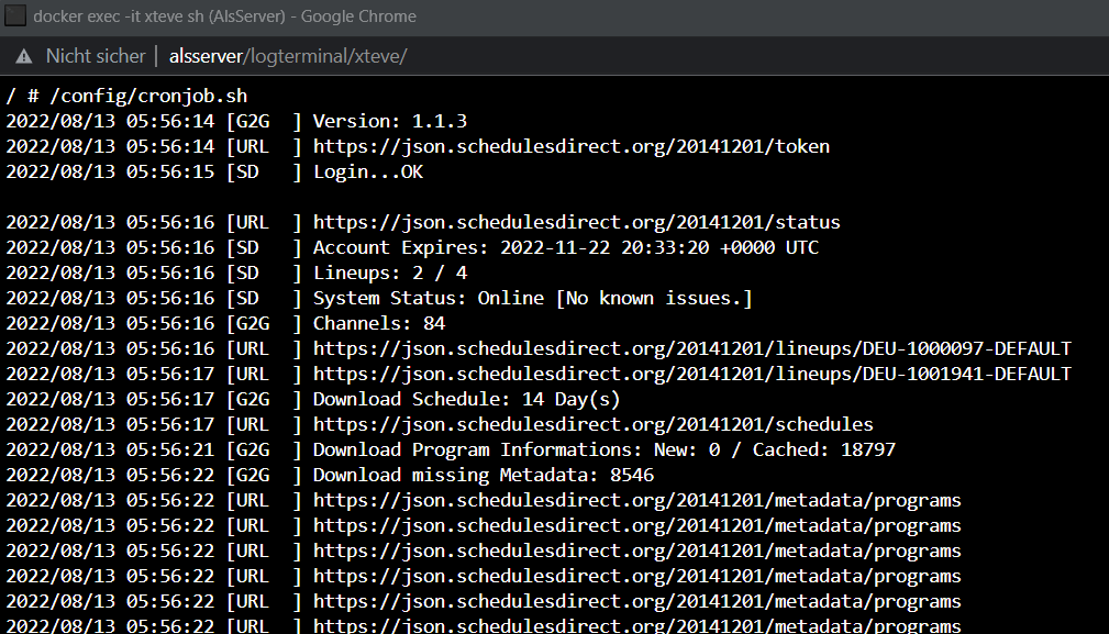

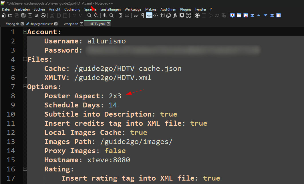

updated g2g Version coming now included for SD users to get program posters back.
need some manual hands'on, rename the cronjob.sh, the docker will generate a new one, redo your settings, either proxy pictures only or cache them locally, to start i would recommend to set 1 Poster size depending on your wish, SD has a 5k daily (24h) limit.
here a sample for Plex users, 2x3
here the final result with posters again (well, almost all ;))

2023/03/26 16:51:47 [SD   ] Login...OK
2023/03/26 16:51:47 [URL  ] https://json.schedulesdirect.org/20141201/status
2023/03/26 16:51:47 [SD   ] Account Expires: 2023-04-02 00:42:37 +0000 UTC
2023/03/26 16:51:47 [SD   ] Lineups: 1 / 4
2023/03/26 16:51:47 [SD   ] System Status: Online [No known issues.]
2023/03/26 16:51:47 [G2G  ] Channels: 0
2023/03/26 16:51:47 [URL  ] https://json.schedulesdirect.org/20141201/lineups/USA-YTBE753-DEFAULT
2023/03/26 16:51:47 [G2G  ] Download Schedule: 7 Day(s)
2023/03/26 16:51:47 [G2G  ] Download Program Informations: New: 0 / Cached: 0
2023/03/26 16:51:47 [G2G  ] Download missing Metadata: 0
2023/03/26 16:51:47 [G2G  ] Create XMLTV File [/guide2go/SATguide.xml]
2023/03/26 16:51:47 [G2G  ] Clean up Cache [/guide2go/SATguide_cache.json]
2023/03/26 16:51:47 [G2G  ] Deleted Program Informations: 0
2023/03/26 16:51:47 [G2G  ] Version: 1.1.3
2023/03/26 16:51:47 [URL  ] https://json.schedulesdirect.org/20141201/token
2023/03/26 16:51:48 [G2G  ] Download Schedule: 14 Day(s)
2023/03/26 16:51:48 [G2G  ] Download Program Informations: New: 0 / Cached: 0
2023/03/26 16:51:48 [G2G  ] Download missing Metadata: 0
2023/03/26 16:51:48 [G2G  ] Create XMLTV File [/guide2go/Echoguide.xml]
2023/03/26 16:51:48 [G2G  ] Clean up Cache [/guide2go/Echoguide_cache.json]
2023/03/26 16:51:48 [G2G  ] Deleted Program Informations: 0
