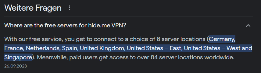

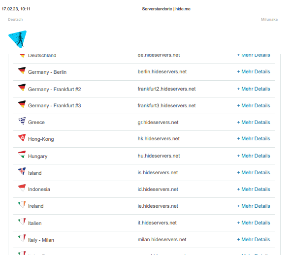

28 minutes ago, Cpt.Hardy said:
what is the correct input for hideme_server if you only have a free-account?
lets see what google says ... ;)
1st hit
actually, just login to your hideme account and you get a list with addresses from there ... sample

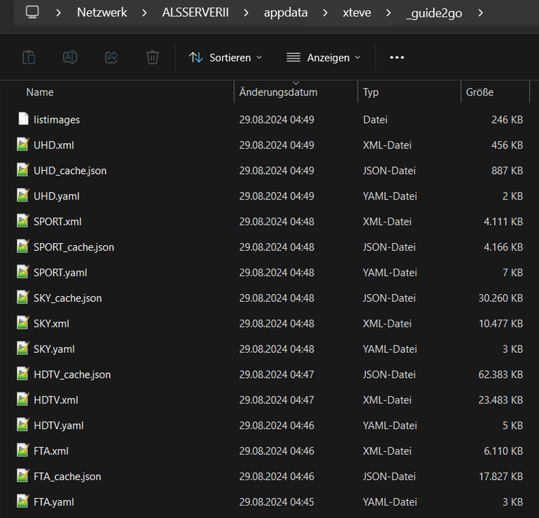

log.txtLooks like my sd grabber using xteve_guide2go stopped working a couple of days ago. Also looks like my notify in user scripts isn't working either, so I didn't know. 😕
I have two lineups, both are running, yaml files haven't changed, and the sd logs look fine - the lineups and ids still match up, and logs say it's retrieving data. But the written xml file only has:
<?xml version="1.0" encoding="UTF-8"?>
<tv guide2go="guide2go" source-info-name="Schedules Direct" source-info-url="http://schedulesdirect.org"></tv>
No channel or program data. Any idea where to look? Anyone else seeing issues?
Thanks!
Edited by Rick Gillyon
at least not here ...
all lineups looking fine here
may start manually in cli and look for errors
docker exec xteve_g2g /config/cronjob.sh
while xteve_g2g corresponding to your docker name

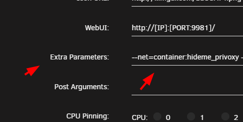

Hi everyone
I  need some help
I use the container: hideme_privoxy via Unraid and add the start parameters for port forwarding in the template.
I also added @pf to the user name and I have a fixed IP via hide.me.
When I start the container, I get the following error message:
"PFwd: Port-Forwarding has not been enabled: port-forwarding failed"
Is port forwarding possible with the container? Do I need anything else?
I only need this for a container that I would like to have behind a VPN.
