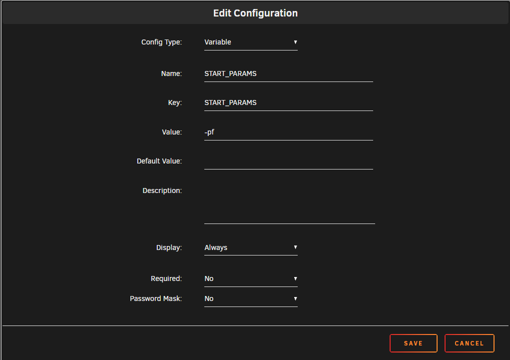

Hi Thanks for your reply
I add this to the containers.
I also tried to change the run file via the CMD. But that has the same effect.
may a source how you came to this ?
my docker does not use this parameter ... and yes, it needs to be builded in
i see the cli client supports it
 -pf
        enable port-forwarding (uPnP and NAT-PMP)
i ll look into it and may add a optional flag, will let you know when done so you can test it.
and ... you are aware about port forwarding and secuty risks ? making your application accessable ... from anywhere.
hi, just checked my docker and i saw where you had this from (was actually mine ;))
but it should work as you setted it ... at leasz here it does
hi, thank you again for your help.
I am aware of the security risks.
I don't run the container continuously. I only run the container for a certain period of time.
I found it on the github page of the cli client.
thank you again for your efforts :)

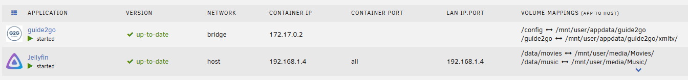

I need some beginner help with setting up guide2go. I'm a newbie with UNRAID but I've managed to get Jellyfin up and going but would like to use the guide2go app to pull in my local TV guide data.
I've used ChatGPT to get to where I'm at now. But I'm not getting the xmltv.xml generated.
The guide2go Docker container started and configured as follows:
/config <--> /mnt/user/appdata/guide2go
/guide2go <--> /mnt/user/appdata/guide2go/xmltv/
I entered into the guide2go Docker console using this:
guide2go -configure us
From there I was able to configure my Schedules Direct Account login, add a lineup and manage channels from the Menu. While still in the guide2go Docker console, I was thinking I could test it by typing 'guide2go'. Entering this shows the Version 1.1.3 but nothing else. Back in the main UNRAID console I go to the /mnt/user/appdata/guide2go/xmltv but there is nothing there.
Could you please assist me with what I'm missing?

Thanks! I'm getting somewhere now. Running the docker exec command allowed me to generate the /guide2go/guide.xml file. There are a lot of gzip: invalid header lines but the guide.xml was generated.
In Jellyfin, how do I use the /guide2go/guide.xml for the XML TV file path? Jellyfin appears to only allow me to see file paths within it's own container. If I enter /guide2go/guide.xml Jellyfin doesn't recognize this path.
Edited by greddin
is the path also mounted in your jellyfin container ?
by design a docker cant access "any" path on your system, may just add your path also in jelly
