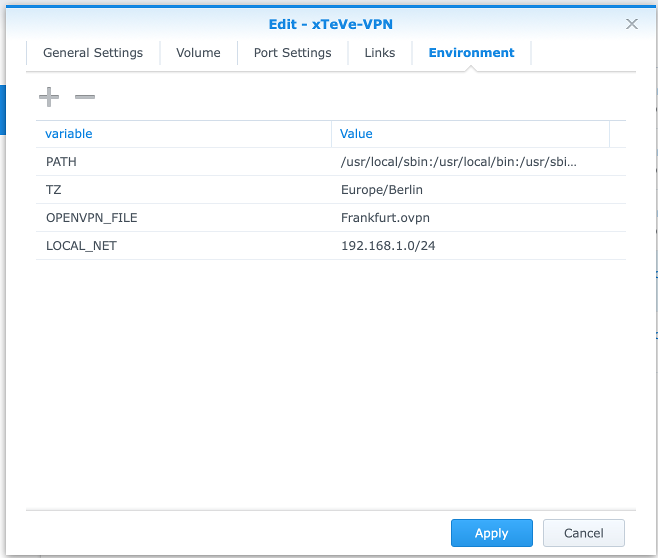

Hey, thanks for the brilliant work. I've run the docker on a synology NAS and it works fantiastically well. The only thing that I cannot figure out (forgive me I'm new to this) is how to enter my PIA VPN credentials so that xteve connects via my VPN. Thanks in advance for any help.
from the docker info readme
may i ask if it worked out ? (upper post)  just so i know if there is a need for modifications ... thanks ahead

Thank you for your help. I've been trying to follow the instructions. but I cannot access the files you've shown above. I downloaded the docker file using the app built into the Synology NAS. The only variable/options it offers are in the screen shot below. I have an OpenVPN file but am unable to access the config folder to place it in there. If anyone has experience in running this on a Synology NAS I'd be grateful for your help.
as this is the unraid forum, please rather join the xteve discord channel and ask there for other OS support, thanks
