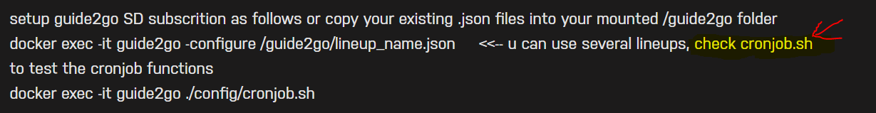

the command(s) to run from the readme
setup guide2go SD subscrition as follows or copy your existing .json files into your mounted /guide2go folder
docker exec -it guide2go -configure /guide2go/lineup_name.json     <<-- u can use several lineups, check cronjob.sh
to test the cronjob functions
docker exec -it guide2go ./config/cronjob.sh

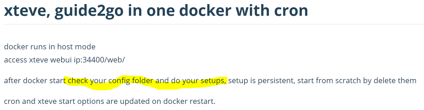

did u took a look in there ?
how is your setup in there, please post your lines which u dont understand
as these are my samples from the config i assume u didnt touched it yet ;)

I really want to use the xteve_guide2go container but I'm completely lost.
I current use plain xteve, so I understand how to use use xteve. Where Im lost is how do I setup the guide2go portion? I don't understand any of the readme. What json file? where does it come from? how does it get there? how do i make sure it stays up do date? how do I run those commands? how do I actually get the info from guide2go into xteve?
It also may not help that I have never really used schedules direct before. I had it back a few years ago when i used nextpvr, and nextpvr just had a login field for schedules direct and it did the rest automatically.
Would anyone mind explaining how to get this going in a more step by step way? I hate being "that guy" but I really just don't get this one, and it doesn't seem to be popular enough for Google to be helpful.
@relink
g morning, this is actually not the forum about the app but may some basics from the readme
https://hub.docker.com/repository/docker/alturismo/xteve_guide2go
Quoted some parts from readme
Container Path: /guide2go <> /mnt/user/appdata/xteve/_guide2go/
here are your guide2go files after setting them up
OR copy ... = if you have a EXISTING .json file from a previous g2g install ... which is created by running the command
docker exec -it "dockername" guide2go -configure /guide2go/"your_epg_name".json
if u didnt changed ...
docker exec -it xteve_g2g guide2go -configure /guide2go/epg.json       <- epg.json could also be USA.json or whatever.
follow the instructions ... setup your lineups etc ... do this for EACH lineup (SD provides you 4) and give EACH a unique name ... see further down.
Container Path: /config <> /mnt/user/appdata/xteve/_config/
after docker start check your config folder and do your setups, setup is persistent, start from scratch by delete them
cron and xteve start options are updated on docker restart.
cronjob.sh  <- THIS IS MAJOR like in xteve ... also extra described in file
sample_cron.txt <- described in file
sample_xteve.txt <- described in file
here u have the general configurations inside like in xteve the cronjob.sh ... for g2g u have to enable AND edit this line
### List of created lineup json files in /guide2go
# sample with 3 jsons lineups
JsonList="HDTV.json SPORT.json UHD.json"
### END Config
jsonlist as described above ... the names u gave YOUR lineups, this is a SAMPLE entry
about cron and xteve start options ... rather leave that alone until you understand the basic
docker exec -it "dockername" ./config/cronjob.sh
docker exec -it xteve_g2g ./config/cronjob.sh
u see the running job(s) you configured there ...
sample_cron.txt from /_config
printf '45 04 * * * /config/cronjob.sh' > /etc/crontabs/root
### remove from here including this line ###
### edit your cron time
### rename to cron.txt
### restart docker, new cron time from then
### no cron.txt it ll update daily at 00:00
last sentence from this file, IF u DONT touch it, it ll update daily at 00:00 ...
about how to run a command like docker exec ... in unraid, open the terminal and run it ... if thats the question.
about how to get xteve reads the guide2go files, they are now in your mounted volume system inside xteve_g2g docker,
so a XMLTV guide path could be /guide2go/USA.xml in xteve ...
now this is all copy/paste from the readme(s), may leave a not where u actually stuck so may someone else can help you further.
If the readme is so unclear or there is a failure please leave a message so i can correct it.
