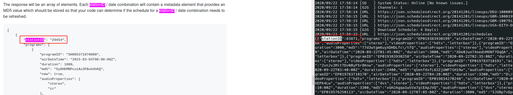

Xteve_guide2go suddenly wont pull in any guide data. I've had this up and running just fine since around February I believe. Nothing in my lineup has changed except I had to remove a lineup that wasn't needed needed anymore.
I checked my schedules direct account first, and its fine. I tried running the cronjob manually, as well as trying to create an XML manually and either way I get the following output:
Configuration [/guide2go/1.yaml]

2020/09/22 09:07:55 [URL  ] https://json.schedulesdirect.org/20141201/status
2020/09/22 09:07:55 [SD   ] Account Expires: 2021-02-23 23:51:01 +0000 UTC
2020/09/22 09:07:55 [SD   ] Lineups: 2 / 4
2020/09/22 09:07:55 [SD   ] System Status: Online [No known issues.]
2020/09/22 09:07:55 [G2G  ] Channels: 70
2020/09/22 09:07:55 [URL  ] https://json.schedulesdirect.org/20141201/lineups/USA-DISH534-DEFAULT
2020/09/22 09:07:56 [URL  ] https://json.schedulesdirect.org/20141201/lineups/USA-FL09649-X
2020/09/22 09:07:56 [G2G  ] Download Schedule: 14 Day(s)
2020/09/22 09:07:56 [URL  ] https://json.schedulesdirect.org/20141201/schedules
2020/09/22 09:07:58 [ERROR] json: cannot unmarshal number into Go struct field SDSchedule.stationID of type string
2020/09/22 09:07:58 [G2G  ] Download Program Informations: New: 0 / Cached: 0
2020/09/22 09:07:58 [G2G  ] Download missing Metadata: 0
2020/09/22 09:07:58 [G2G  ] Create XMLTV File [/guide2go/1.xml]
2020/09/22 09:07:58 [G2G  ] Clean up Cache [/guide2go/1_cache.json]
2020/09/22 09:07:58 [G2G  ] Deleted Program Informations: 0
If I run the cronjob instead its the same output, except for both of my lineups, however it finishes with the line below.
  "status": true
  "status": true
}<html><head><title>Unauthorized</title></head><body><h1>401 Unauthorized</h1></body></html>
Not sure what changed, so im really not sure how to fix this.

Currently SD say they have no problem and the error message:
means nothing to them, not enough to go on. I've sent the full log. FWIW.

So I created a separate guide2go container for testing, if I copy over my json files and run the commands I get the same issue as before, I can see the xml and cache files get created but there's no guide data in them.
However, if I delete my files and try to start over, I notice that a new json file never gets created.
Also that error:
I swear I've seen this error before...I just can remember where. Ive checked my post history, and searched my email and found nothing...but I could wear I've seen that error before...
wip
https://forums.schedulesdirect.org/viewtopic.php?f=15&t=3107
to make it short, lets see what SD will do or say about it.
from the author of g2g
Apparently SD has changed something. The stationID is declared as a string in the SD API (left picture). The server responds with an integer (right picture)
Edited by alturismo
SD is now saying the issue has been resolved, but I am still getting the exact same error.

running g2g here and all is working again, looks like SD fixed it, may some lineups need some more time, just as note, so no update from g2g or docker needed.
yup its all good now. everything seems to be working fine.
