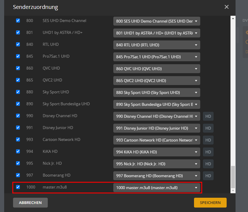

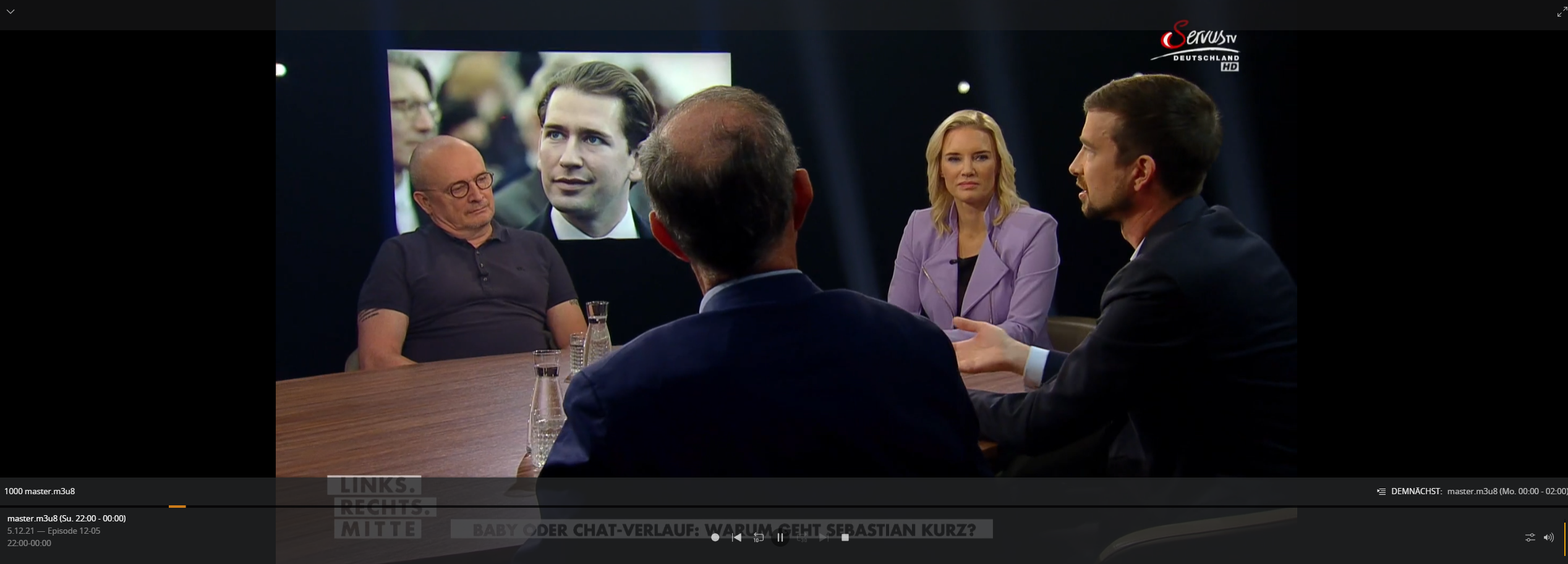

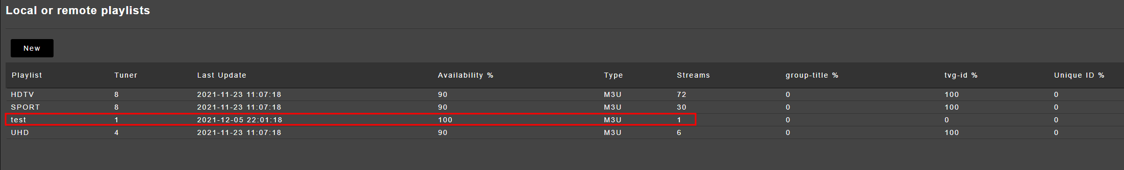

now, if its only this one channel, quick & dirty but working ;)
choose the quality you would like as input, as sample i stripped your file down now to 1080p only (highest quality)
#EXTM3U
#EXTINF:0,master.m3u8
#EXTVLCOPT:network-caching=1000
https://rbmn-live.akamaized.net/hls/live/2002830/geoSTVDEweb/master_6692.m3u8
like this i just drive around the ABR AR i explained above ...
now import this file into xteve
assign a epg in case you use xepg
update plex playlist
enjoy your channel in plex ...
