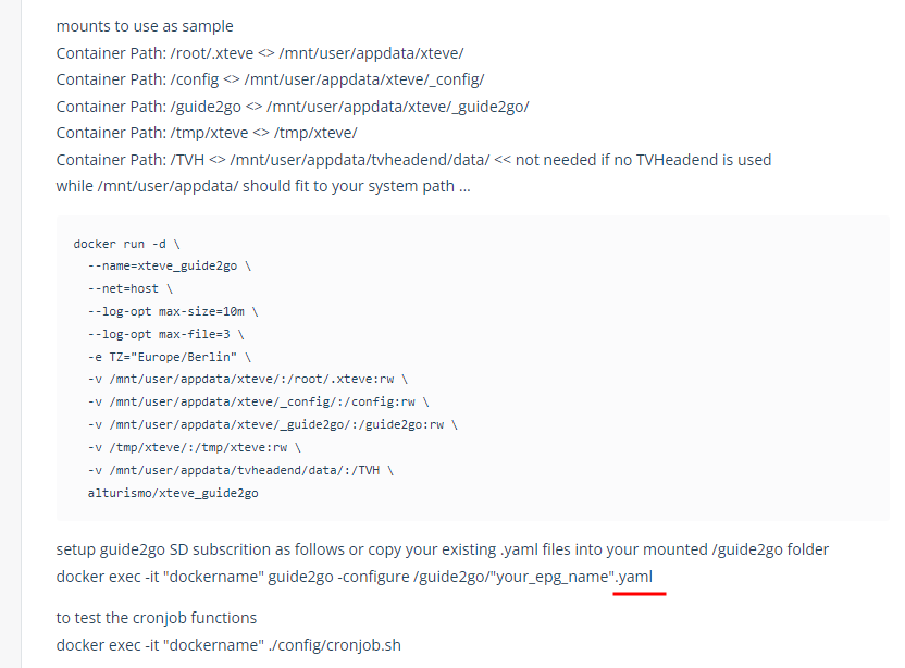

Based on the instructions listed with the container, if I go into the console and type
'guide2go -configure /guide2go/tampa.json' I get an error.
2022/01/31 10:24:55 [ERROR] open /guide2go/tampa.yaml: no such file or directory
Do I need to just create that folder?
the .json part is a little older, seems i have to update the description here too ;) sorry for that

/ # guide2go -configure /guide2go/tampa.yaml
2022/01/31 10:35:33 [G2G  ] Version: 1.1.3
2022/01/31 10:35:33 [ERROR] open /guide2go/tampa.yaml: no such file or directory

do you have any tampa.yaml, tampa.json files in your /guide2go subfolder ?
3 minutes ago, flyize said:
Same error. I'm guessing it doesn't matter, but I'm actually running the command from inside the container.
here a sample ...
Got it! As expected, this was user error. However, I still get a bit of an error at the end of running the cronjob.
