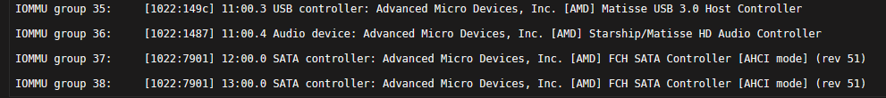

December 17, 20196 yr Hello @Adrian_C , have you have any solution for your problem? I have the same problem, when i add the Starship/Matisse HD Audio Controller and start the VM my Unraid crash. IOMMU: VM sound Settings: Anyone pass through the same problem? Edited December 17, 20196 yr by StaticHub
December 17, 20196 yr 13 hours ago, testdasi said: MSI_util is THE fix for GPU HDMI audio issues. There is no point considering any other faults and fixes until you apply that. So I tried the MSI utility, it did not fix the issue, I turned off the ram XMP profile which also did not fix it. As a last ditch effort I went into the audio properties and changed sampling frequency from DVD (48khz) down to CD (44.1khz), it took ages to apply as throughout the glitching it felt like the audio device was being unresponsive but after it did it seemed to fix the audio issue. Rebooted twice and audio is still working so fingers crossed its permanent. 13 hours ago, StaticHub said: Hello @Adrian_C , have you have any solution for your problem? I have the same problem, when i add the Starship/Matisse HD Audio Controller and start the VM my Unraid crash. IOMMU: VM sound Settings: Anyone pass through the same problem? Same problem with the Matisse HD Audio Controller, I tried to blacklist in syslinux config to ensure host isn't grabbing it but the VM still crashes the host when I try to start it with this device passed through. I might try again later today and post the startup log to see if someone more knowledgable can pinpoint the issue. It's odd as the card is in it's own group on my Motherboard so I'd think that type of device is easier to pass through.

January 23, 20206 yr supersaw thanks for this hint, it really works! I've compiled a new 4.19.94 kernel for Unraid 6.8.1 with this Audio + USB kernel patch: https://www.reddit.com/r/VFIO/comments/eba5mh/workaround_patch_for_passing_through_usb_and/ And now a can pass through onboard USB + audio without crashing Unraid any more.
