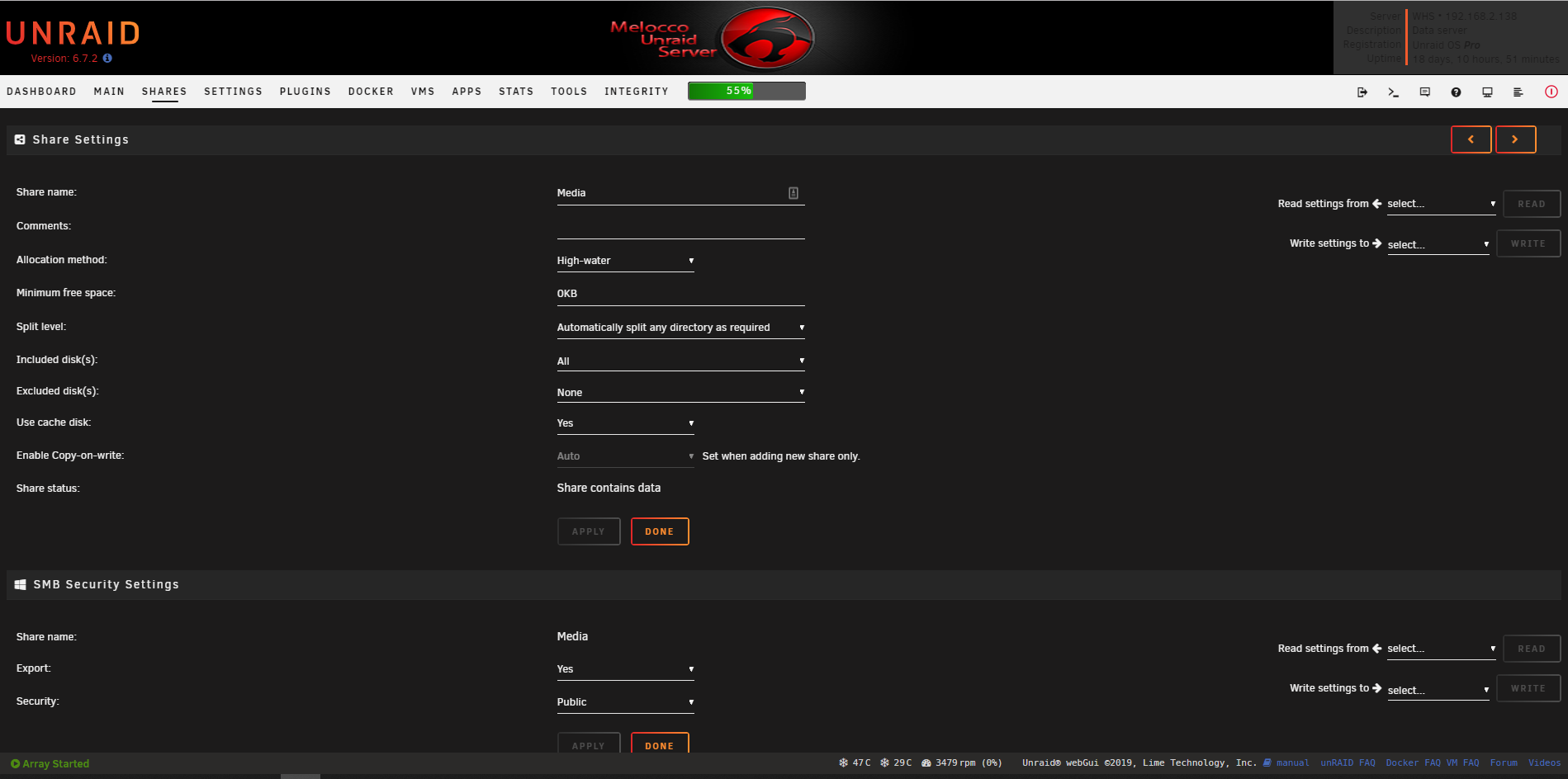

What are the settings on the Shares tab for the Allocation Method and Split Level for the shares that you think have files going to the wrong disk?    These are critical pieces of information as they affect how Unraid selects a drive for new files.
If you are talking about the split level or include or exclude. All the shares are as pictured.
Split Level: Automatically split any directory as required
Include disks: All
Exclude disks: none
I've looked at all the shares..  The main one that seems to be filling up though is this folder: Media.

For argument sake,
Drive 1 & 2 are 4 tb, drives 3 - x are 6 tb
With high water as an allocation method, and split any directory as required,
Drives 3-x will fill up until they all have less than 3tb remaining.   At that point, the highwater is recalculated.
Then, all drives in order (starting with 1)  will fill up until they have 1.5 TB remaining.
Then, all drives will fill up until they have 750 GB remaining and so on.
Ok..  So with highwater, it will fill up until they have 1.5 remaining (last thing), right?
If that's the case. I should change my warning mark to 80% instead of (I think) 70%, that way I won't be getting the warnings and it turning yellow as a warning.
