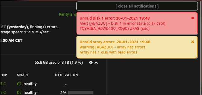

No, i removed it while it was runing ( also to check notifcation ), which i received.

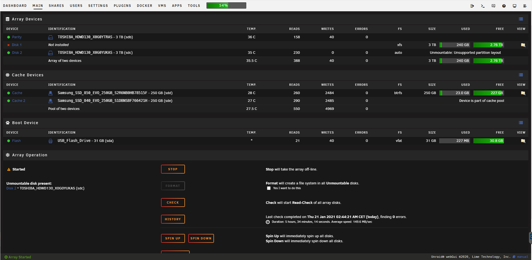

then i just pulled it out, formatted it on another PC, turned off unraid, put the disk back, turned unraid on and the disk was unmountable. tried read check, then i stopped array and put it in as Disk2.
Where exactly was it telling you the disk was unmountable?

This sounds like what I would expect as you made changes to the disk outside Unraid control.   As far as Unraid is concerned you have corrupted the disk which is why it is unmountable.
it was said unmountable under "MAIN" tab.  Just like OP's post.

OK, I think I understand now. The disk was never unassigned, and Unraid tried to use it when you started back up, but you had corrupted it. Formatting the disk on another system resulted in a filesystem on the disk that Unraid wasn't expecting, and, in fact, was probably not a filesystem that Unraid allows for assigned disks.
Now that it isn't assigned anymore, the emulated disk1 is mounting fine.
What you needed to do was assign a different disk as disk1, and then Unraid would have begun rebuilding to that new disk.
Or, you would have had to unassign that original disk1 and start the array without it assigned. Then you could stop the array and reassign it and Unraid would have treated it as a replacement.
In some ways it's a good thing that you had formatted it to an incompatible filesystem. If Unraid had seen that the filesystem was the same as it expected, it would have used it just like that, but it would be an empty disk, and your parity would be invalid.
