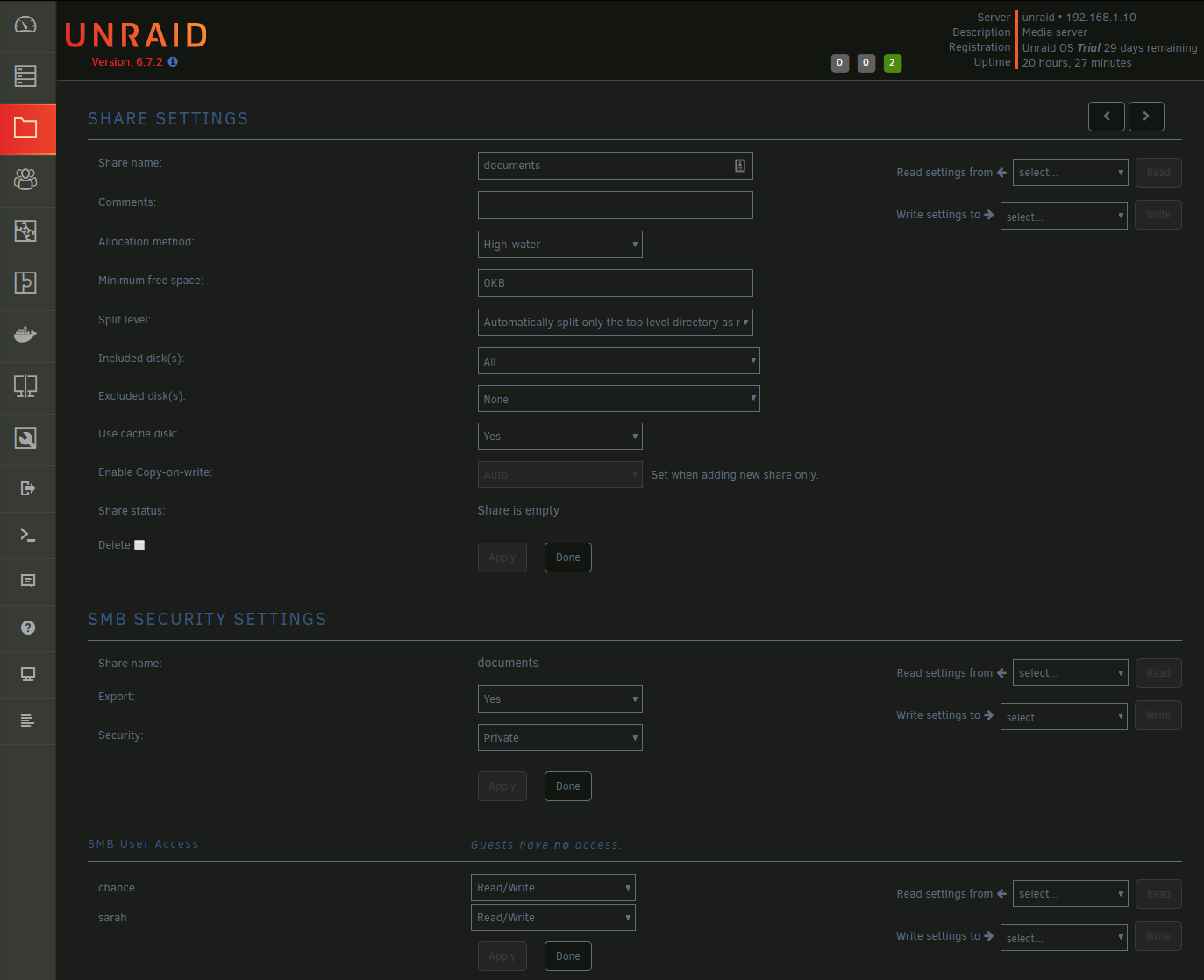

I recently setup an Unraid NAS for testing. It was a super easy setup and the GUI is slick. I am however running into some unexpected behavior. I have set up several shares that I can read from and write to without issues. However, I am NOT prompted for password when accessing my SMB shares. The shares in question have security set to private. What am I missing here?
Server: Unraid Version: 6.7.2
Client: Windows 10 build 17763.615
An example of how I have one of the shares setup:

OK, quick update. Previously I was only testing with PCs in the same work group as the Unraid NAS. Furthermore the usernames and passwords of those Windows 10 PCs matched the usernames and passwords defined in Unraid (I know not best practice, but easy for the family). When testing with another device (my Windows 10 work labtop w/ no workgroup defined & non matching user/pass) I AM prompted for a password. Any idea where the logs pertaining to share access are located? Id like to take a look at exactly what happened with the initial access before I place the NAS into prod and they roll over.
Edited by chancedonmillion
At no point (that I am aware of) did I access a public share on the Unraid NAS from any device in my network. The shares that I created were originally created as private.
Without further research/testing I cant say for sure but it seems like Windows initially will attempt to log into a SMB share using the credentials of the Windows user. In this case my Windows user credentials happened to match my Unraid user credentials so I was never prompted to enter a user or password.
