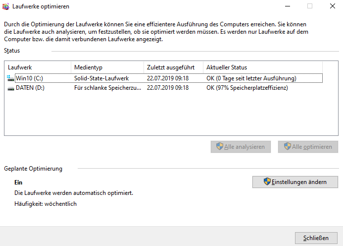

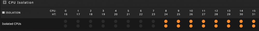

 @thatnovaguy I have a 1950x and have the following cores isolated.
All these cores are used by my main Windows 10 VM for almost 2 years now and I also use a 1080ti and a NVME in this VM. No issues or performance degredations so far. How much RAM do you have and how much is assogned to that VM?
Edit:

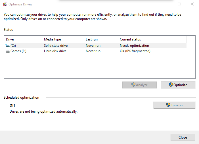

What does the Windows defragmentation tool shows you? And please post your xml of that VM.
Edited by bastl
I disabled the scheduled defrag and optimization per spaceinvaderone's video.

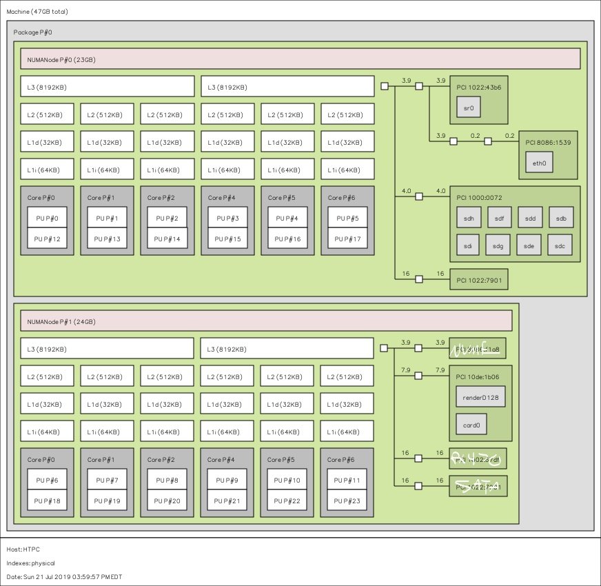

Also, something else that came to mind is that the first 2 cores on the die I'm using are assigned to Plex. Would splitting the die like that give me issue?
My games drive is just sitting on the array but it's more just steam library storage than anything. Since steam introduced the option to move games from place to place whenever I decide to play something else I just move it to my nvme drive. I'm playing ffxiv right now though so I don't play much else.
EDIT: The SCSI setting seemed to help some. I'm still dipping down to the 40s but that's still a gain over the low 20s. The discard='unmap' setting seemed to disable my gpu drivers the first time I booted after adding that. Windows eventually found my nvidia drivers but it took a few minutes.
EDIT2: After adding a couple more cores to my vm I have excellent fps now. I think I was bottlenecked due to background processes eating up my resources.

Using cores from both dies for a single VM might not be the best option. Sure it will work, but if you have heavy latency dependend operations you might be better off by using only cores from 1 die. In my case the first 8 cores Unraid has access to and all the dockers without pinning them down to specific cores. The other half 8 cores are isolated from Unraid for specific use in one VM only. This way none of the background operations on the server touches the cores used by the VM.

Assuming you are running NUMA (and not UMA), you get the NUMA node right but it's better to use 7,19 instead of 9,21. That way you spread your VM core evenly across multiple CCX. Your current config will overload 1 CCX which will degrade performance. From my testing, overloading a CCX can be equivalent with having 1 fewer core (e.g. 3+4 is worse than 3+3 - I'm on 2990WX).
Then add this line in your xml below </cputune>
  <numatune>
    <memory mode='strict' nodeset='1'/>
  </numatune>
That will force your RAM to be allocated to NUMA node 1 for better performance.
  <numatune>
  </numatune>
Next pass through your NVMe as a PCIe device and not through disk device. You will have to go through a few hoops to get a VM booted with NVMe, btw. Using disk device will bottleneck the NVMe drive (overly-simplistically-speaking, it means having to go the long way through core 0 for IO) + no trim support.
Last but not least, restart the VM. I notice this more with i440fx machine type that performance degrades over time until a VM reboot. It's less so with Q35 but is still there.
Sorry for the long delay between replies, life got busy. I've added the bit you suggested into the xml and before that I had added the other 2 cores in the second numa node to my vm totaling 12 logical cores now. It relieved most of the bottleneck but I'm still getting about 20 worse performance than previously. I haven't quite figured out how to boot from nvme in a vm. I tried reading up on it but I'm a bit lost. Would I be better off just converting my nvme to a virtio img to boot off of and then pass through the nvme drive for game/program storage? Here's an updated copy of my vm xml. The only other change I've made is to add a usb 3.0 card.
