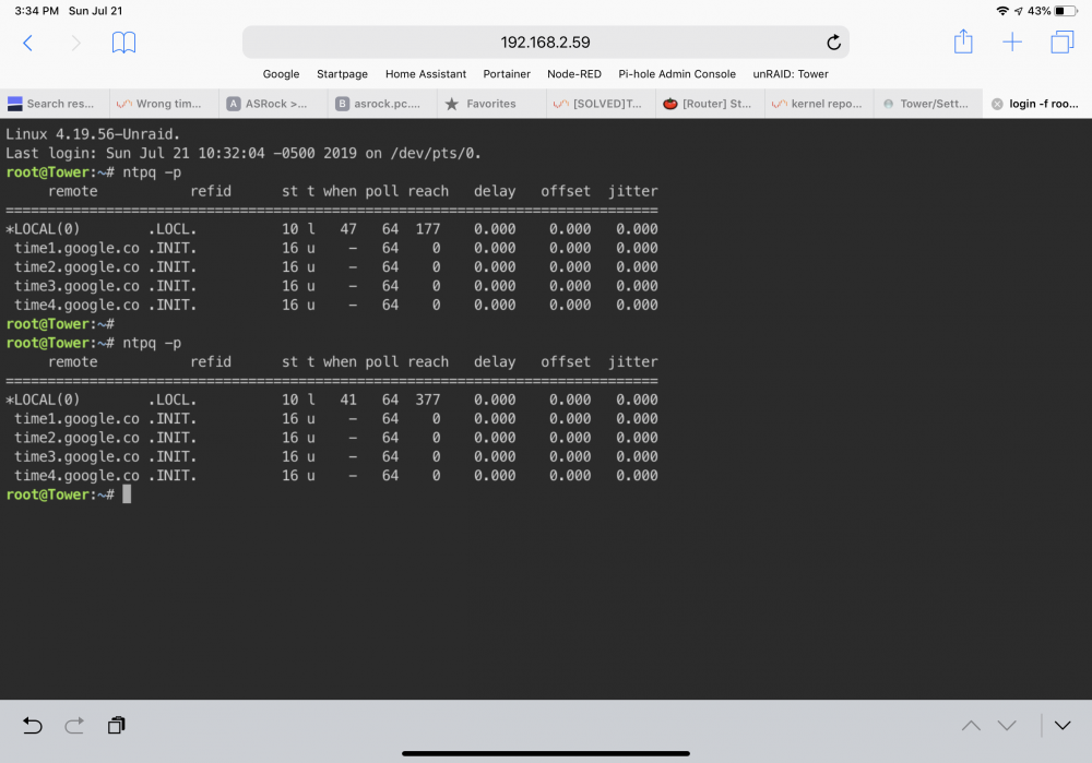

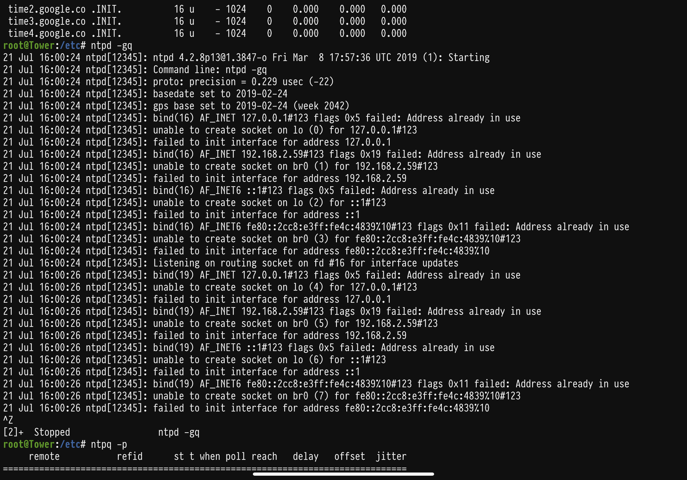

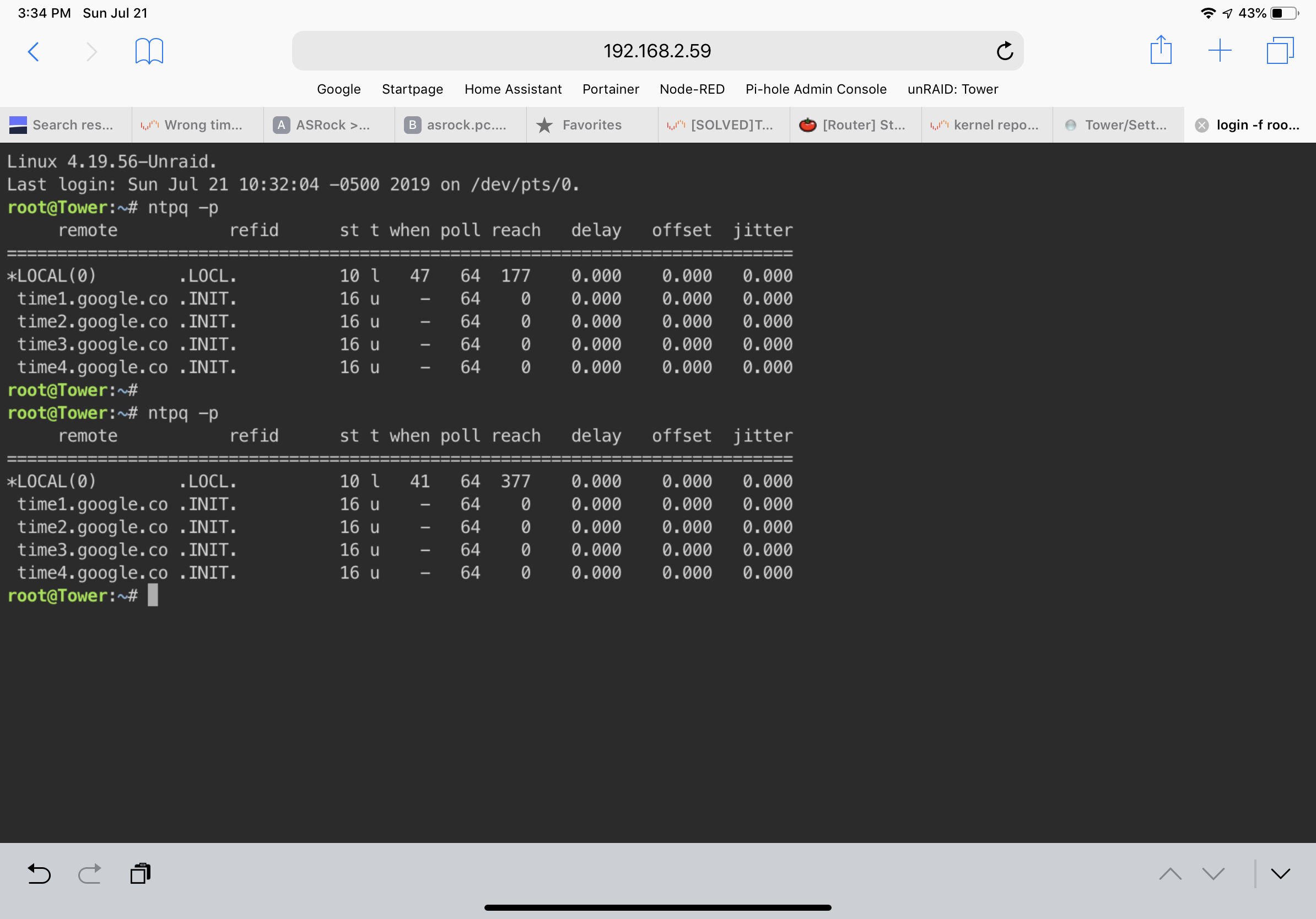

July 22, 20197 yr Trying to sign up for a trial using the webGUI and i can’t as my time zone is not synching. I have already changed my ntp sites from the default ones and that didn’t work. Also I have tried going into the console and typing in ntpq -p and this is what I get. I am so frustrated on this trivial thing that is inhibiting me from getting a trial going. Edited July 22, 20197 yr by Ustrombase

August 3, 20197 yr Are you getting those results from the unraid console, or another machine on your network?
