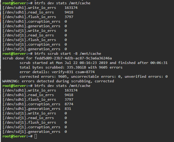

July 22, 20197 yr Got an alert that one of my cache drives was missing, but it showed as an unassigned device. I rebooted server and it's detected as part of cache again but docker service is now failing to start. What's the proper way to solve an issue like this? Is the rest of the data in cache pool likely to be corrupt?

July 22, 20197 yr Author 3 hours ago, johnnie.black said: Docker image is likely corrupt, so likely will any more data using NOCOW shares, rest should be fixable with a scrub, more info here. Scrubbing didn't take long, but now btrfs dev stats /mnt/cache shows corrupt errors now when it didn't before the scrub. Not sure what to make of this.
July 22, 20197 yr Community Expert 2 minutes ago, CorneliousJD said: both were this way by default from what I recall They are. 3 minutes ago, CorneliousJD said: not sure how long to expect it to take Depends on much data and how fast cache is, since you used -B you can check progress with: btrfs scrub status /mnt/cache And you can continue to use the cache normally, with reduced performance
July 22, 20197 yr Community Expert 1 minute ago, CorneliousJD said: but now btrfs dev stats /mnt/cache shows corrupt errors now when it didn't before the scrub That's normal, what's important is that there were no uncorrectable errors, all data on COW shares is now fine and correctly mirrored, any data on NOCOW shares can still be corrupt, like mentioned in the link, no way to check or correct it since it's not checksummed. You should also reset current stats and use a script to monitor for the future.
