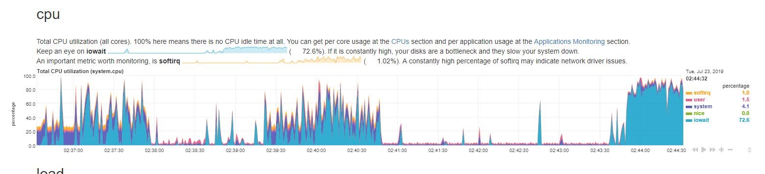

@johnnie.black 😭looks everything is still not ok. now some are transfering at decent speed and some aren't, i mean its so weird that it can open 4k hdr hevc instantly and i can easily skip ahead without any delay but with some other just 1080p h.264 movies i can easily notice couple of second delay. through netdata i noticed that its transfering data at goods speeds iowait isn't all that bad but when its im only getting like 20megabyte/sec io wait goes to 70-80%.

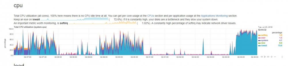

in this screenshot u can see that on right iowait is hovering around 70-90% thats when its transfering at slowly and on the left side iowait is much better thats when im getting goods speeds.
all testing is done after shutting off all the dockers ecept netdata.
unraid-diagnostics-20190722-2129.zip

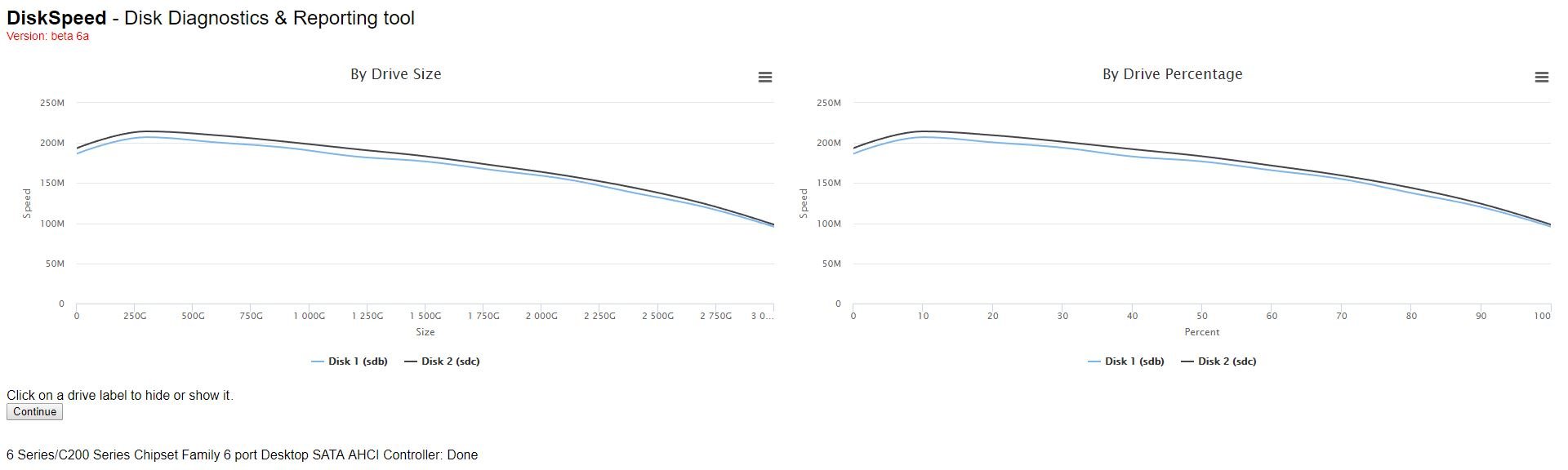

@itimpi @johnnie.black okay these are that results.
graph looks fine to me but im not an expert.

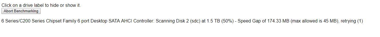

but while the test was running on disk2 is was getting some speedgap error which i didn't get while it was running on disk1. could it bee the problem here ??
Looks fine to me.
3 minutes ago, johnnie.black said:
Looks fine to me.
what about speed gap thing on disk2, is that too is normal ?
Not very normal if nothing else was accessing the disk.
okay just now i tested again by copy pasting some data from disk2 to my main rig's ssd and now this speeds were much better between 80-112 megabytes which is fine i think but that speed gaap ha me worried as no plugin or dockers were ruuning so im pretty sure nothing else was accessing my disk's.
what could caused it, is my disk 2 is dieing or something.

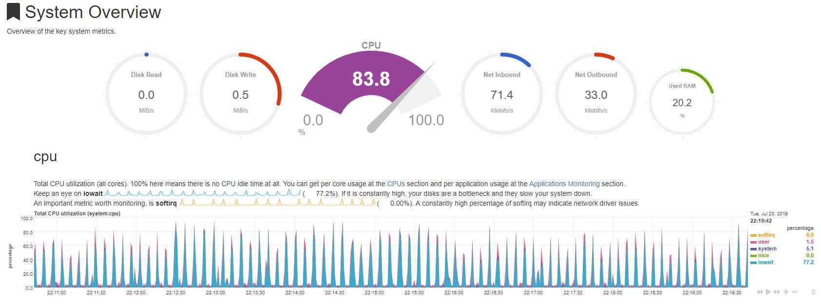

are these iowait spikes normal? i get these iowait spikes after launching plex with just plex running.
