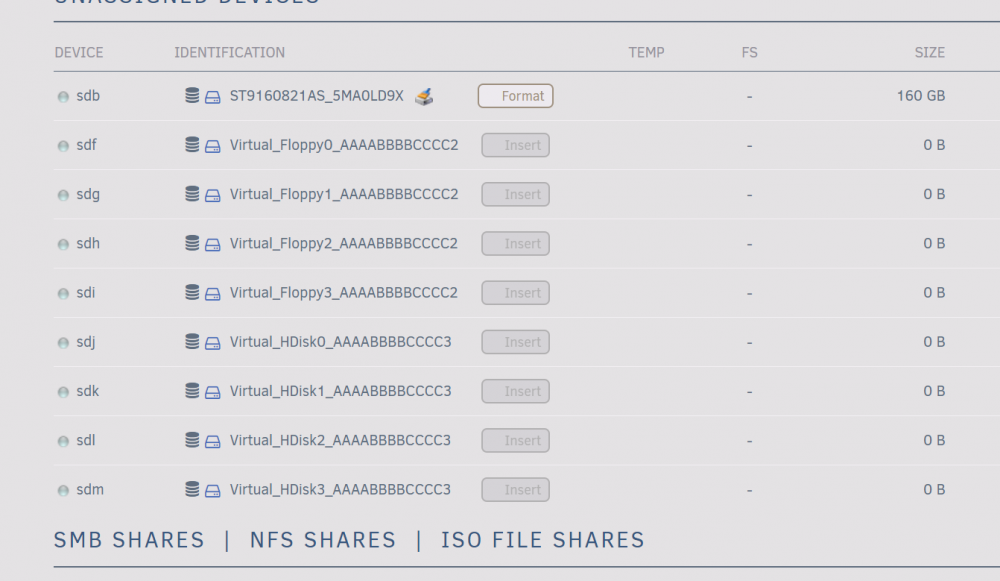

So i had to hard reset the server because he wouldn't neither finish the sync, nor tell me what is going on in any way.
after next boot this appeared out of nowhere. (see image)
So it seems, there is nothing really written to the encrypted drive.
As i said, i had to hard reset the server, as he told me, he was syncing the filesystem. after next boot i accessed the share and it was empty.
i have never seen anything like that before.
