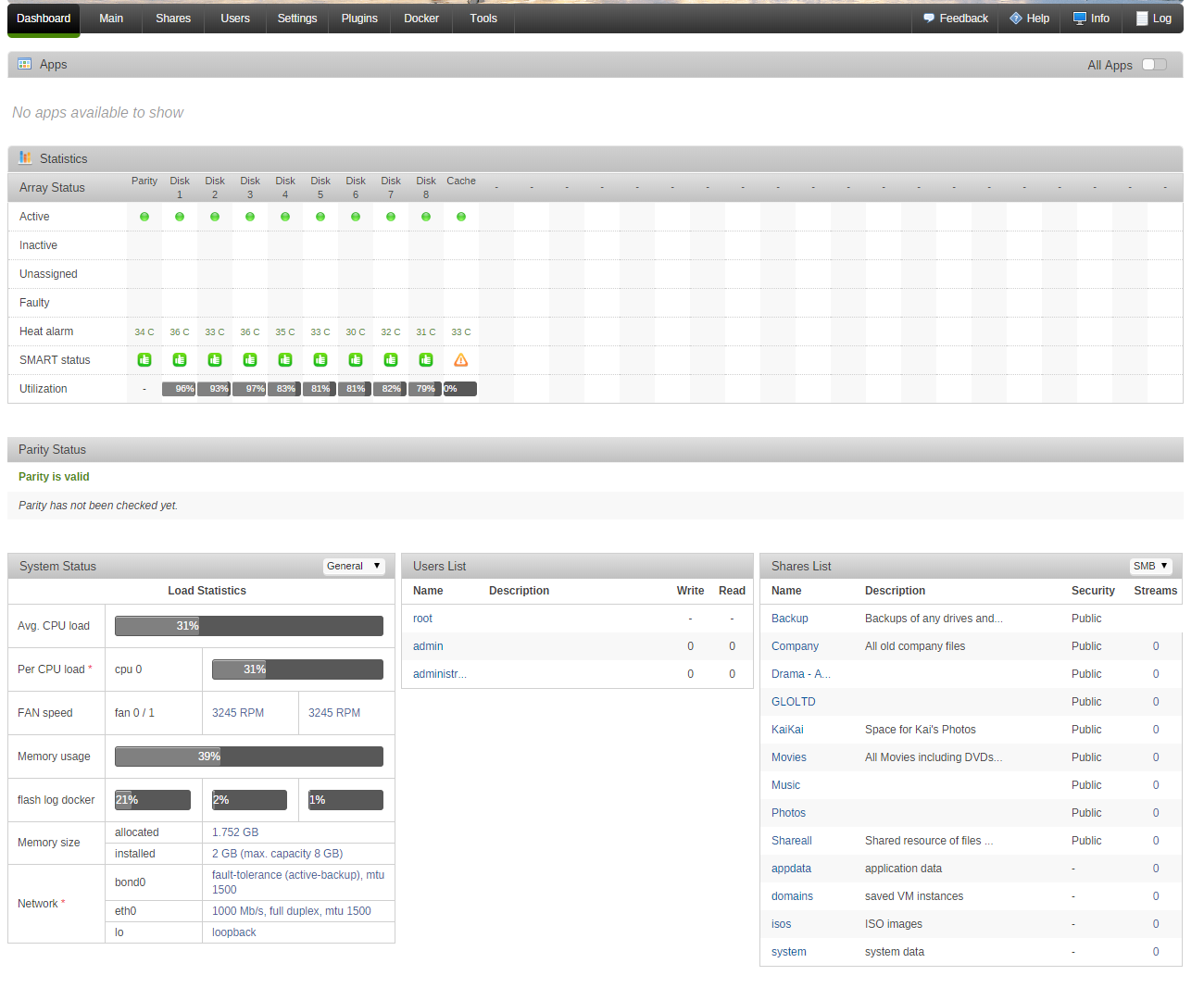

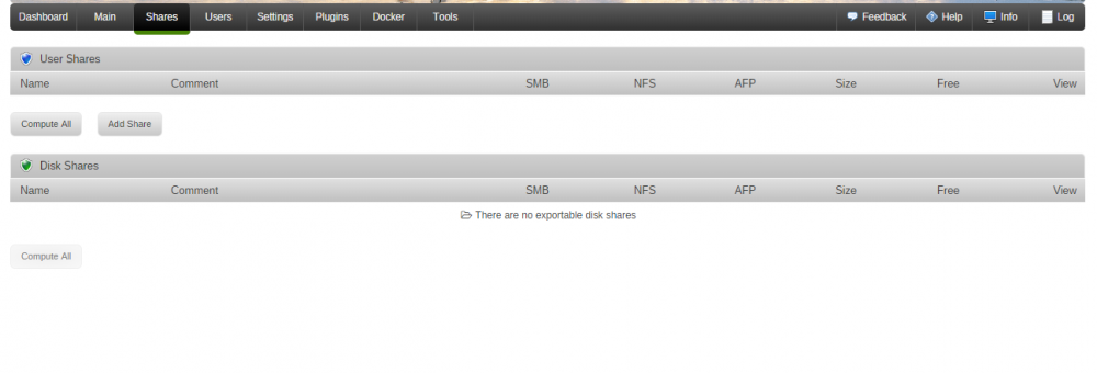

July 22, 20197 yr Hi Folks, Hope you can help. I recently had to change my power supply on my 10 disk Unraid server. So I thought why not get rid of my empty 5 disk hotswap cage as well. There were no disks in it at all and I figured an extra fan would be better. In any case new power supply in and turn it on and it boots fine, but no shares show up. I then go into the web admin and can see none of my disks have been assigned, all forgotten. Fortunately I assign disks in physical order = device order and boot it up. Again nothing shows, so checking further I see that my shares all show up on the "Dashboard", but no shares show up on "Shares" also it seems it has forgotten my network name of "Videoraid" and replaced it with "Tower". Although I still cannot see any information in "Shares" and when I hit "Add Shares" it brings up a blank page it seems to be working. That is, now my network name is correct my computers can see my shares. I know something is wrong still so I reboot thinking it may pick up some config files that were missed with the loss of drive assignment (I'm clutching at straws) but on reboot I see it has reverted back to before, that is all the drives are unassigned! Again, hope you folks can help. Diagnostic files attached. Also screenshot of Dashboard showing shares but screenshot below of Shares showing blank! videoraid-diagnostics-20190722-1433.zip Edited July 22, 20197 yr by scatterbrain add screenshots

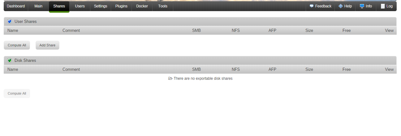

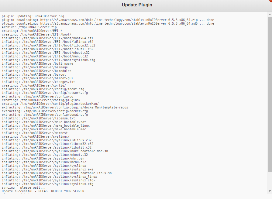

July 23, 20197 yr Author Thanks everyone, honestly awesome to see community support in action! I was unable to copy over everything for subsequently obvious reasons! I did a chkdsk d: /r and it camb back with bad clusters in 5 config files and bzroot-gui. See screenshot: But checking those files and they were filled with binary garbage. So with some trepidation I stuck the drive back in my machine (at least my license file was sound!) and of course the drive assignment was lost again, as was the server name. I then entered those back in and rebooted to see if it was saving the data and it was! Unfortunately I still couldn't configure the shares but thought that might have something to do with the corrupted bzroot-gui file. So I figured I may as well take advantage of the upgrade facility and hopefully that would replace that file..... Nope, it doesnt fix everythign like now server name is also resetting. But at least I can now save my drive assignments! Unfortunately when I try to modify shares etc I get served blank pages, any ideas?tower-diagnostics-20190722-1726.zip It never ends does it?
