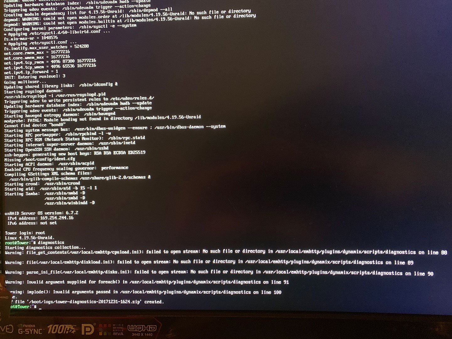

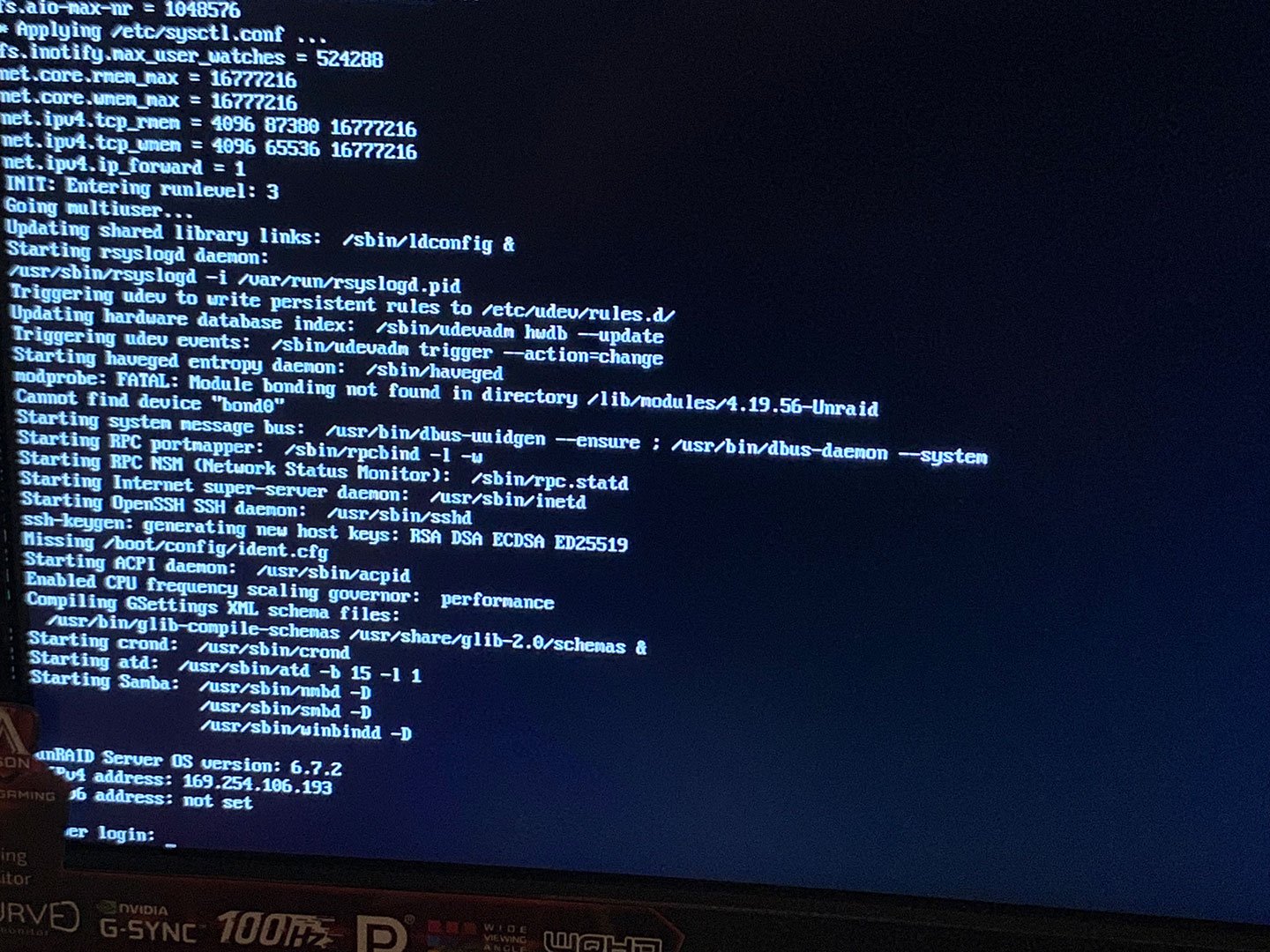

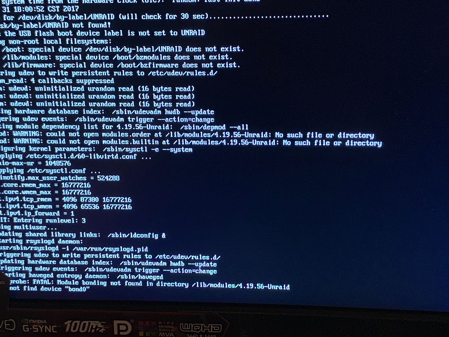

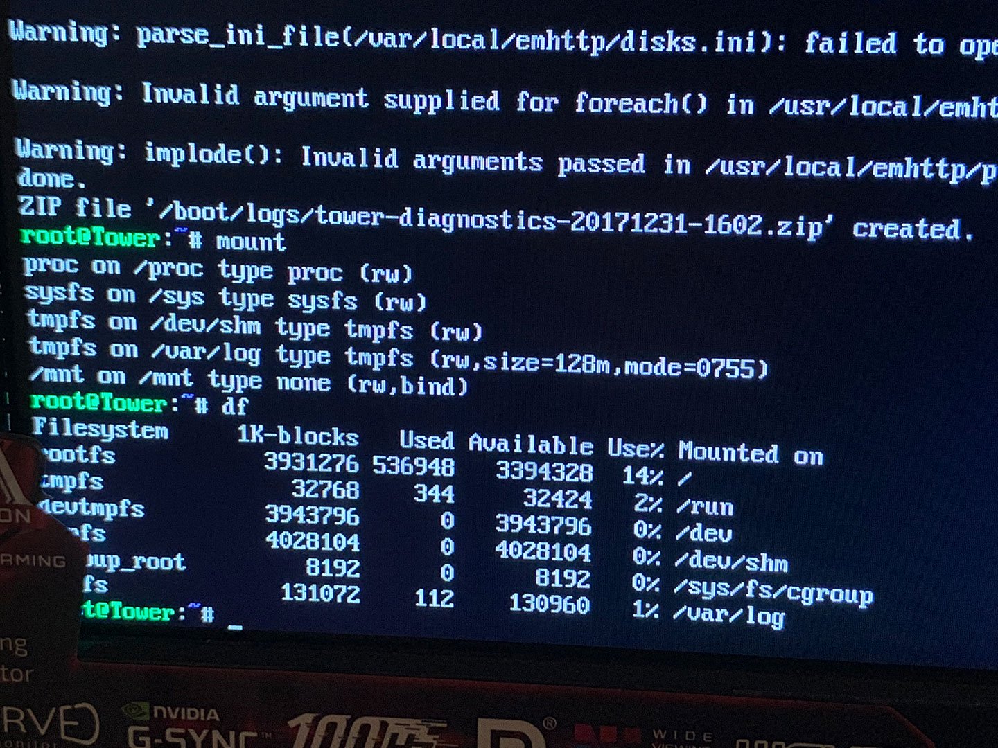

I managed to manually install unRAID on the eMMC as my SD to USB adapter was blacklisted. eMMC was formatted as FAT32, files copied over. Device boots fine. First sign of trouble is that it doesn't get an IP address. Stuck at 169.x.x.x. Second sign something is up is that when I run diagnostics after logging in, I see the file under /boot/logs/ but I do NOT see if when I attach the eMMC back to my PC. So /boot isn't being properly mounted.
I'm guessing I'm going to need some syslinux.cfg wizadry here since /dev/d* is not available whatsoever, nor is /dev/mmc* once booted.

Unless the eMMC presents as a USB flash drive with a valid unique GUID, unraid won't work on it. The symptoms you are seeing seem to point in that direction.
Try using a normal USB flash drive and see if you can get it to work.
Install Unraid on a standard flash drive and try it that way. What you are trying to do with that eMMC isn't working.
