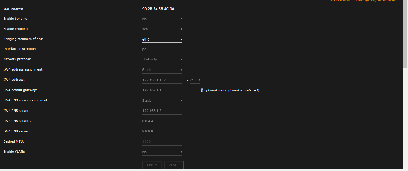

I have eth0 for use with the router and I have eth1 for connect to my computer with nic 10gbps, when I make a static ip in eth0 I lose the connection with unraid, "please wait configuring interfaces" and dont stop, for recovery acces I need delete the files rules and network...
eth0
192.168.1.192/24 <------------> gateway 192.168.1.1

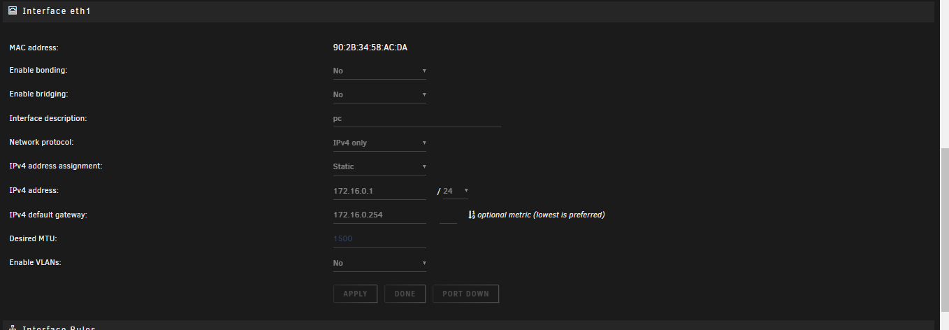

eth1

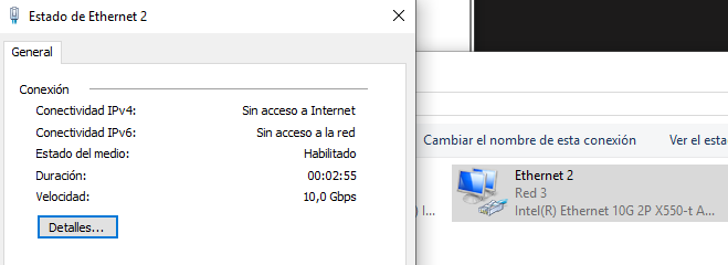

172.16.0.1/24  <-----------> 172.16.0.2/24 No gateway

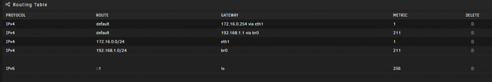

You should check why both have same MAC address and why set eth0 in bridge mode.
And ref. below post
Edited by Benson
Thanks, i fix it, the connections were not in the correct card and when I removed the bound it stopped working...

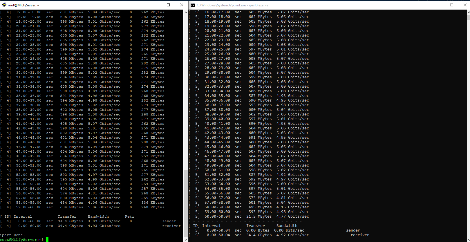

all its working now but when I transfer any file from the nic 10gbs this file move to 200mbps dont understand why that =\
The link is 10 gbps

I test the bandwitch with ipfer and i think is problem from HDD's from the server.
With SSD's in cache in unraid this works better for transfer files from the computer (SSD) to the HDD's server?
Thanks.

Usually yes, that's cache pool aim.
