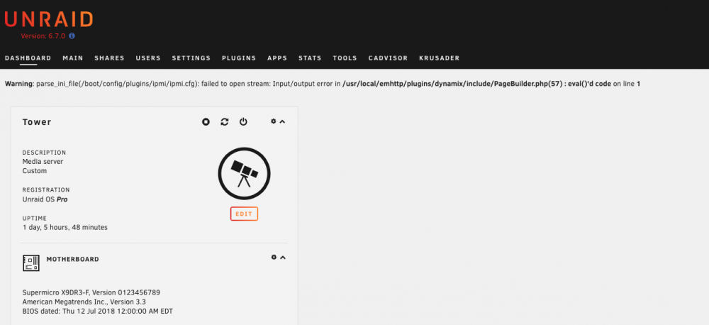

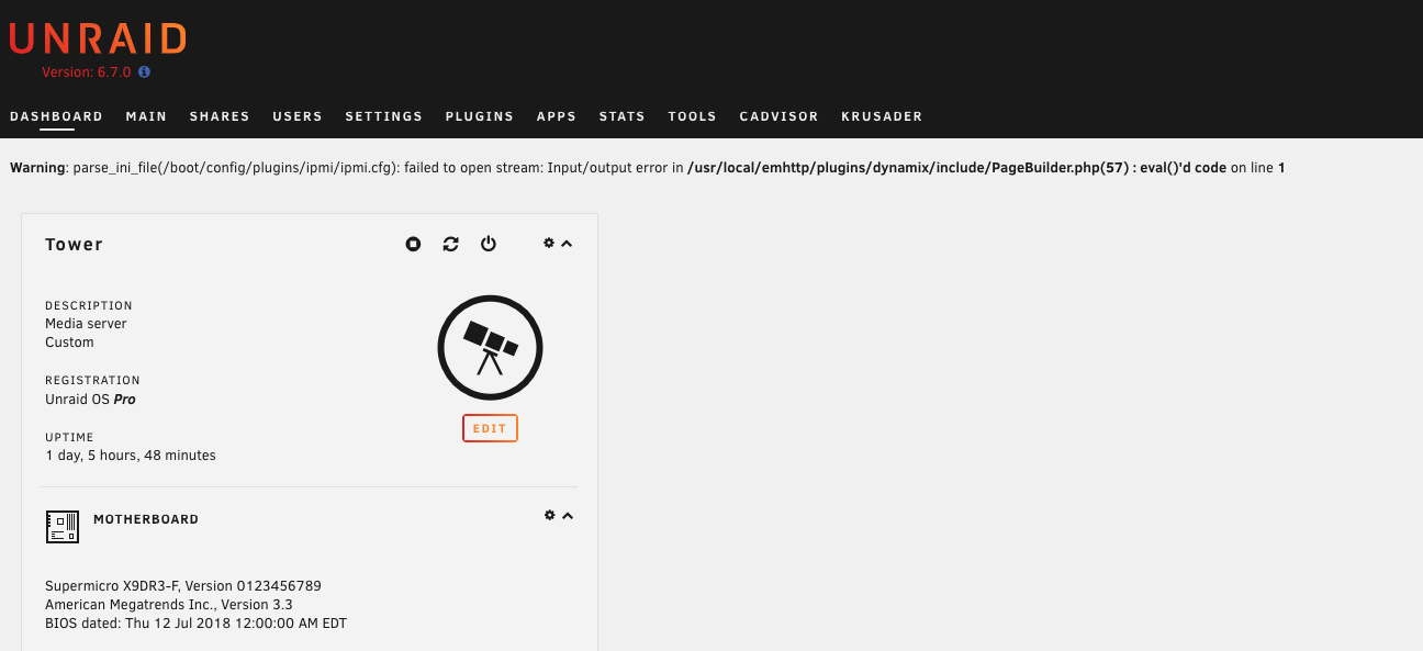

The UI has gone a bit crazy and is showing me this, which is different than the usual dark mode:
701594716_ScreenShot2019-07-25at10_12_51AM.thumb.png.2718534c30b2d0f3a99db3874e4a4934.png
I assume it has to do with this:

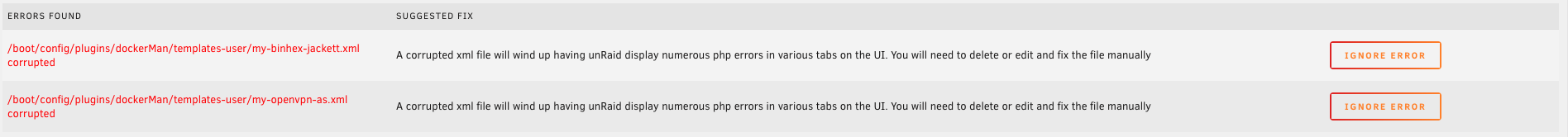

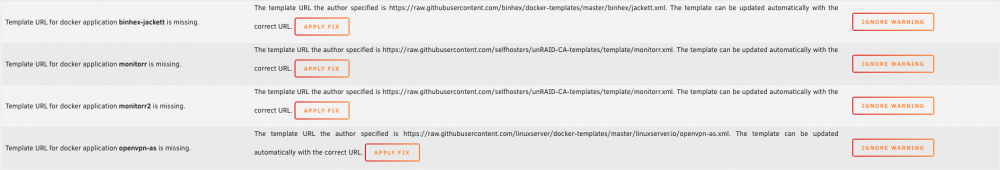

Which is also leading to this?:
1105765548_ScreenShot2019-07-25at10_11_02AM.thumb.png.1f5169343f79e7de6c654a74708671a5.png1668527527_ScreenShot2019-07-25at10_11_17AM.thumb.png.e6316476f85c501d92ab468f25abd92e.png
Also, it says that VM and Docker is down but my containers and VMs are working fine (as far as I can tell).
Just wondering if my fix is to buy a new USB stick or is there something else in the diagnostics file that says otherwise?

It appears you're already using an USB 2.0 port, can still try a different one, if the same happens it's likely the flash drive.
Yes, it's the port on the motherboard. I'll try to put it on an external port and see if that helps.

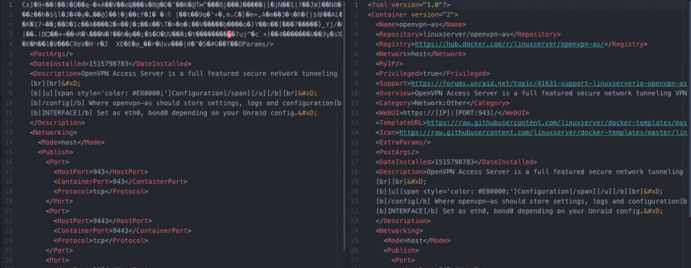

Yup, flash disk is definitely corrupt. Took it out and put it in a separate machine and it gives me errors when trying to copy over certain files.

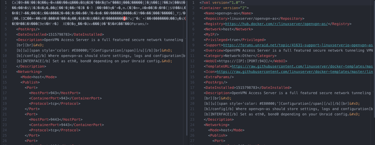

Also checked some of the xml files that the ui complained was corrupted against an older backup and it looks like they are:
1584281916_ScreenShot2019-07-25at11_51_32AM.thumb.png.cfb23b1bf315cea483a4b4f894bc5516.png
I went ahead and made an order for a new flash drive but in the meantime, I plan to format the corrupted one I'm using and try it again until I receive the new one (to keep uptime and to avoid the "changing flash drives too often" UnRAID rule).
Would there be any issue with using a backup from June 28?
Unfortunately, I only backed up the "config" directory.
If no issue with an old backup of only config, am I correct in saying that I only need to re-make the usb, replace the new config directory with my old one, execute the proper "make_bootable" file (mac), then insert and boot?
Thanks again.
