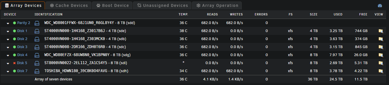

After reboot one disk is - Unmountable: No file system.
I suspect my server cupboard became too hot yesterday as it started behaving badly. It tells me that the newest 8TB disk I put in a few weeks ago is Unmountable: No file system. I could not run any smart disk tests on it so I rebooted the system.
After a reboot I am still missing the disk from my array but I can now run the smart tests on it. Which all seem to be fine.
Is the disk faulty or should I just rebuild the array?
Thanks

Oh Just noticed whilst disk 5 is mounting and no longer giving the unmountable no file system error it does say device is disabled, contents emulated
That explains why running fsck on the device didn't fix it, de disk is being emulated, you didn't mentioned that, now since the disk itself looks fine and if you think the emulated disk is missing data you can instead do a new config to re-enable the disk and then re-sync parity.

I didn't mention it being emulated because it has only just started saying it.... I think.....
I want to make sue I get this right...... Sorry if this is a dumbass question but I am rather worried now about doing the wrong thing. How would I do a new config and re-sync parity?
Thanks for all your help!
-Tools -> New Config -> Retain current configuration: All -> Apply
Check all disks are assigned and start array to begin parity sync.
Note, doing this assumes all disks are OK, if you want to play it safer first rebuild the disabled disk to a new disk, then do a new config with the old one.
