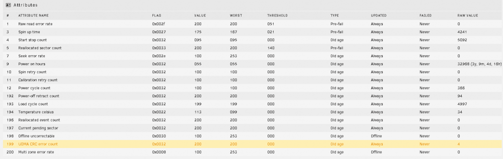

 Unraid has thrown a disk error up for me and i am unsure how to read into it. The sytem seems to be working fine so guess this is a pre warning?
See attached report downloaded from unraid.
it has tuned orange sue to this picture
Any advice welcomed.

CRC errors are a connection problem, 9 times out of 10 a bad SATA cable, note that the number of errors won't reset but as long and it doesn't keep increasing problem is solved.
perfect thanks for that i will keep an eye on it. it was yesterday when the weather was extremely hot here (also got disk temp warning) 46c that disk is connected via a PCI Sata card so could be that getting also. Will keep an eye and if it goes up will disconnect the cable and replace.
