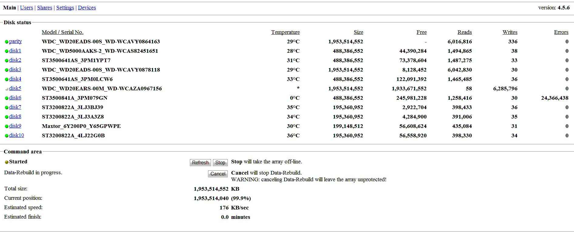

Ok so I had what looked like a drive failure on disk5.
I replaced the old 500gig Disk 5 with a new 2TB disk5 - did rebuild - went to 99.9% stuck.
So I thought - ok maybe the disk is bad.
Installed a NEW 2TB - repeat rebuild - again 99.9% and STUCK!!
2 brand new western digital Green 2TB drives.
Rebuild of 2TB took about 24hrs to get to 99% - then stuck at 99.9% for hours.
See attached image.
The estimated speed was cranking at 3000 or so but after sitting at 99.9% it drops
Any help is appreciated.

AND I see error messages on drive 6
Model / Serial No. Temperature Size Free Reads Writes Errors
parity WDC_WD20EADS-00S_WD-WCAVY0864163 35°C 1,953,514,552 - 1,073,873 64 0
disk1 WDC_WD5000AAKS-2_WD-WCAS82451651 32°C 488,386,552 44,390,284 1,120,078 5 0
disk2 ST3500641AS_3PM1YPT7 35°C 488,386,552 73,378,604 1,123,186 7 0
disk3 WDC_WD20EADS-00S_WD-WCAVY0878118 36°C 1,953,514,552 8,128,452 1,083,450 5 0
disk4 ST3500641AS_3PM0LCW6 36°C 488,386,552 122,091,392 1,090,824 8 0
disk5 WDC_WD20EARS-00M_WD-WCAZA0967156 23°C 1,953,514,552 1,933,671,552 45 1,721,426 0
disk6 ST3500841A_3PM079GN 27°C 488,386,552 245,981,228 955,140 5 29,777
disk7 ST3200822A_3LJ3BJ39 * 195,360,952 2,922,704 394,103 5 0
disk8 ST3200822A_3LJ3A3Z8 * 195,360,952 4,284,900 388,041 5 0
disk9 Maxtor_6Y200P0_Y65GPWPE * 199,148,512 56,608,624 435,458 5 0
disk10 ST3200822A_4LJ22G0B * 195,360,952 56,558,920 393,822 5 0
msgs1.txt

Ok lets say disk 6 is crap - so now I have crapped out disk 5 and disk 6
Max I loose disk 5 (which was not much data - nothing important) and disk 6 which has some stuff I would really like to save.
What are my options?
So this time it has failed at 19% and disk 6 shows more errors than before. This looks like its going from bad to worse.
