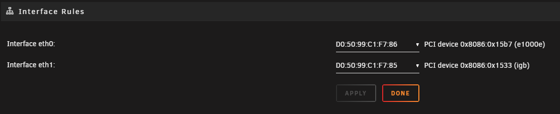

You can map which NIC is eth0, eth1, etc, by MAC address in the Settings --> Network Settings Interface Rules area of the GUI

unRAID probably still expects to find eth0 as the first interface.  Obviously, you can can access the GUI/server via the IP address assigned to eth2, but, if you want it to be eth0 (and get rid of the message), you can assign the MAC address of the Intel card to eth0 in the Interface Rules area and configure the eth0 interface. What shows up there now?
Do you still have an eth0 configured in Network Settings?  To change Interface Settings, the array must be stopped.

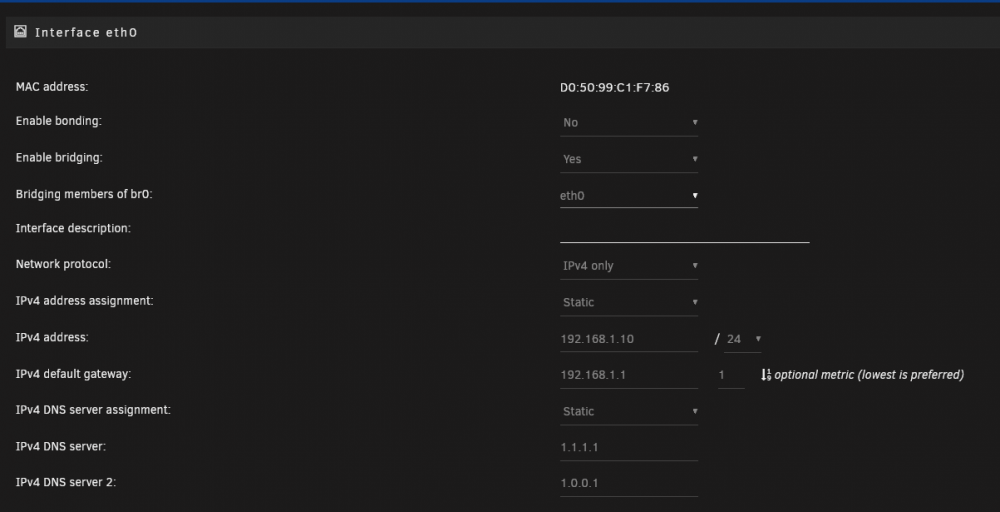

Just tried to change the eth2 to eth0, but even after stopping the array I don't have a section called Interface Rules in Network Settings.
Fix Common Problems is now stating, that my DNS settings are borked (this happened since I disabled the onboard NICs).
What does your 'network.cfg' file look like in the config folder of the unRAID flash drive?  It's just a text file and you can manually edit it if you know what to change.  Your DNS config for unRAID is in that file.
I also have a 'network-rules.cfg' file (stores the ethX interface info) which you probably don't have if that section is not appearing in Network Settings.
Also, if you want to start over on the unRAID networking, you can delete the 'network.cfg' file (make a backup or rename it first just in case) and unRAID will create it with defaults on the next reboot.  Of course the default is DHCP so you get an IP address for unRAID.
