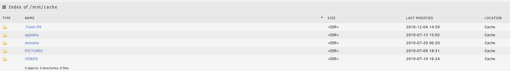

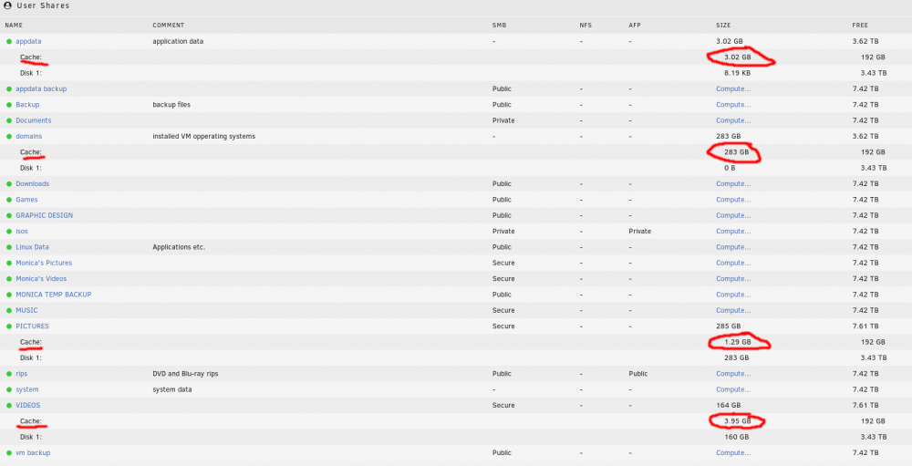

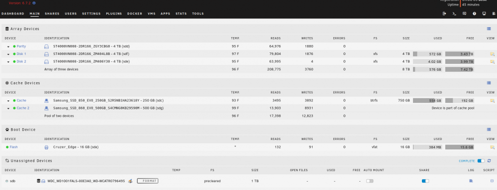

July 27, 20197 yr I'm having a rough time trying to solve my issues which is a two part problem and I desperately need help so I can access my VMs. 1) My VMs are all pausing as soon as they boot to the operating system. Every once in awhile they will load the desktop. VMs are in domains on the cache. According to the main page I've used 558GB out of 750GB. Am I creating instability by using too much disk space? 2) I had previously had my VIDEOS and PICTURES shares selected to "yes" for writing to cache. I then changed them both to "no" thinking that all files would be transferred to the array once the mover started. I guess this is not so. How do I go about moving what's on the cache to the array so I can free up space? I can't seem to locate my cache drive using Krusader. Nothing shows up under the /mnt directory. To add to the confusion, after taking a look at my shares on the cache, they don't add up to 558GB (3.02GB + 283GB + 1.29GB + 3.95GB = 291.26GB). Please help me understand what's going on here. What is the best course of action? Thanks in advanced for the help. Edited July 27, 20197 yr by bubbleman441

July 27, 20197 yr Community Expert 19 minutes ago, bubbleman441 said: I just followed Space Invaders tutorial on making a cache pool.. Can different sized disks in a cache pool create issues? Diagnostics attached. Only when it leads to confusion about usable space as the GUI can be misleading If using the default RAID1 profile then with two disks of unequal size only space equivalent to the smaller drive is available. If you have more than 2 drives in the pool then things get more complicated. There is a web page you can use to see how the number of disks and BTRFS RAID profile affect each other as far as available space is concerned. Another potential source of confusion is that VM vdisks are by default created as 'sparse' files which means they will occupy less physical space on the drive than the initial allocation, but can grow their physical requirements up to that allocated size as they are used.
July 29, 20197 yr Community Expert Like suspect you are out of space, also because of a bug with current release your pool is not redundant, after freeing some space convert metadata to raid1: btrfs balance start -dconvert=raid1 -mconvert=raid1 /mnt/cache Edit: data also needs to be converted since some part is also single profile. Edited July 29, 20197 yr by johnnie.black
