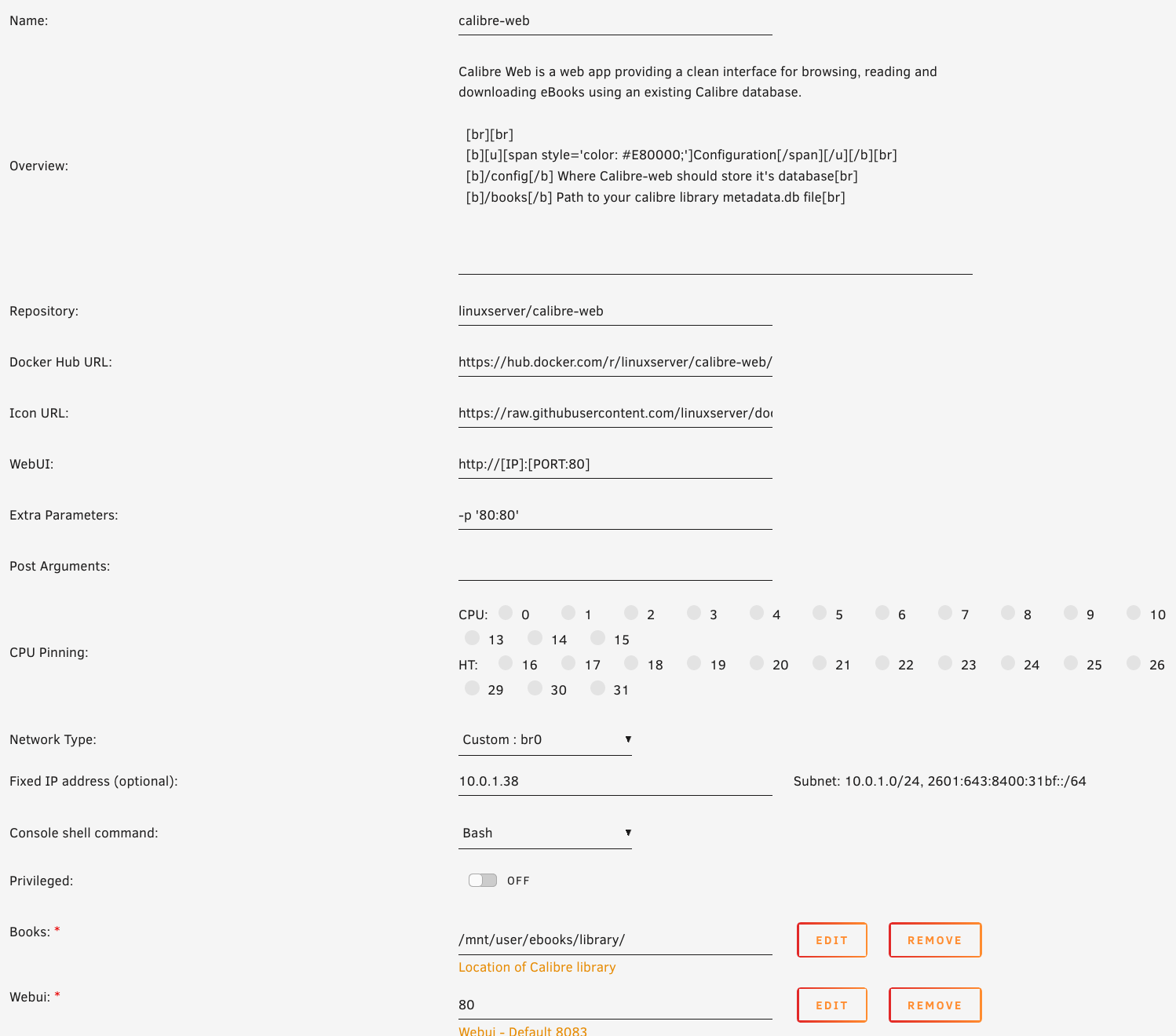

July 28, 20197 yr I am running the linux-server/calibre-web container and want it to run on its own IP address on the default 80 port instead of its standard 8083. I've configured the docker three different ways to use that port as you can see in the attached screenshot. No luck. Any thoughts on what is going wrong here?
July 29, 20197 yr Author Is this just broken? If I give it its own IP address and change the port - it sends different arguments than if I leave it on the bridge and change the port. Why? Change port in Basic Config: Quote root@localhost:# /usr/local/emhttp/plugins/dynamix.docker.manager/scripts/docker run -d --name='calibre-web' --net='br0' --ip='10.0.1.38' --log-opt max-size='50m' --log-opt max-file='1' -e TZ="America/Los_Angeles" -e HOST_OS="Unraid" -e 'TCP_PORT_8083'='80' -e 'DOCKER_MODS'='linuxserver/calibre-web:calibre' -e 'PUID'='99' -e 'PGID'='100' -v '/mnt/user/ebooks/library/':'/books':'rw' -v '/mnt/user/appdata/calibre-web':'/config':'rw' 'linuxserver/calibre-web' d506648f955d20519798e69ea9076397970d91a7cf3f439f7707f47c312ed8ec This command doesn't do anything to the port at all. The container still runs at 8083. Versus bridge: Quote root@localhost:# /usr/local/emhttp/plugins/dynamix.docker.manager/scripts/docker run -d --name='calibre-web' --net='bridge' --log-opt max-size='50m' --log-opt max-file='1' -e TZ="America/Los_Angeles" -e HOST_OS="Unraid" -e 'DOCKER_MODS'='linuxserver/calibre-web:calibre' -e 'PUID'='99' -e 'PGID'='100' -p '8088:8083/tcp' -v '/mnt/user/ebooks/library/':'/books':'rw' -v '/mnt/user/appdata/calibre-web':'/config':'rw' 'linuxserver/calibre-web' fb7bb7671040ca73303db023f229d2574ddf159c17e36c1f9190baeef062954a This one works to change the port. But can't be used in combination with an assigned IP.

July 29, 20197 yr When you assign a unique IP to a container, it negates any mappings set, and forces the app to manage all the ports. If you wish to change the listening port you will need to do that in the application itself, however that particular app does it. The unraid interface no longer has any control over what ports the app uses.
July 29, 20197 yr Author OK. I can try that again, but when I change the port on the app, it just becomes inaccessible. I will give it another go.
July 29, 20197 yr Author Okay - so narrowed it down. I switched the application port to 8081 to try a different one. Worked fine if I changed the advanced setting to [IP]:[PORT:8081]. I tried port 80. Didn't work. Console shows: [2019-07-29 16:29:08,995] INFO in web: Starting Calibre Web... [2019-07-29 16:29:09,377] INFO in server: Starting Gevent server [2019-07-29 16:29:09,378] INFO in server: Unable to listen on '', trying on IPv4 only... [2019-07-29 16:29:09,379] INFO in server: Error starting server: Permission denied: ('0.0.0.0', 80) Error starting server: Permission denied: ('0.0.0.0', 80) So it doesn't like 80 for some reason, but has no problem with other ports. Since the application has its own IP address, not sure what the next step is.
July 30, 20197 yr 9 hours ago, tknx said: Is this just broken? If I give it its own IP address and change the port - it sends different arguments than if I leave it on the bridge and change the port. Why? When giving a container its own IP address, all port mapping is ignored and whatever the app itself wants to use it uses. Basically the same thing as host network. IE: Port mapping only works in Bridge mode. To get it to use 80 instead of 8083, you have to modify file(s) within the container. Edited July 30, 20197 yr by Squid
July 30, 20197 yr Community Expert 40 minutes ago, Squid said: When giving a container its own IP address, all port mapping is ignored and whatever the app itself wants to use it uses. Basically the same thing as host network. IE: Port mapping only works in Bridge mode. To get it to use 80 instead of 8083, you have to modify file(s) within the container. Won't OP hit the problem of trying to open privileged ports with a non-privileged user (non-root)?
