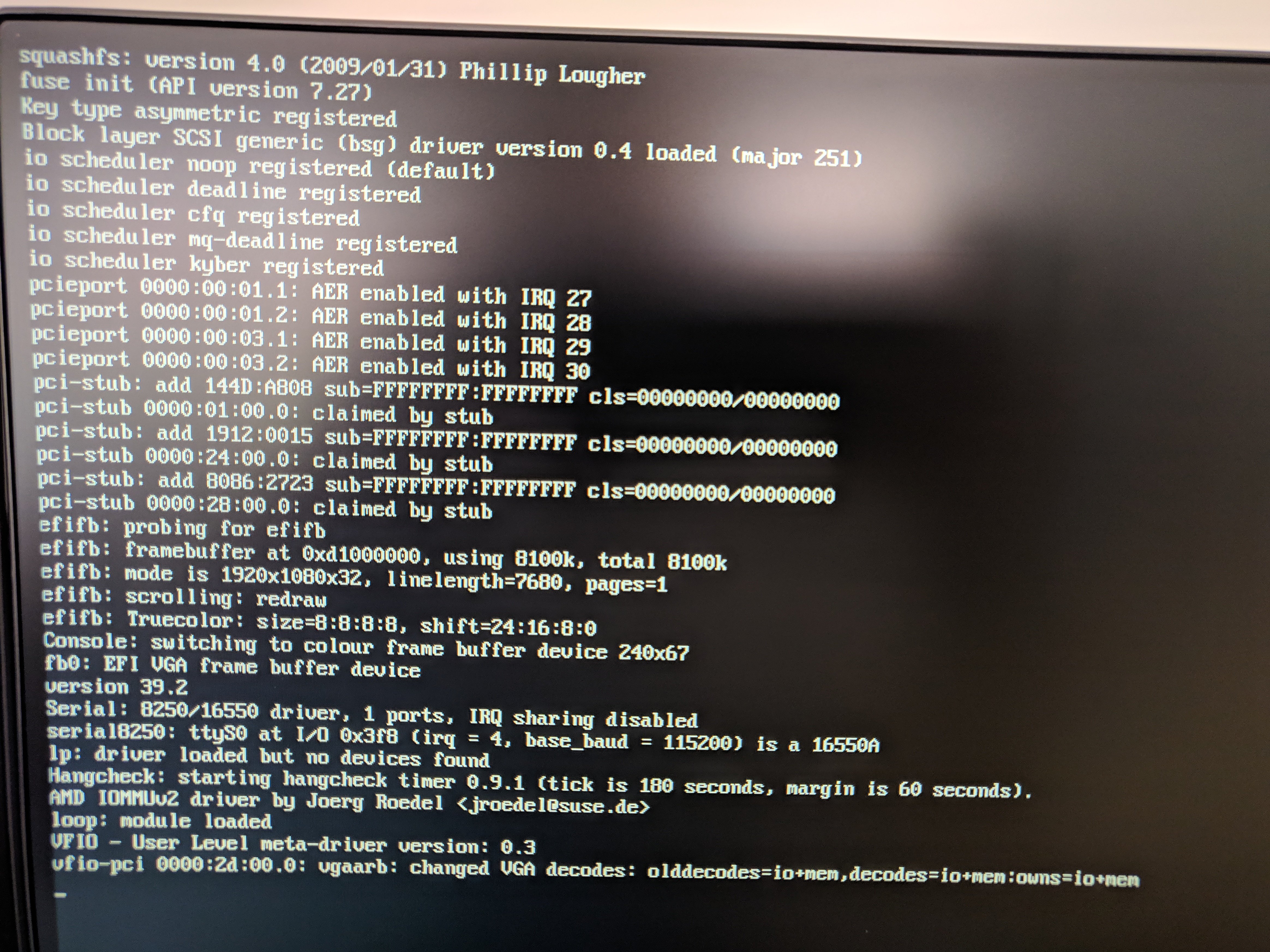

As an update, using the following hardware:
MSI MEG X570 ACE
Ryzen 3800X
MSI Gaming X Trio RTX 2080 SUPER (PCI Slot 1)
ASUS Strix GTX 970 (PCI Slot 2)
Steps so far:
  1. Using Dumped vBIOS from techpowerup
  2. Modified the vBIOS per Space Invader One's tutorials:
  3. Assigned the card, audio device and usb elements of the GPU using both the stub-pci.ids and vfiopci.ids methods
  4. Added <ioapic driver='kvm'/> to the VM XML per the bug noted here: https://bugs.launchpad.net/qemu/+bug/1826422 found when using vfio-pci.ids (which results in the host hanging:IMG_20190801_150357.thumb.jpg.16c3fb5eb22340529905e32db1e62ae9.jpg
  5. Tried both the Q35 and i440fx chipsets (the latest of and a couple prior versions for each)
  6. PCIe ACS override set to Both
  7. VFIO allow unsafe interrupts is Enabled
  8. Finally updated to Unraid 6.7.3-rc2
If in the second pci slot there's no problem, with a GTX 970 in the primary. But i want to run the Ssuper at full x16 speed.
With the config and steps listed I get a screen output at 800x600 (only when using the modified vBIOS) and i am unable to install the drivers in Windows 10 (Also booted outside of Unraid and pre-installed the drivers, but they take no effect in the VM)
I am also getting the following in the VM log:
2019-08-01T17:40:48.826299Z qemu-system-x86_64: -device vfio-pci,host=2d:00.0,id=hostdev0,bus=pci.4,addr=0x0: Failed to mmap 0000:2d:00.0 BAR 3. Performance may be slow
and:
2019-08-01T17:41:02.439023Z qemu-system-x86_64: vfio_region_write(0000:2d:00.0:region3+0x142a0, 0x47ad010d,8) failed: Device or resource busy
Also FYI I am booting the VM directly from the NVMe drive, with no vdisks.

I've had another crack at it and sorted! It was because I was booting Unraid in UEFI mode, switched to legacy and it's all good. When installing initially it just made sense to check the UEFI box because I'm running modern hardware. Only when I found a post somewhere about booting with UEFI causing issues that I tried it. There should be a big warning on that checkbox :P
