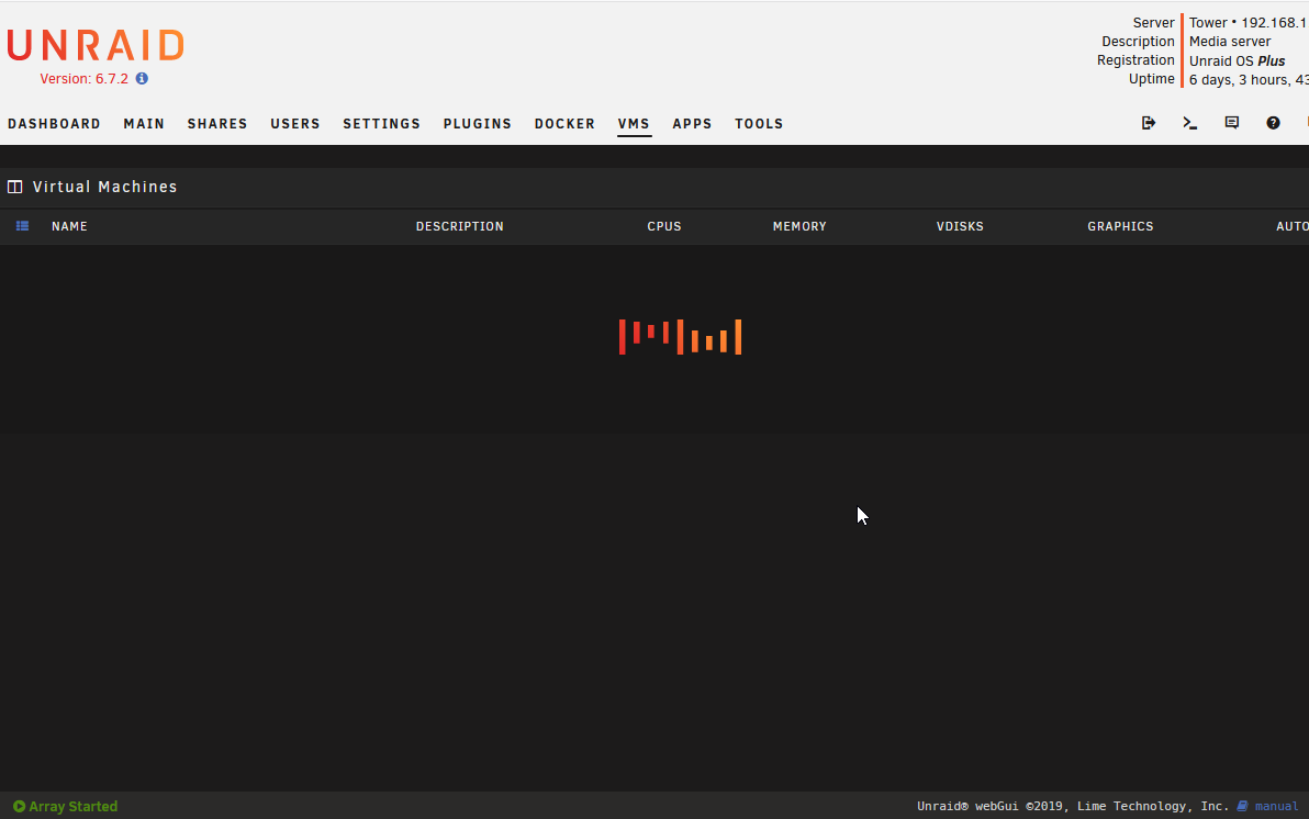

Don't see any errors related to VM service, what exactly is the problem, is the VM page blank?
When I go to the VM tab it just loads forever until it gives up. This occurs from any computer/browser and I have tried using 3 different computers each with Edge/Chrome/Firefox and it just sits there with the animation of loading.
See Screenshot this is after click VM tab and waiting about 2 minutes.
Not much comfort, but FYI that most things in unRaid if it takes longer than 2 minutes exactly will never finish.  On way out of house, so can't really look at the diags though.
