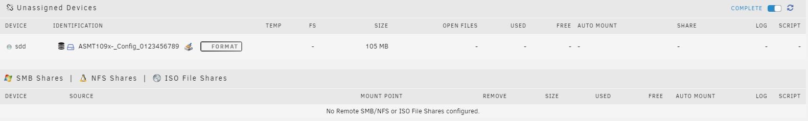

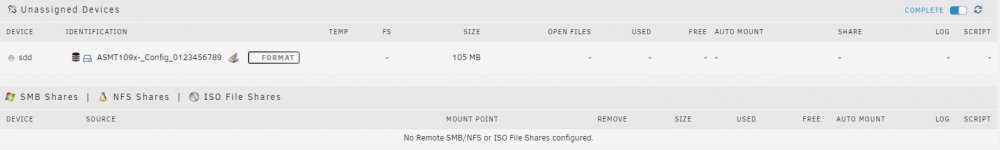

I have 3 drives currently in the test server. 2) 8TB hard drives and 1) 250GB SSD.
Instead of only seeing 3 drives I find a strange 4th drive that is 105MB in size and called ASMT109x-_Config_0123456789 ...
Can someone tell me what the heck this is and what should I do with it.

That's from a controller/enclosure
Must be the additional controller I placed into the system. The old mother board supports SATA II so I installed a SATA III. Q: How can this unassigned 105MB drive go away, "HIDE" or ... Thanks for taking the time.
AFAIK only if you remove it, 99.99% of controllers don't have that but I've seen that one once before.
I'm trying to NOT format this 105mb "stranger" partition when doing a FORMAT ALL. I was hoping there might be a away to remove this 105MB partition created "we think" by the SATA Controller so it's not always in the way. Thanks again!

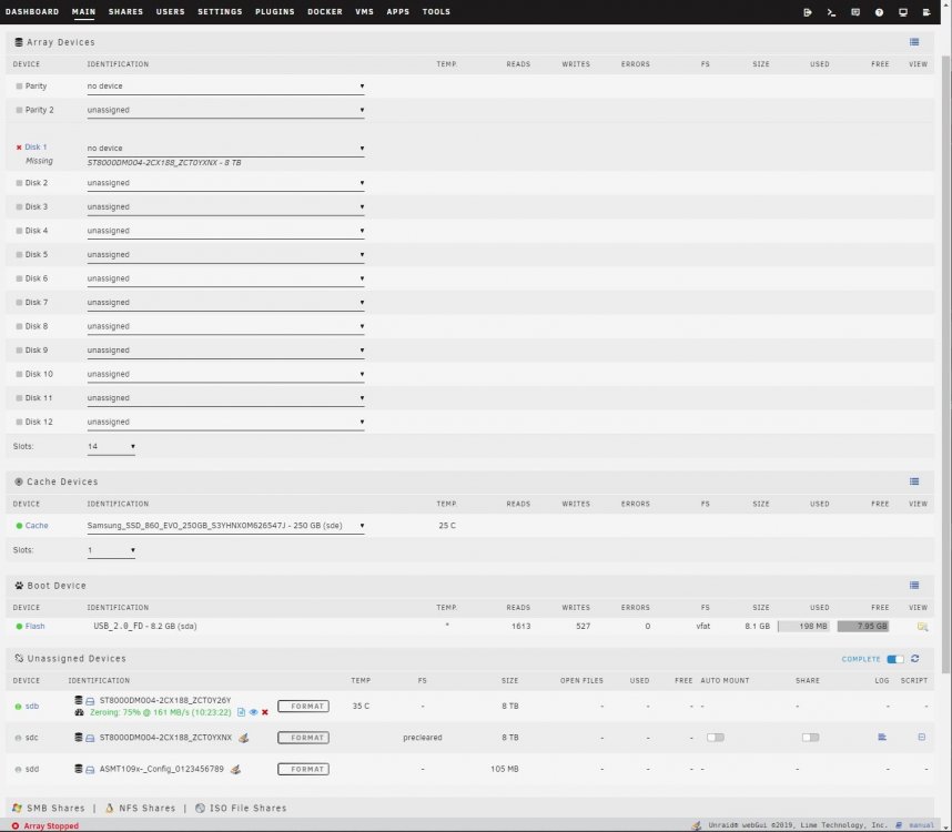

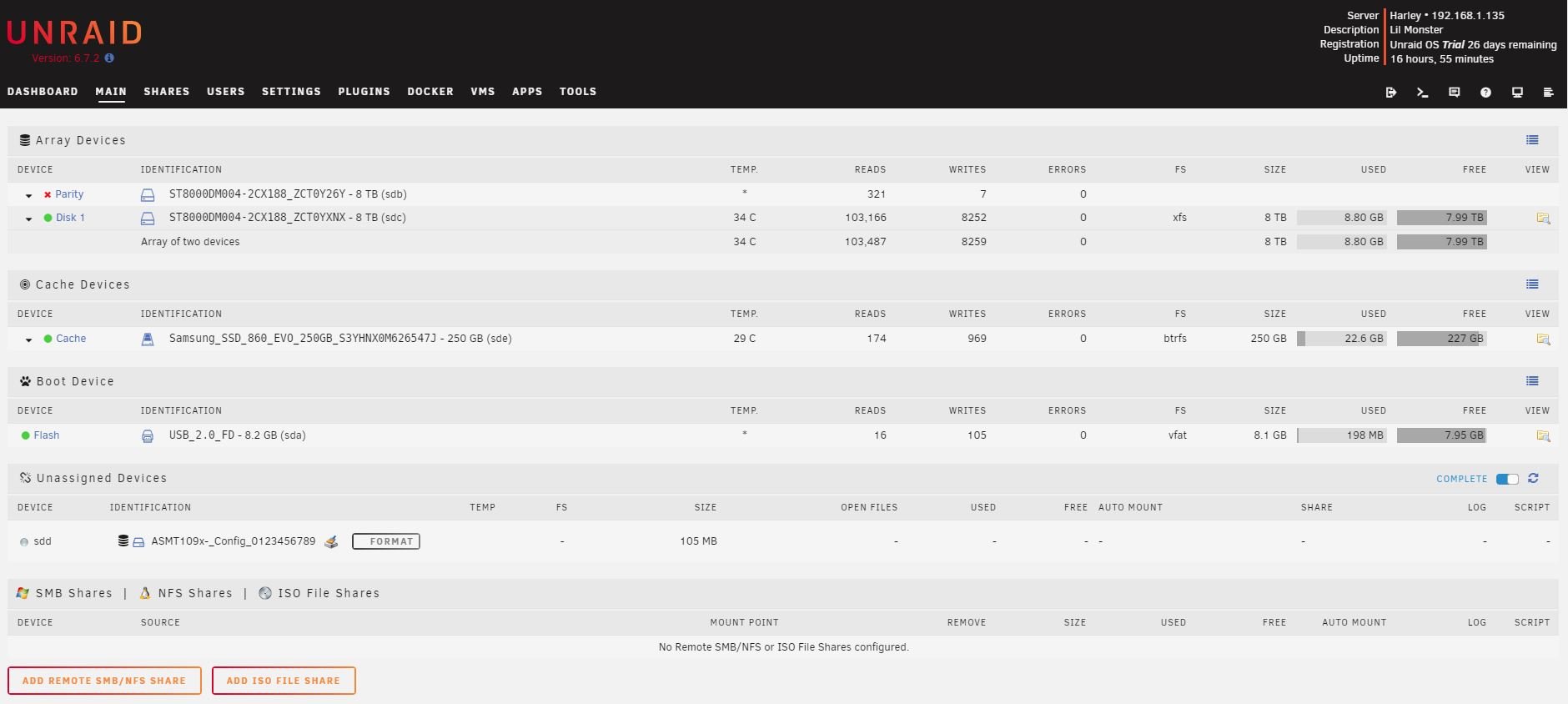

Post a screenshot of Main in the GUI.
Did you assign that device? It shouldn't be assigned, just ignore it.
Thanks for the help!

I don't believe so. I could be wrong but if I remember it just popped up with the other 3 drives. 2 8TB/ea Hard Drive 1 250GB SSD and this strange 105MB thing ;)
So just ignore it, format all on array options will only format array or cache devices.
The motherboard I'm using only has SATA II on it so I installed a SATA III card (see photo) and I think it might be the issue. I see the name of the main control chip ASM1062+1093 is similar to the 105MB partition in question: ASMT109X_Config_0123456789

Almost certainly, and those controllers are not recommended since they use SATA port multipliers and usually cause timeout errors with Linux, if you see that on the syslog or Unraid appears to stop responding for a few seconds that's most likely the problem.
I bet that's why I had to preclear 3 times! (error/problems/fail) This time I moved the drives to my motherboard SATA II ports and the one drive precleared without a problem so far as you see in the screenshot.  I'll be returning this one unit. Could you recommend an affordable SATA III controller that I could grab from Amazon Prime?

This is the 4th time I precleared this drive and added as a PARITY drive and it still has the RED X next to the drive. Do you have any idea as to what I can do to spin this drive up as a Parity drive.. I'm at a loss. Preclear came back perfect all 3 times. Thanks so much in advance for all your help.x
In order to get it to be usable (since it's been disabled previously), you have to stop the array, unassign the parity drive, start the array, stop the array, reassign it as parity, and then let it build

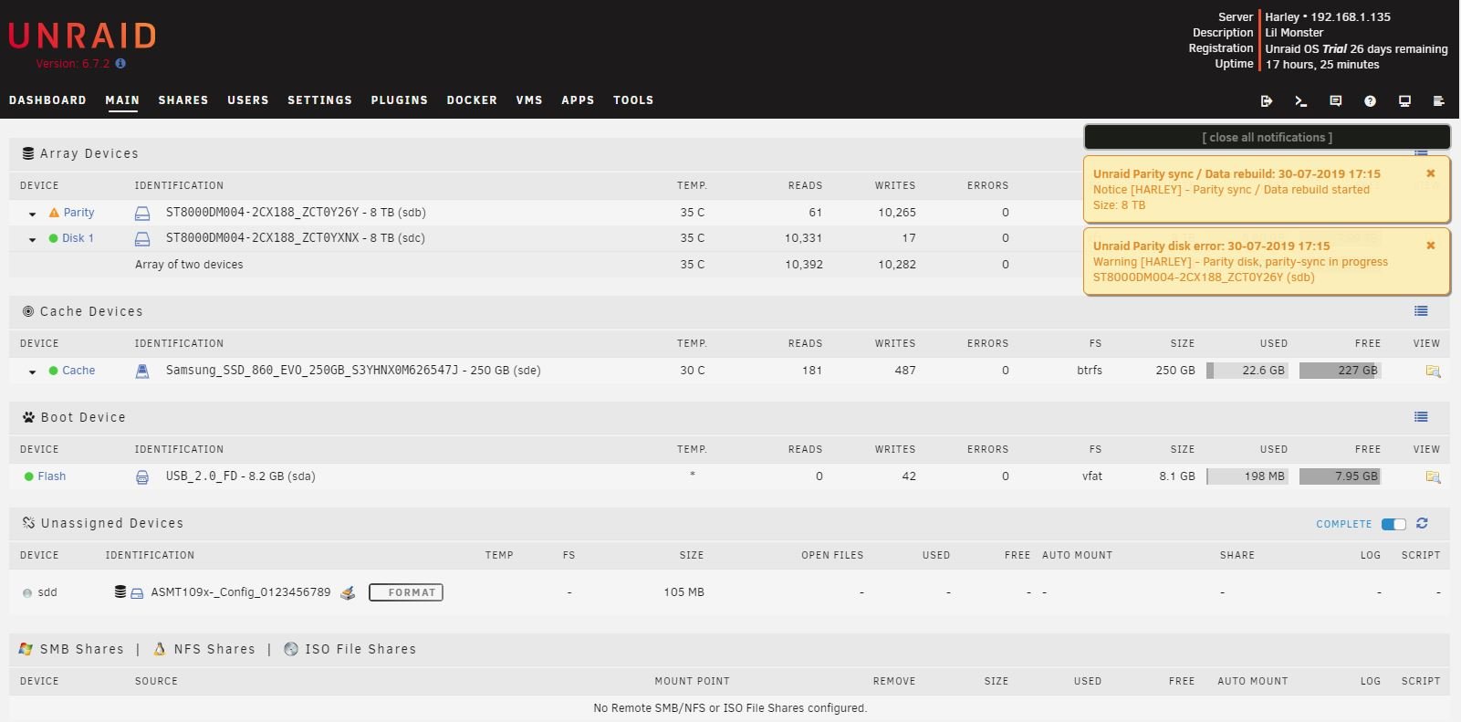

THANK YOU!!!!!!    OMG... Question: is there a log the show how long it will take to rebuild? There's 0 bytes of data on the array currently.
The time to rebuild parity is nothing to do with the amount of data on the array - it is merely controlled by the size of largest parity drive.    It tends to take something like 2-3 hours per TB.
