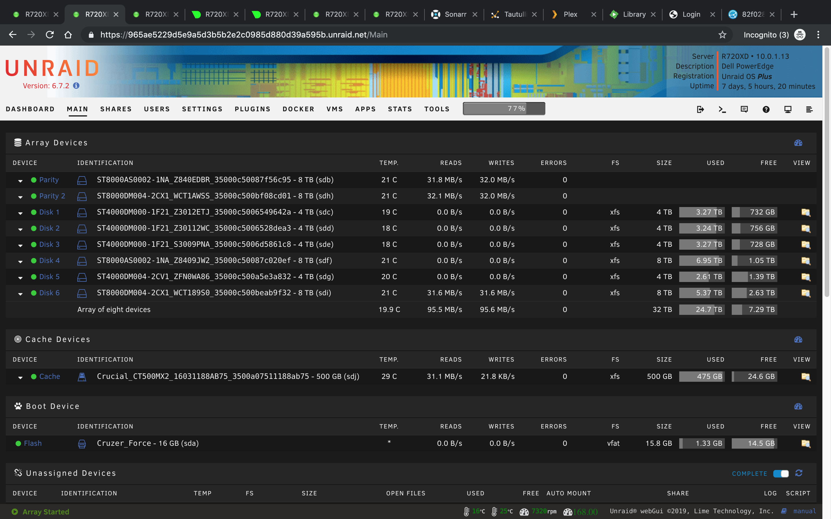

I am guessing this may be a very simple answer from someone, When moving Media from my Download Server R710 to my Plex Server R720XD it fills up the cache drive 500GB " I am going to buy a 2TB next month" Anyway when i click move the SSD read is 30MBs and Write is about the same on Parity 1 and Parity 2 and Disk 6. It used to be faster! Is it slower as i now have Dual Parity? I have the CA turbo on. Again this may be a silly question But when the mover is running Should Plex Grind to a STOP and say your connection to the server isn't fast enough. Im guessing its cos the drives are been read and written to etc. I Just wanted to check incase i can prevent it STOPPING Plex Playback. Normally i leave the mover to move at 03:00 when no one is watching.

Pls turn on reconstruct write ( turbo-write ), these a common complaint for disk array haven't best performance, btw won't worse as 33MB/s only.

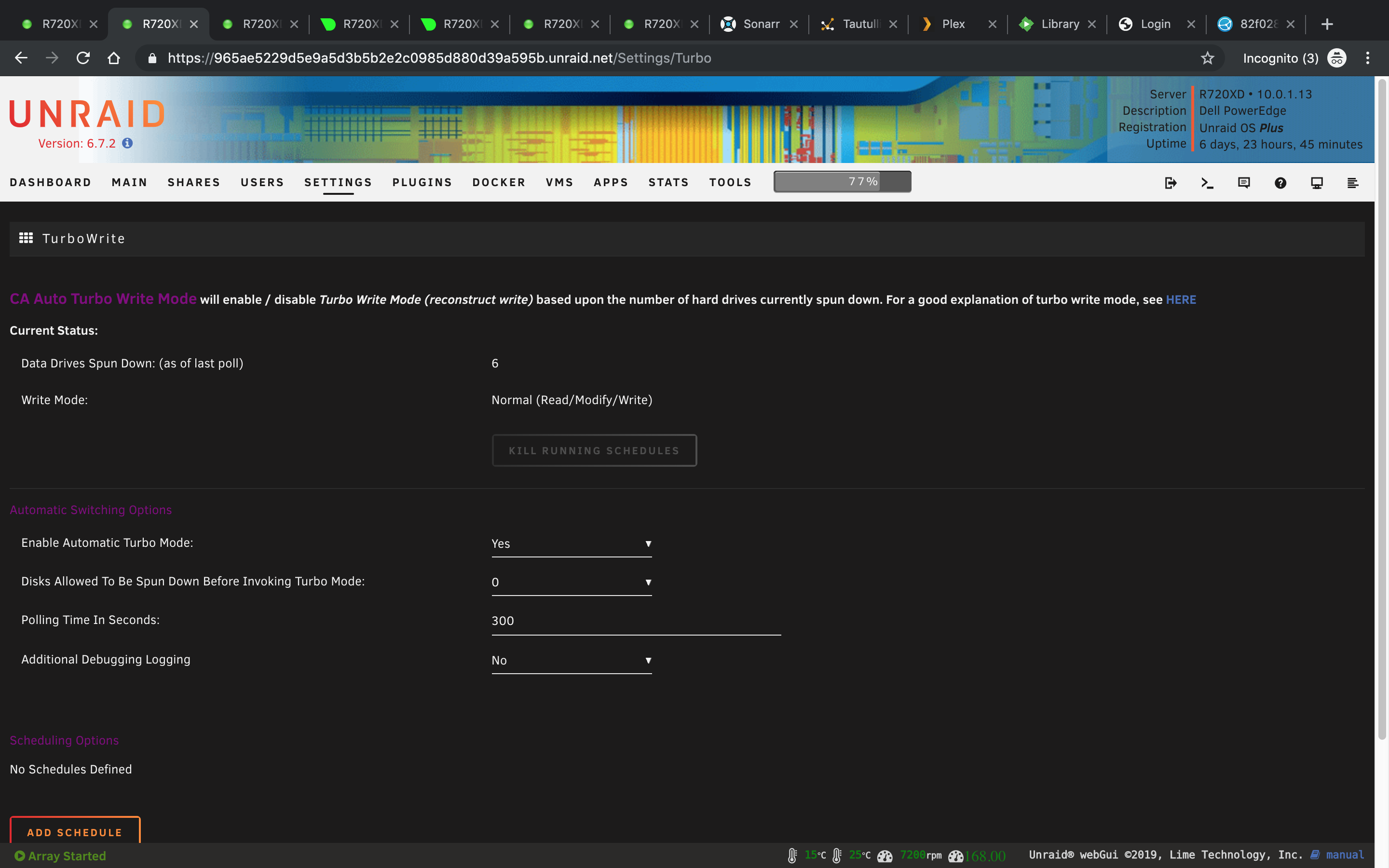

HI Thanks for the Reply, it is Turned on are the settings Wrong?

This is a plug-in which will turn-on or off reconstruct write mode, may be polling time too long for kick-in reconstruct mode ( I m not sure ).
