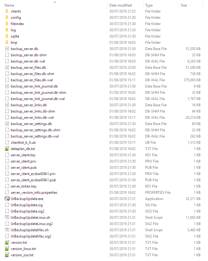

ahh right :-), that makes more sense, and from your bottom screenshot, inside the folder 'urbackup' there are files and folders in there right?
Correct, there are folders however of the four folders within the folder only the config folder has anything and it is one file. The urbackupsrv. Would I be correct in assuming that there should be more files?
yes it should look something like this, are you running unraid 6.7.x by any chance?:-
