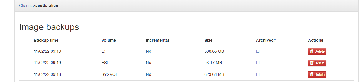

I have multiple windows machines using the client, and the host is running on my unraid system. Backing up images works like a charm. MY laptap is now taking a dump, and I need to do a restore from one of the backups. I created the Restore CD, ran it, and get to the page where I select which backup to use, but when I look at the list of hard drives to restore to, my internal HD on my laptop isn't there. Any misc USB's I have plugged in are seen, just not the HD. I've unplugged all the USB's and tried again, and now there is nothing listed in the destination dropdown.
Searching the net there were some articles talking about a restore button that should be in the web UI of the server... I don't see it. I can't even find the file that some people referenced changing a setting in "urbackupclient"
I was able to do a windows restore and keep my files, so I have a partially working laptop. I reinstalled the client so I can try stuff now, but I just can't seem to get a restore started. Any ideas?

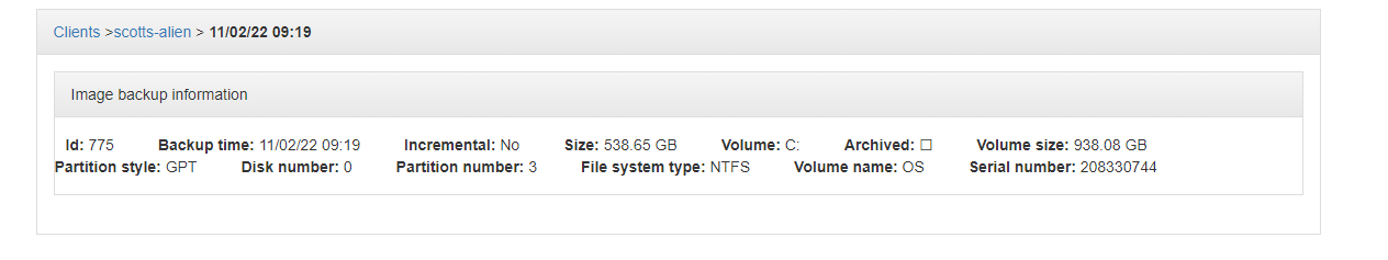

when I click on the listed backup from the web ui, all it gives me is image backup information.

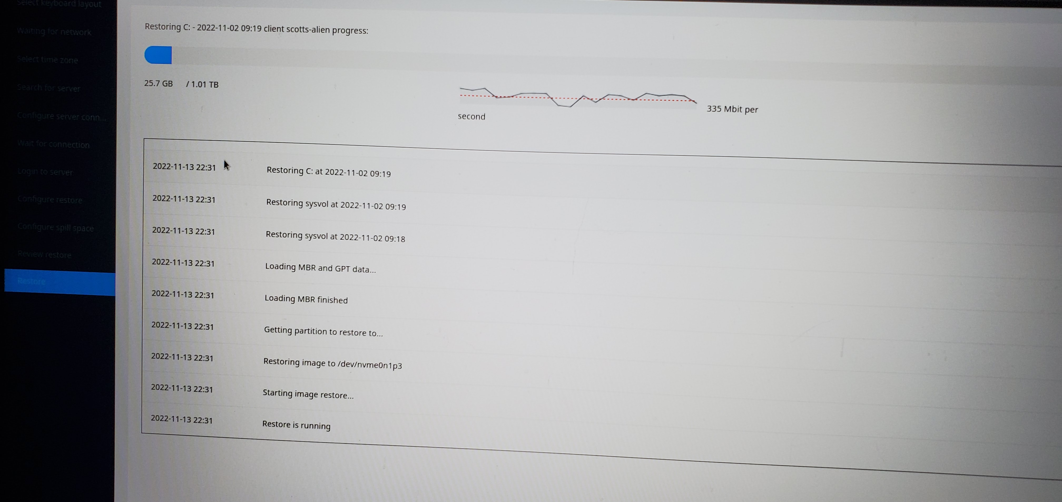

EDIT:  That did the trick. BIOS had the drive set to RAID. Disabled that (wouldn't let me boot back into Windows of course) and the when I booted the Reatore CD the drive showed up and I'm currently watching it restore!

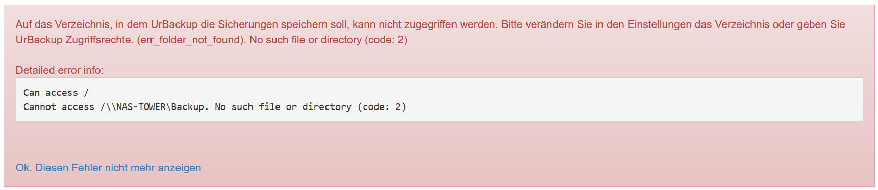

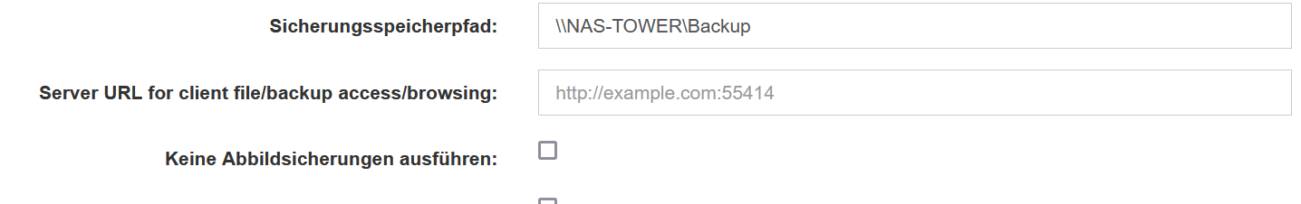

I wanted to setup UrBackup and set the path where to put the backupfiles but I always get an error due to the wrong path.
I want to write the files not to the NVME Disc but to my array. What do I need to put in there?
grafik.thumb.png.bf7551ed3e60cfeeb8c7bac8e4d52d34.pnggrafik.thumb.png.f468769f3f49f59710131f7547c81dce.png
Path must stay at /media in urbackup and you map that to where you want in the template.
