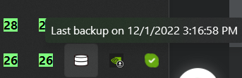

Using binhex-urbackup for a while and all fine , but on clients i dont have a local time,
in the server its OK, how to fix it ,should i add (-v /etc/localtime:/etc/localtime:ro \) in container for it ?

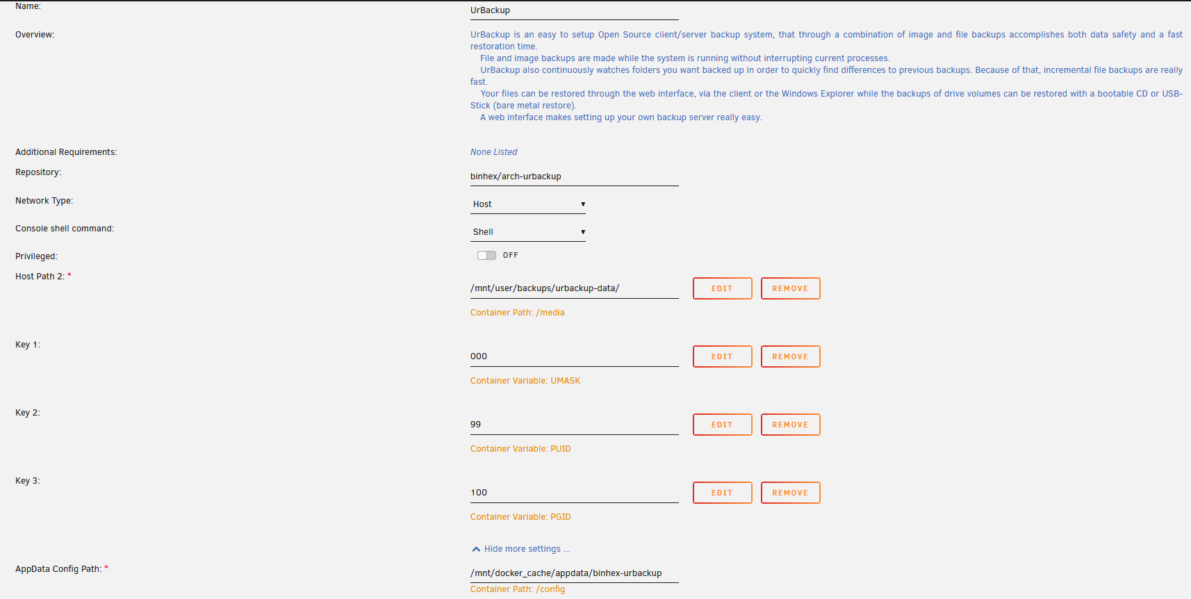

  • Basically you remove UMASK, PUID and PGID variables and change the the variable for the backup to point to "/backups" (container path) and the appdata to "/var/urbackup" (container path).
  • @betaman@Elmojo, I know this is an 18 page thread right now, but I really, really recommend reading it all. Keep in mind the first few pages are teething issues with older versions of the software and
  • just got some time to try a full system backup of my daily driver vm, then created a new vm, booted off the urbackup recovery media and restored, and voila it worked a treat!, restored vm booted up an
Change "Repository" to: uroni/urbackup-server:latest
Change "Docker Hub URL" to: https://hub.docker.com/r/uroni/urbackup-server
If you want you can use the Icon @
https://forums.urbackup.org/uploads/default/original/2X/1/1051fd74d1dcbc3ad4220b43007fcab5287272b0.png
Add a new variable, named "TZ" and enter your right Timezone (e.g. "Europe/Berlin").

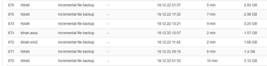

Wanted to ask about Cache disk for urBackup , im using it for while and no problems at all .
but today founded that Backup share is unprotected becose of urBackup directory in it. and some Dir/files is still on cache.
Using cache Yes for Backup share, so when used mover manualy  the dirs was not found .
On cache was some dir,links but cant be moved from cache. Tryed to move them manualy in mc,krusader but some was exist on array so decided to remove dirs on cache at end ...
The question is if some one had this situation and fixed it somehow?
Moving backups from one volume to another needs to be done carefully as urBackup uses hard links extensively. I just moved my backups from one unraid disk to another using Unbalance mod, and the -H parameter, and saw a large spike in incremental backup szes, I suspect due to messed up links. Not sure I'd go the route of backing up to cache.
using cache yes but then mover move all files to array, the strange thing all backup befor today its on array but today some linked folders not moved . and mover manually cant find folders ...
also found the mover take about 2 hours to move 7GB (40000 files) from cache to array.

is this right of container making folder/files (775)?
the mask still 000 but i think it was befor (777)

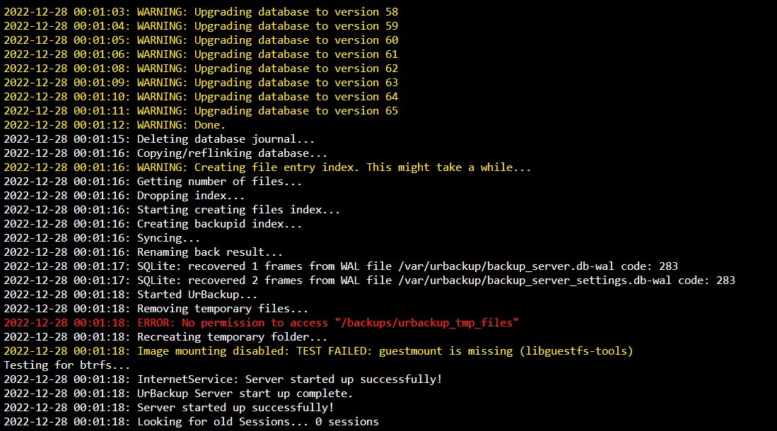

Hello, I've just update to uroni urbackup. Urbackup server started but empty, without any clients and previous backups..where I was wrong?
When urbackup started, it upgrade database version from old version to version 65.

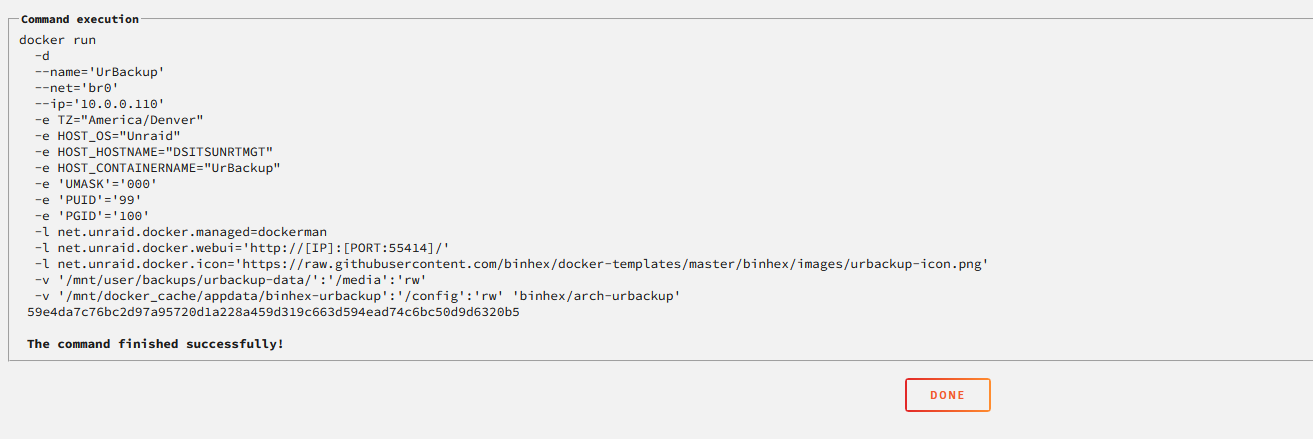

Hi everyone,
I'm fairly new to Unraid still and definitely still trying to get the hang of Docker too. I just recently got this container installed and everything appears to be running fine. However, there seem to be some frightening error messages and this is making me hold off on beginning to use this fully. When looking at Unraid's syslog, the container starts up fine. However, when looking at the container logs, I get the following:
2022-12-28 04:00:53,971 DEBG 'urbackup' stderr output:
Raising maximum file descriptor to 65535 failed. This may cause problems with many clients. (errno=1)
Raising nice-ceiling to 35 failed. (errno=1)
2022-12-28 04:00:53,983 DEBG 'urbackup' stdout output:
Backupfolder not set
2022-12-28 04:00:53,987 DEBG 'urbackup' stdout output:
In addition, here is what I see in the Unraid Syslog when turning the container off via the Web GUI. It seems very concerning.
Is this expected behavior for anyone else?
Dec 28 04:16:08 Tower kernel: urbackupsrv[4176]: segfault at 0 ip 0000000000000000 sp 00007ffdb1ce84b8 error 14
Dec 28 04:16:08 Tower kernel: Code: Unable to access opcode bytes at RIP 0xffffffffffffffd6.
Here is a screenshot of my Docker configuration.
Any assistance or ideas into fixing these?

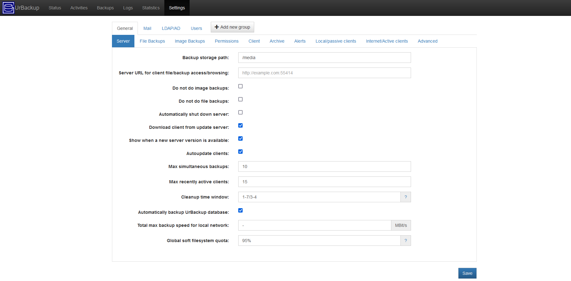

From within the container, I was looking at the start.sh script within the root user directory (/root/start.sh) and found something interesting. It has this listed, which I believe is not set correctly:
# set default location for backup storage to /media
  echo "/media" > /var/urbackup/backupfolder
I checked in /var/urbackup/backupfolder and it is not a directory @binhex It simply creates a file called backupfolder that has "/media" printed within it. I'm not sure if this is supposed to behave this way but it does not create a directory. There might need to be an update to the docker container itself to fix this? I'm still fairly new to Linux, but maybe a Symlink instead?
Anyways, hope I'm not the only one getting this 'Backupfolder not set' message. I'm just wanting everything sorted out before I start using it full-time. 😀

This does in fact need to be a text file named "backupfolder" that has the path of the backup folder in it. The thing that may be wrong is the location. From what i understand it needs to be "/etc/urbackup/backupfolder". Bind mounting a file containing /media to that location fixed the Backup Folder not set messages  for me. I cant speak to the others.
