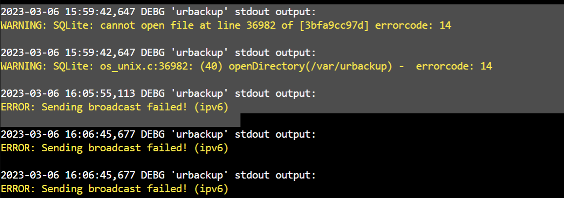

On 1/9/2023 at 3:15 AM, JonathanM said:
Are any other people seeing this in their logs?
Also have this error :
i do not have the errorcode 14 but my logs are flooded with IPV6 errors. would be nice if there was something in the template to turn off IPV6 as i don't believe the urbackup app itself has this built in yet. i notice people complain about this directly on their forum too.

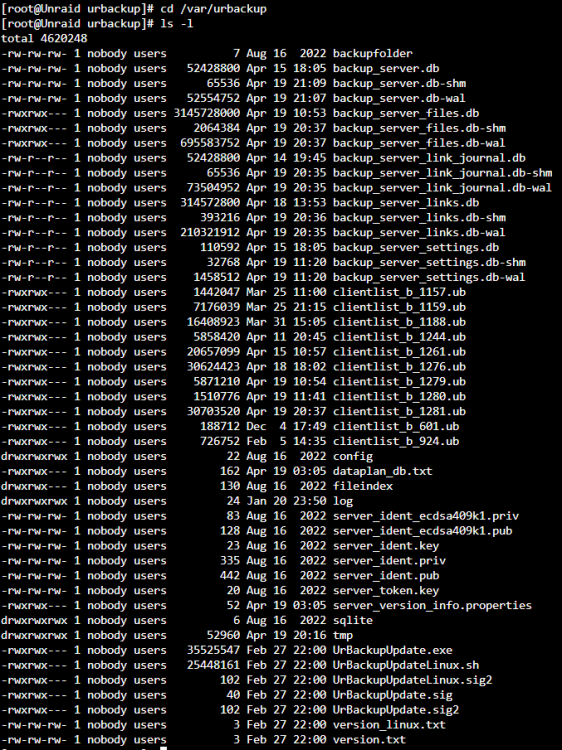

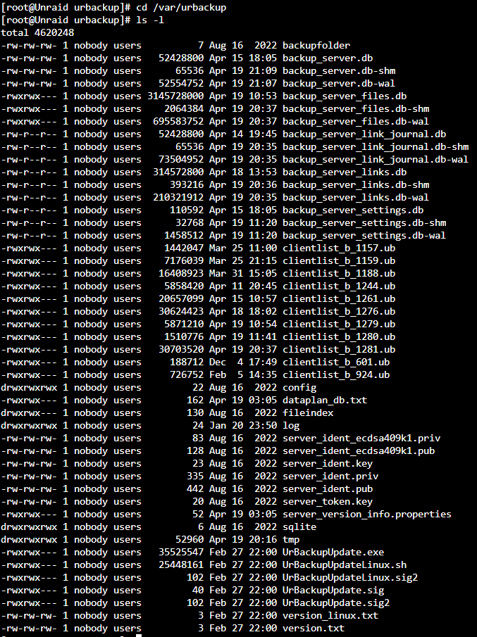

I run urbackup for a while now but since I changed the IDs of some of my clients and reinstalled urbackup after wiping out appdata by changing the Share from Cache to prefer and back etc. my Disk ran full in no time now.
So I guess there must be lots of "unknown" client residual files I would lite to delete.
When I tried to do that in the docker console I got this:
sh-5.1# urbackupsrv remove-unknown
2023-04-19 17:16:58: Going to remove all unknown files and directories in the urbackup storage directory. Waiting 20 seconds...
2023-04-19 17:17:18: Shutting down all database instances...
2023-04-19 17:17:18: Opening urbackup server database...
2023-04-19 17:17:18: WARNING: SQLite: cannot open file at line 39363 of [3bfa9cc97d] errorcode: 14
2023-04-19 17:17:18: WARNING: SQLite: os_unix.c:39363: (13) open(/var/urbackup/backup_server_files.db) -  errorcode: 14
2023-04-19 17:17:18: Could not open db [urbackup/backup_server_files.db]
2023-04-19 17:17:18: ERROR: Database "urbackup/backup_server_files.db" couldn't be opened
2023-04-19 17:17:18: ERROR: Couldn't open backup server database. Exiting. Expecting database at "/var/urbackup/backup_server_files.db"
When I look at media/urbackup/ I find the following files:
sh-5.1# ls media/urbackup
backup_server.db            backup_server_link_journal.db      backup_server_settings.db      clientlist_b_6.ub             server_ident.priv
backup_server.db-wal        backup_server_link_journal.db-wal  backup_server_settings.db-wal  server_ident_ecdsa409k1.priv  server_ident.pub
backup_server_files.db      backup_server_links.db             clientlist_b_17.ub             server_ident_ecdsa409k1.pub
backup_server_files.db-wal  backup_server_links.db-wal         clientlist_b_18.ub             server_ident.key
So I just don't understand why is he incapable to open the database?

The second file he can't open (backup_server_files.db) exists here but it says he is expecting it in /var/urbackup/ , which is completely empty?
/var/urbackup is a symlink to /config/urbackup which is mapped to the appdata folder and that's where the db should be. /media/urbackup is just a backup copy generated during the nightly maintenance. You might be able to copy that back into /config/urbackup.
Edited by Kilrah
Thanks. Indeed I found the files there but it doesn't run...?
sh-5.1# cd /var/urbackup
sh-5.1# ls
backupfolder                       backup_server_links.db         dataplan_db.txt                 sqlite
backup_server.db                   backup_server_links.db-shm     fileindex                       tmp
backup_server.db-shm               backup_server_links.db-wal     log                             UrBackupUpdate.exe
backup_server.db-wal               backup_server_settings.db      server_ident_ecdsa409k1.priv    UrBackupUpdateLinux.sh
backup_server_files.db             backup_server_settings.db-shm  server_ident_ecdsa409k1.pub     UrBackupUpdateLinux.sig2
backup_server_files.db-shm         backup_server_settings.db-wal  server_ident.key                UrBackupUpdate.sig
backup_server_files.db-wal         clientlist_b_17.ub             server_ident.priv               UrBackupUpdate.sig2
backup_server_link_journal.db      clientlist_b_18.ub             server_ident.pub                version_linux.txt
backup_server_link_journal.db-shm  clientlist_b_20.ub             server_token.key                version.txt
backup_server_link_journal.db-wal  config                         server_version_info.properties
2023-04-19 20:55:29: Going to remove all unknown files and directories in the urbackup storage directory. Waiting 20 seconds...
2023-04-19 20:55:49: Shutting down all database instances...
2023-04-19 20:55:49: Opening urbackup server database...
2023-04-19 20:55:49: WARNING: SQLite: cannot open file at line 39363 of [3bfa9cc97d] errorcode: 14
2023-04-19 20:55:49: WARNING: SQLite: os_unix.c:39363: (13) open(/var/urbackup/backup_server_files.db) -  errorcode: 14
2023-04-19 20:55:49: Could not open db [urbackup/backup_server_files.db]
2023-04-19 20:55:49: ERROR: Database "urbackup/backup_server_files.db" couldn't be opened
2023-04-19 20:55:49: ERROR: Couldn't open backup server database. Exiting. Expecting database at "/var/urbackup/backup_server_files.db"
Probably wrong owner/perms.
sh-5.1# ls -l
total 1189992
-rw-rw-rw- 1 nobody users         7 Apr 16 19:53 backupfolder
-rw-rw-rw- 1 nobody users  52428800 Apr 19 10:22 backup_server.db
-rw-rw-rw- 1 nobody users     32768 Apr 19 21:10 backup_server.db-shm
-rw-rw-rw- 1 nobody users  20983192 Apr 19 21:10 backup_server.db-wal
-rwxrwx--- 1 nobody users 209715200 Apr 17 21:43 backup_server_files.db
-rwxrwx--- 1 nobody users   1146880 Apr 19 20:05 backup_server_files.db-shm
-rwxrwx--- 1 nobody users 642625272 Apr 19 20:05 backup_server_files.db-wal
-rw-r--r-- 1 nobody users  52428800 Apr 18 14:50 backup_server_link_journal.db
-rw-r--r-- 1 nobody users     32768 Apr 19 20:00 backup_server_link_journal.db-shm
-rw-r--r-- 1 nobody users  10543112 Apr 19 19:59 backup_server_link_journal.db-wal
-rw-r--r-- 1 nobody users  52428800 Apr 18 20:58 backup_server_links.db
-rw-r--r-- 1 nobody users    294912 Apr 19 19:59 backup_server_links.db-shm
-rw-r--r-- 1 nobody users 146008712 Apr 19 19:59 backup_server_links.db-wal
-rw-r--r-- 1 nobody users     94208 Apr 19 10:22 backup_server_settings.db
-rw-r--r-- 1 nobody users     32768 Apr 19 18:42 backup_server_settings.db-shm
-rw-r--r-- 1 nobody users    655112 Apr 19 15:05 backup_server_settings.db-wal
-rwx------ 1 nobody users   2277102 Apr 18 20:58 clientlist_b_17.ub
-rwx------ 1 nobody users   3227964 Apr 18 21:24 clientlist_b_18.ub
-rwxrwx--- 1 nobody users  14967631 Apr 19 20:04 clientlist_b_20.ub
drwxrwxrwx 1 nobody users        22 Apr 16 19:53 config
-rwxrwx--- 1 nobody users       162 Apr 19 18:42 dataplan_db.txt
drwxrwx--- 1 nobody users       130 Apr 16 19:53 fileindex
drwxrwxrwx 1 nobody users        24 Apr 16 19:53 log
-rw-rw-rw- 1 nobody users        83 Apr 16 19:53 server_ident_ecdsa409k1.priv
-rw-rw-rw- 1 nobody users       128 Apr 16 19:53 server_ident_ecdsa409k1.pub
-rw-rw-rw- 1 nobody users        23 Apr 16 19:53 server_ident.key
-rw-rw-rw- 1 nobody users       335 Apr 16 19:53 server_ident.priv
-rw-rw-rw- 1 nobody users       442 Apr 16 19:53 server_ident.pub
-rw-rw-rw- 1 nobody users        20 Apr 16 19:53 server_token.key
-rwxrwx--- 1 nobody users        52 Apr 19 18:42 server_version_info.properties
drwxrwxrwx 1 nobody users         6 Apr 16 19:53 sqlite
drwxrwxrwx 1 nobody users       560 Apr 19 20:05 tmp
-rwxrwx--- 1 nobody users  35525547 Apr 16 19:53 UrBackupUpdate.exe
-rwxrwx--- 1 nobody users  25448161 Apr 16 19:53 UrBackupUpdateLinux.sh
-rwxrwx--- 1 nobody users       102 Apr 16 19:53 UrBackupUpdateLinux.sig2
-rwxrwx--- 1 nobody users        40 Apr 16 19:53 UrBackupUpdate.sig
-rwxrwx--- 1 nobody users       102 Apr 16 19:53 UrBackupUpdate.sig2
-rw-rw-rw- 1 nobody users         3 Apr 16 19:53 version_linux.txt
-rw-rw-rw- 1 nobody users         3 Apr 16 19:53 version.txt
sh-5.1#
Some of the files have been accessed today but not the one that shows the error, so the folder/files are seen and I'd suspect that file has been corrupted.
Great. 😞
I deleted all now and set it up from scratch...didn't increase my trust in that system though...
Thanks for the help!
