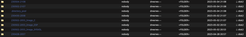

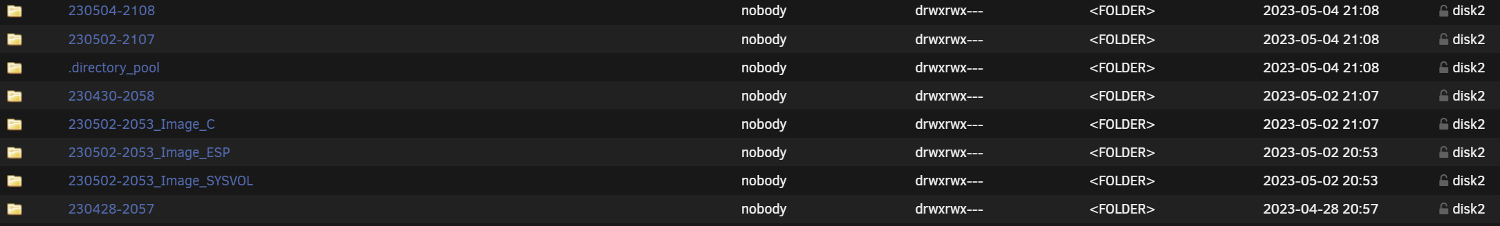

is anyway we can set permissions for folders of backups clients ?
i found i have all clents dir/subdirs have drwxrwx--- but the old one have
drwxrwxrwx ... and container UMASK 000 ...

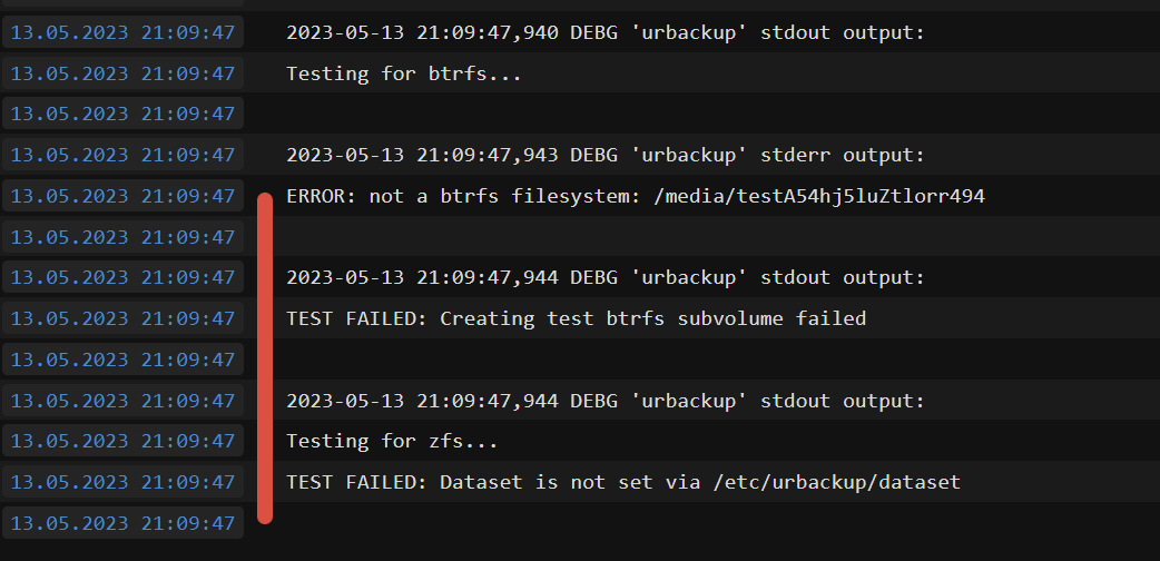

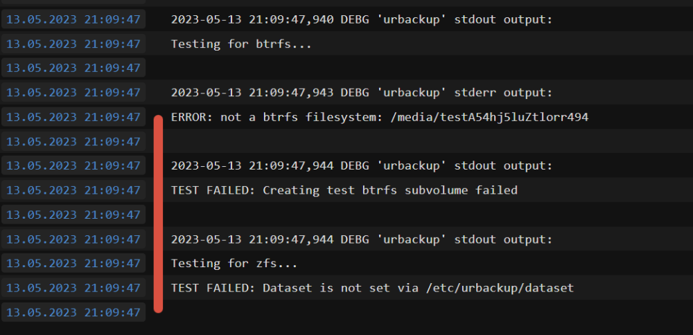

On 5/13/2022 at 12:18 AM, turbojazz said:
I had to run the container as privleged for it to be able to complete the btrfs tests correctly and use it.  Check the container logs on startup.
According to the "running" section of the urbackup docker README, btrfs support requires adding the `--cap-add SYS_ADMIN` parameter to the docker run command (it can be added as an `EXTRA_PARAMETER` in the unraid template).
For BTRFS-Support add --cap-add SYS_ADMIN to the command above
After adding this parameter, I no longer need to run the container as privileged to use btrfs.
@binhex Thanks for all your work creating and maintaining this container!

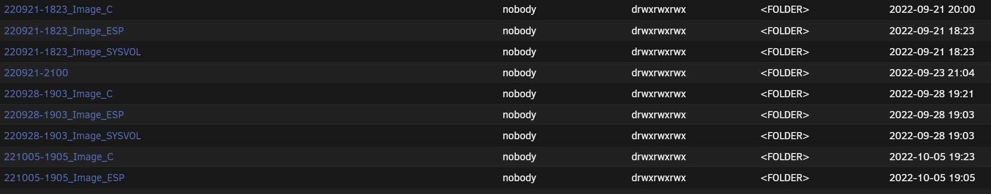

@binhex can you say if was something changes in permissions of container in past ?
Because i have old client PC with 777 permissions for folder :
but all newer clients have 770 :
or maybe i missing something ?
UMASK=000 in container .

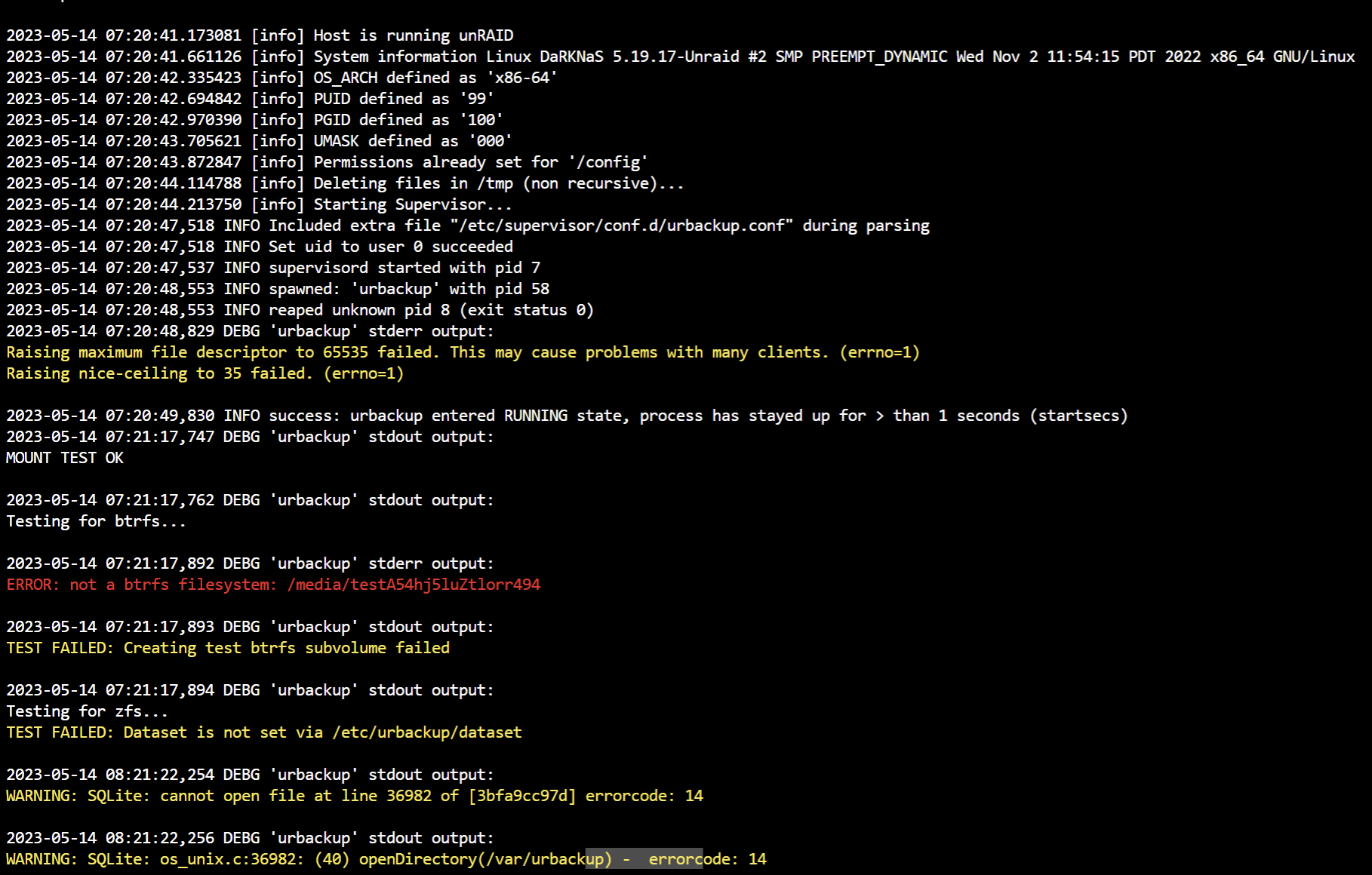

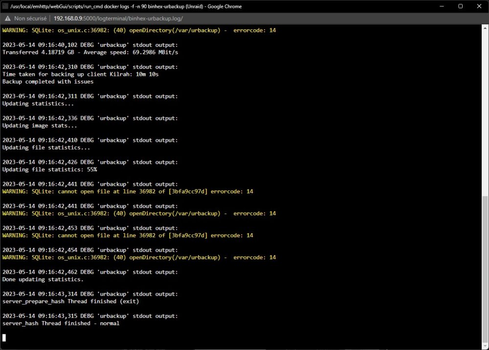

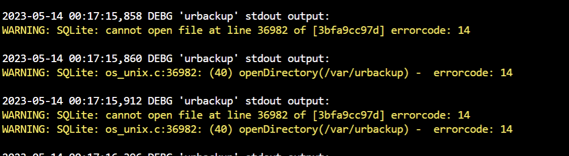

On 1/9/2023 at 3:15 AM, JonathanM said:
Are any other people seeing this in their logs?
WARNING: SQLite: os_unix.c:36982: (40) openDirectory(/var/urbackup) -  errorcode: 14
The only google result that looks relevant references symlinks for var/urbackup no longer working and needing bind mounts, so I'm wondering if I messed something up in my config.
To be clear, I can't see any issues besides a WARNING in the log file, everything seems to be working fine.
@JonathanM , @cayman Found this error , tryed to fix by older CAbackups of urbackup app , but still ,did you fixed this ?
@binhex the container working with 99:100 by default ,but in log i see user set to : 0 after 99 ? maybe becose of it i have error 14 of db , however all working fine ?

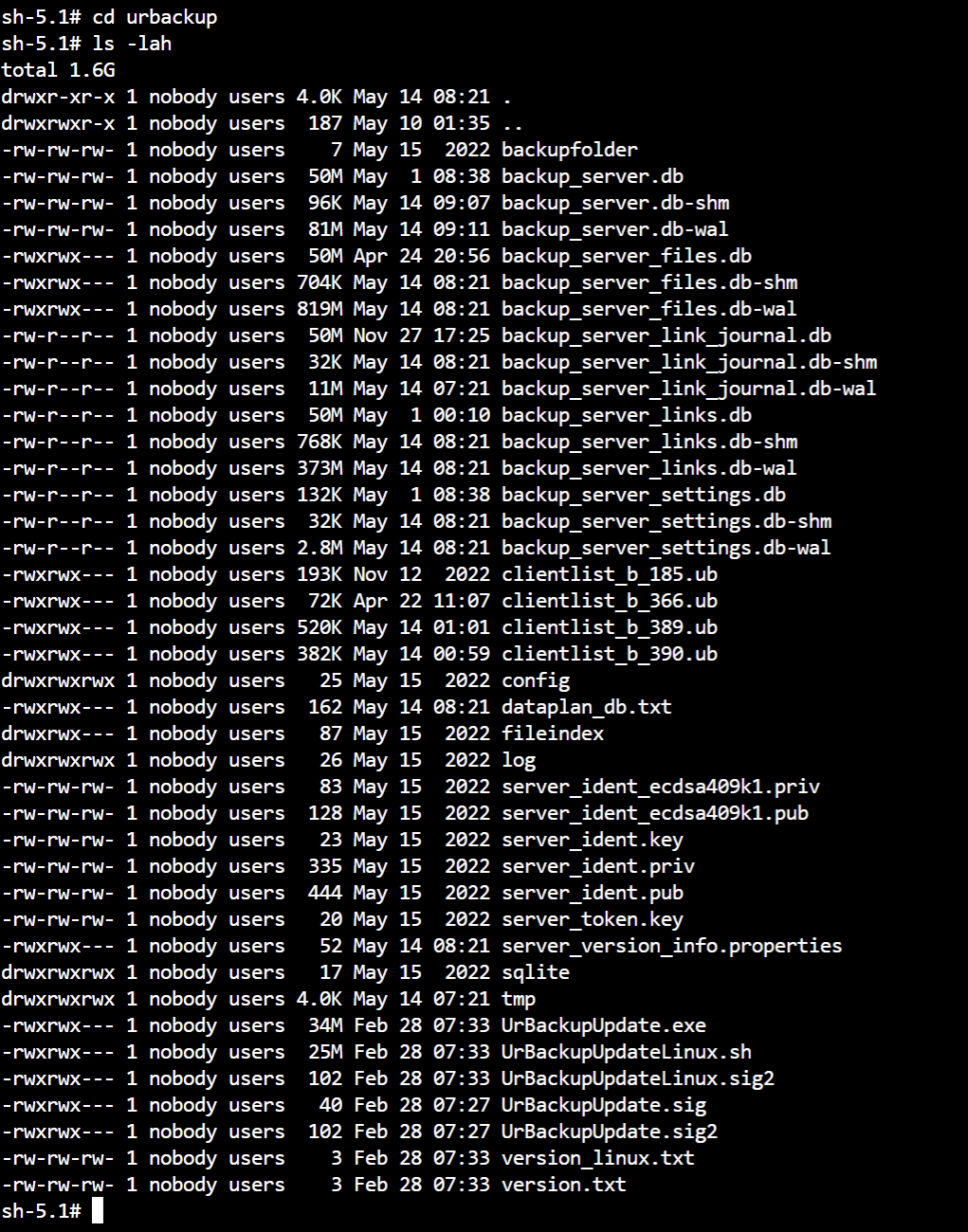

list of /var/urbackup :
I have some as well but it doesn't seem to be a problem, this instance has been running fine since last summer...
It might be because /var/urbackup is a symlink to /config/urbackup instead of being the actual storage location uerbackup expects?
Edited by Kilrah

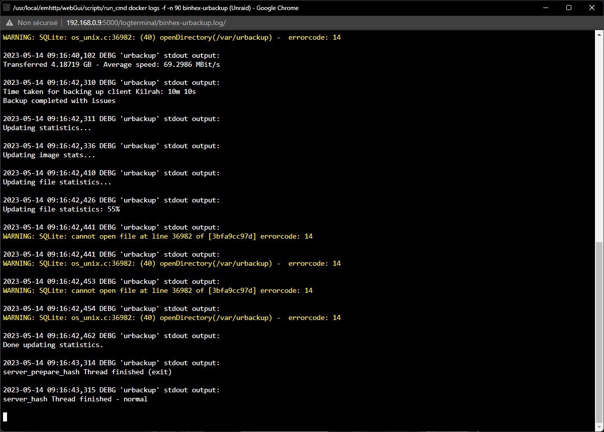

Yes all working fine , also found that i had this warning from 2 month ago, but yesterday i was thinking that it new and my sqlite DB is broken , so 2 hours i tried to fix it with CAbackups ... :)
Dont know really, maybe @binhex should knows better ?
i checked forum urbackup and this something with permissions .... someone get rid of this after clean install ...
no - but everything seems to work properly
Same ..
