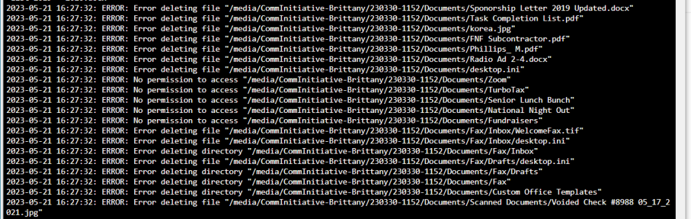

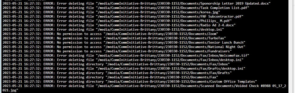

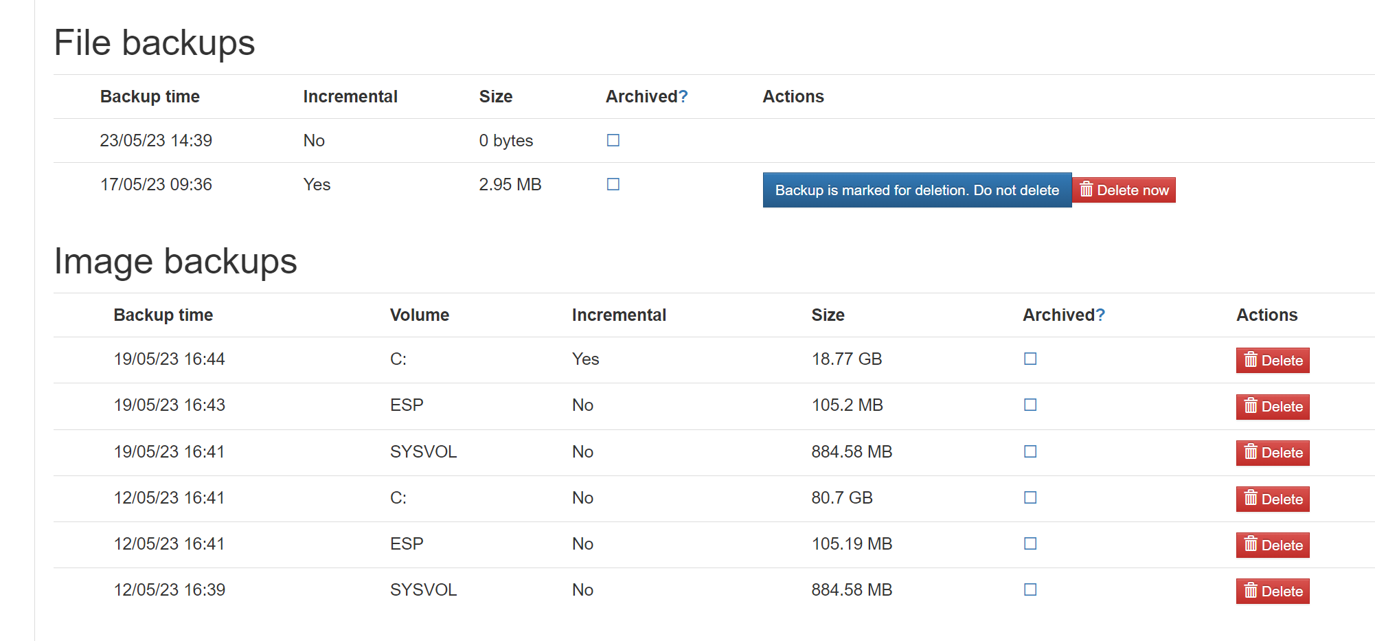

Hello,
I have been using my urbackup for a few years now, works great overall.  BUT every now and then I want to use the "cleanup" command and the "remove-unknown" command from the docker terminal.... and I get a lot of ERROR messages like "ERROR: Error deleting file '[the filename and path]"...    and ERROR: No permission to access "[filename and path]"....  thousands of them...
These are either files I am trying to clean up (like files for a  computer that we are no longer backing up anymore that has been removed from urbackup) or when trying to remove "unknown" files that are orphan files.
I am using urbackup in an unraid docker.. pretty normal setup.  I have it running with the highest priveledge and also "read and write" access to the unraid share...
Why am I getting these errors and how to I correct the permissions so that unraid can clean itself?
Thanks in advance,
George

On 5/21/2023 at 9:48 PM, GTM said:
Hello,
Thanks in advance,
George
if i were you i would simply use the urbackup web ui to delete old file or image backups, i would not advise using the command line, that way there be dragons! :-), example shown below gives you simple button clicks to delete file and/or image backups.
As for your errors, i can only assume permissions have got messed up there somehow, you can try resetting permissions by deleting the file /config/perms.txt then restart the container, keep in mind this could take a LONG time to re-apply permissions so be very patient and wait for the web ui to be accessible, it MAY also have unexpected consequences (i've never tried reapplying permissions for urbackup data) so ensure you backup before you do this.

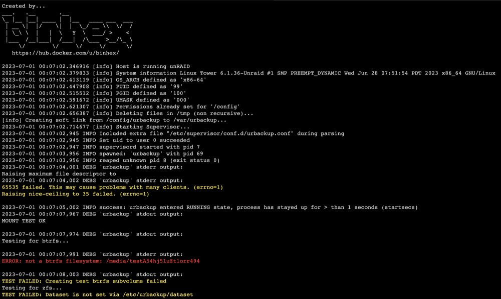

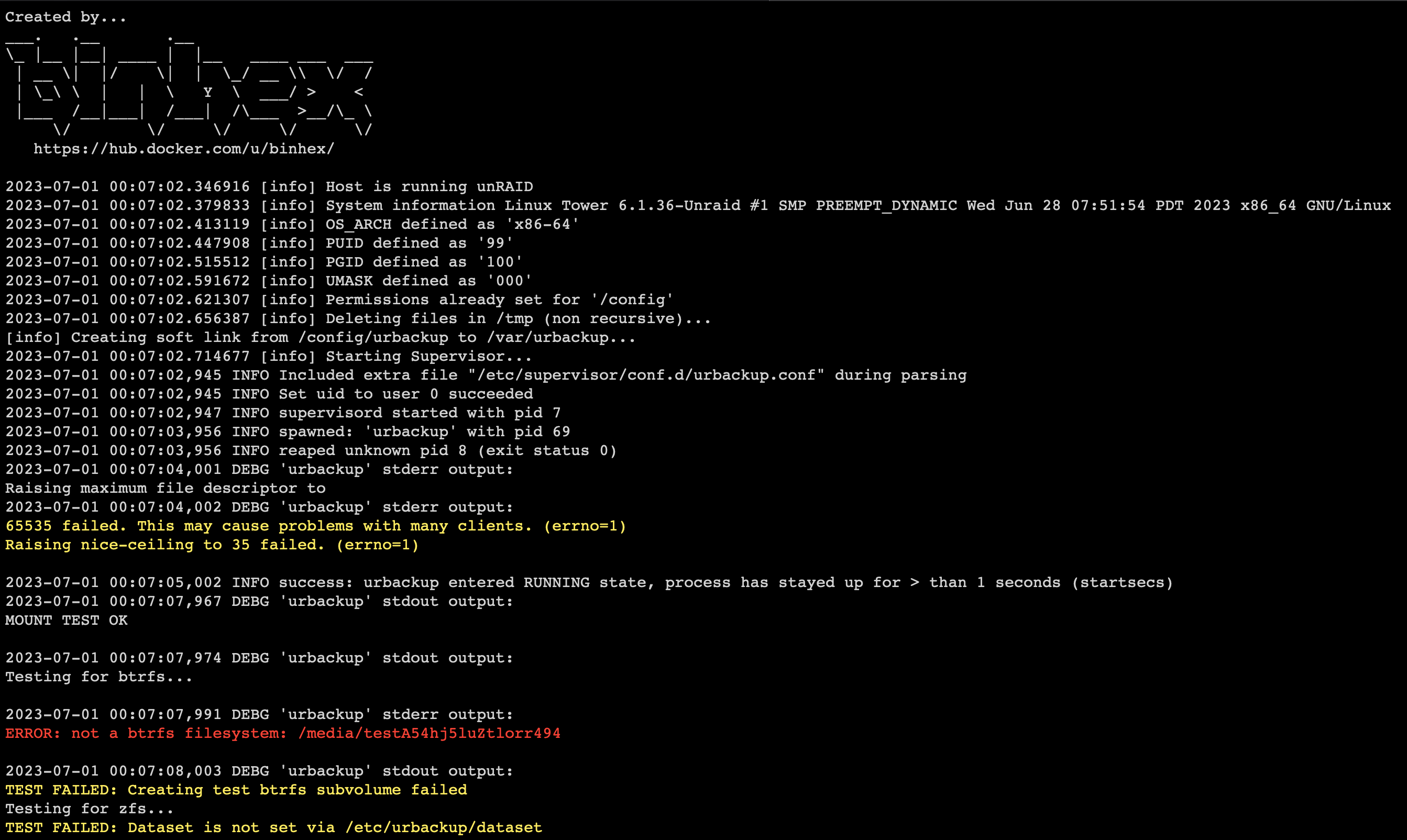

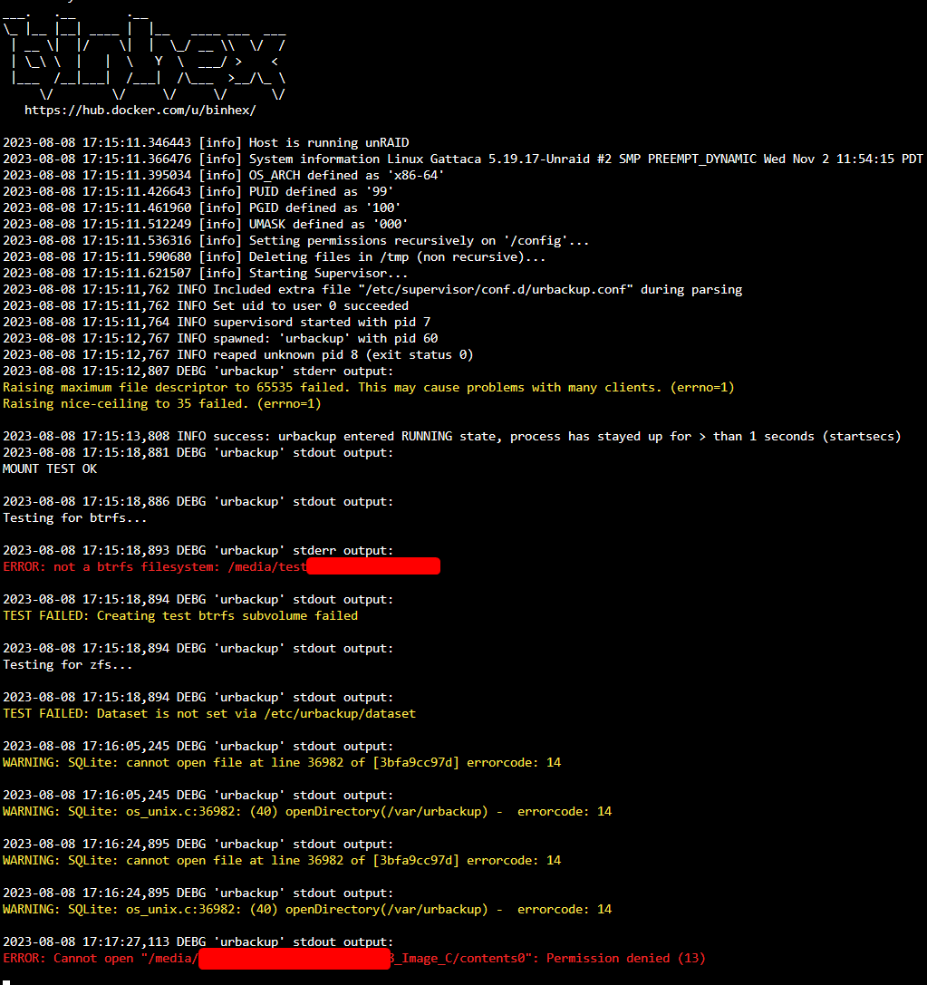

1628643734_Screenshot2023-07-01at00_07_57.thumb.png.ced181ab5de54c98b366b5468eb6c94b.pngHello to all. I need help regarding this issue (check above photo). I cannot access the UI (it just shows that it's loading)! I haven't done anything and yesterday it was working fine.
I need help with the problem. I did some google research but I don't understand the point. I don't use cache for the /media folder. urbackup sends it directly to array which is 4 disks all of them XFS.
What does it mean with BTRFS problem?
thanks all in advance
These are normal, should be unrelated.

Hi there. I'm trying to mount drive C image backup copy, but I've got this error. What can I do to resolve this?
724564443_2023_08_0817_21_41-usrlocalemhttpwebGuiscriptsrun_cmd_docker_logs_-f_firefox.thumb.png.ab598079c16ada7c60f324aeaeed6d2a.png

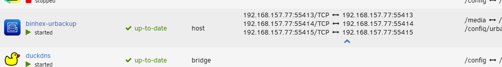

Hi guys,
I'm struggling to get UrBackup to run on my system. I'll just describe briefly what my situation looks like.
I have an Unraid server next to my Windows 10 desktop machine directly connected via dedicated 2,5G nics (they have static IP addreses). 2,5G Connection via SMB is flawless. The Unraid server gets Internet access through a Wifi Bridge which is plugged in to Mobo's 1G nic. Unfortunately, my Wifi is very slow (only getting about 200MBs/s), so a backup via the 2,5G nic is mandatory.
However, I can't seem to get this to work. Everytime I setup Urbackup it always starts backing up via Wifi.
I already tried setting the network type on the container to "custom: br1" to run it in the same network as my 2,5G nic in my desktop machine. If I than add a client in the webui and try to download the specific windows client I get the error message "ERROR: Signature verification failed".
Maybe I'm doing something completely wrong here, but is there any chance to get this setup working?
Edited by RAM4LIFE
Nevermind, I just figured it out. Had to open some ports on my firewall for Urbackup. After installing the general client, the server was able to find my PC. Now everything is working.

Has anyone had issues mounting an image backup from the WebUI?
The WebUI tries to mount but it just endlessly keeps loading/spinning and doesn't come back with any errors.
The log shows the below multiple times, which I'm guessing is related to the issue:
ERROR: Cannot open "/media/DELL/231001-2019_Image_C/contents0": Permission denied (13)
I have to restart the Docker to stop the Mount attempt.
