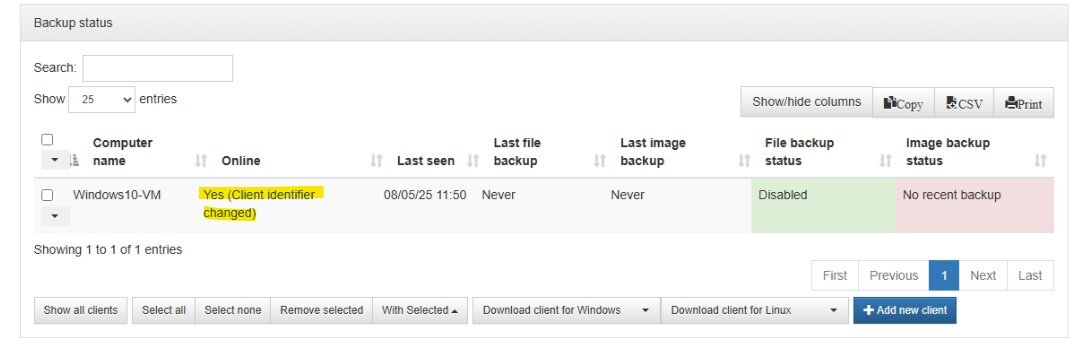

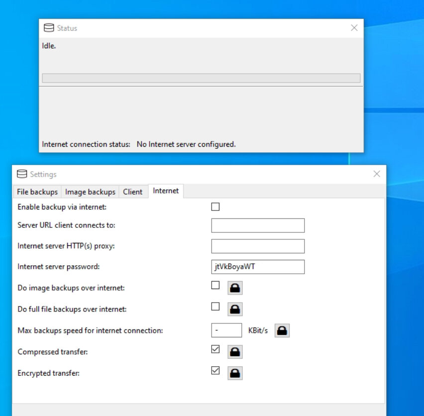

So "all of the sudden" (I know, but I really think it's true!), my URBackup stopped working because it's not connecting to the internet. I tried installing a new client (on same Windows VM) but no luck. I do a full image backup every day and this is what I'm seeing:
is there a specific reason you need your urbackup clients to connect to the server over the internet?, mine all connect within the LAN:
No not really since they're on the same LAN. However, I was addressing this message as root cause:

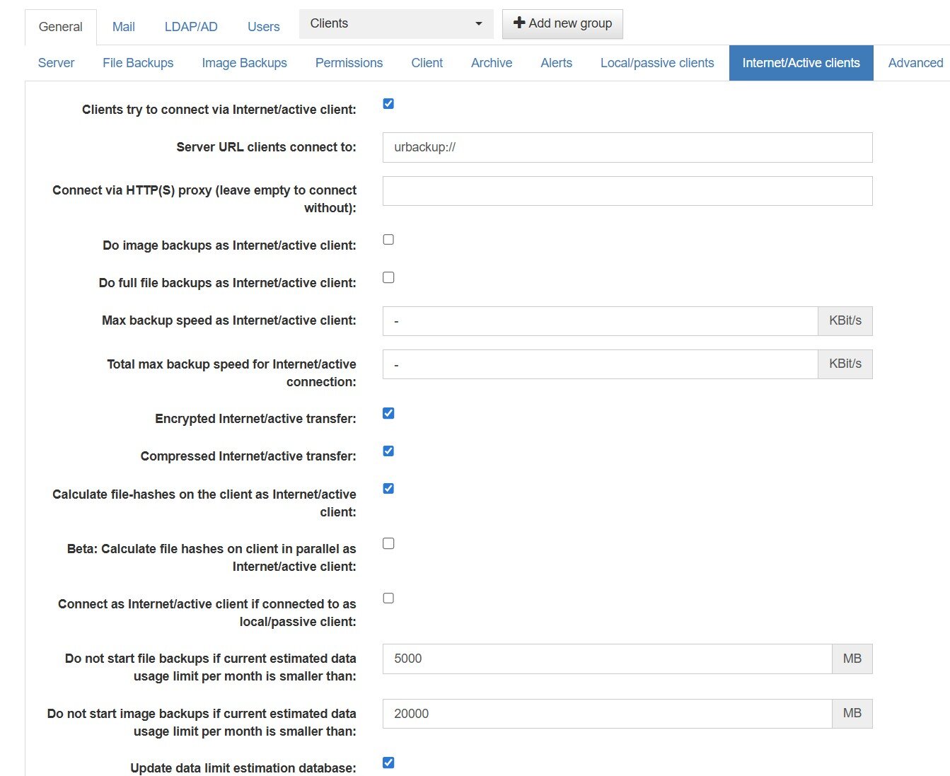

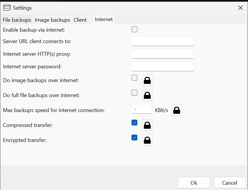

You seem to have your clients set to connect over the internet (from your screenshot), untick that option if all clients are on the same LAN.
It just means that somehow it's not seeing the server on the LAN, so check your networking and test reachability. Or restart the server, maybe it crashed and stopped sending broadcasts.
Edited by Kilrah

10 hours ago, betaman said:
That's what I did and received again the original error of No Internet Server configured.
ok this is what i think has happened:
  1. your urbackup clients were happily connecting to urbackup server locally over the lan - happy days
  2. something/someone ticked the option to set the urbackup clients to connect over the internet, the default 'server url clients connect to' was left as a blank url 'urbackup://' (invalid url).
  3. your urbackup clients get pushed the change from the server to connect over the internet instead of the lan and the client accepts the change, including the badly defined url.
  4. voila! your urbackup clients now have broken connectivity, they are attempting to connect over the internet to a urbackup server url of 'urbackup://' and failing to connect, and changing the option back on the server now does nothing, because the clients are not listening for the server over the lan (incorrectly configured).
So how do you get out of this?, easiest way is to right click the systray icon for the urbackup client, select settings/internet tab and untick the option enable backup via internet:
note: ensure you do NOT have the option set on your urbackup server 'clients try to connect via internet/active client' otherwise you will be going in circles as the server will auto reconfigure the client again and break connection.

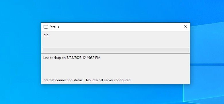

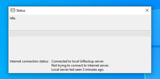

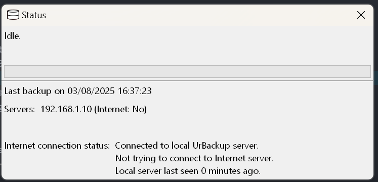

So I agree this endless loop seems to be the issue. I checked the server settings and the internet option was checked so I unchecked it. Went back to client settings and did same thing. A little later I check both server and client settings and client is back to internet checked even though server isn’t checked. I say F it and uninstall and reinstall client.
Now I get this (server still showing internet unchecked) after an initial message saying URBackup was waiting for local server.
EDIT: So now I see this message. I also just had to enable permissions on the client because the client name was the same as the prior one.
Edited by betaman
After getting the server and client side settings in sync again (i.e. local connection vs internet) and rebooting the server, it's working again. Thanks!

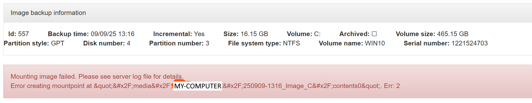

I tried to open a backed up image today, but getting an error. And I think I know what is going on on but don't want to break things 'cos I am noob in docker apps.
Clearly the image BACKUPs are working as the large files are there, but the retrieval of the images is not possible. The paths are confused somewhere and the server is looking in the wrong place when attempting to mount the image.
Note there is no problem with file backups.
I am editing this post as I work through a process of elimination which also includes a crash course in how docker actually sees things...😁
First, my settings:
Settings page:
The GUI shows me:
All BACKUPS are happening fine. And I can access FILE backups no problem. It is only mounting images is trouble.
I attempt to open an Image file via the GUI. It fails to mount. It can't find it as it is looking in the wrong place 😕.
The only thing I change in the pictures below is my PC name that is being backed up. Nothing else... no other part of the path
I can go to /media/urbackup/MY-COMPUTER/250902-0030.... and find that backup is there. The backup exists, but not where it is looking. It has forgotten to add the /urbackup/ part
Also in the log are cleanup messages, but that gets things correct and looks in the full path:
Here the path is the full /media/urbackup/ in front of it. This one is trying to delete from the correct place (just can't find it as something else already deleted it).
Question
How do I fix where it opens the image from? Clearly the BACKUP is working fine. And I can access and recover files from the file side, just something is going wrong mounting the Image backups. It feels to me like some confusion of paths have crept in here.
This is a REALLY old install of urbackup on an old v6.12.15 server. Has a path changed somewhere else? How do I fix this without disrupting the file backups? ONLY image backups seem to have an issue.
Note - these images are from a Windows PC. Sure they used to work last I looked, but that could be years ago.
Is there a simple tweak I can do to get it to look at the right place?

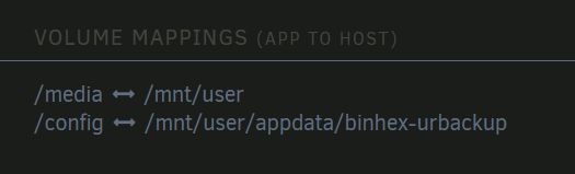

On 9/14/2025 at 2:31 PM, Batter Pudding said:
You should usually never pass the whole of /mnt/user to a container, you'd have created a share for it first (say "urbackup") and passed /mnt/user/urbackup to the container, then set /media as backup location.
But it's unrelated, AFAIK that feature isn't possible to use in a/this container anyway because it needs to do a fuse mount and what's required to do that isn't available.
Edited by Kilrah
Thanks for confirming. This is what I started to learn, and realised was looking wrong. But can I fix that now without messing up the backups? If I changed the /media to point to /mnt/user/urbackup and updated the backup storage path to point to /media as your screenshot would the backups be happy and continue as they are now, with continued update to the current backups? Isn't there file links I need to be concerned about?
To be fair, the only thing that has ever lived on that UNRAID box is urBackup. So no harm it being "wrong", but would be useful to correct.
Managed to re-read part of this thread (for approx 10th time) and could see my problems. And now understand this is not a feature of our Docker version. Guess the time I was thinking of is when I have done this on a server running on Windows.
But all was not lost. Even though the GUI would not let me unpack. The backups are there, just had to do some faffing around. I ended up manually dragging the last "full" backup back to my PC. And then raided files from the Windows Server edition so I could run "uncompress_image.bat"
I need to dig in and experiment a bit more. But importantly yesterday I got back the 20KB of files I needed, after transferring 367GB across the network and unpacking that to a 500GB file!! LOL. Good job I had plenty of disc space 🤣
Now, next time this happens, I assume I could attempt to uncompress directly across the network? Looking at how that script ran it was trying to index back through the incrementals.
Edited by Batter Pudding

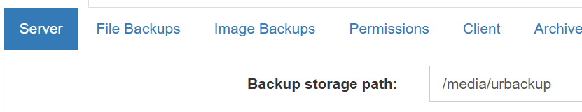

I want to fix my paths (see above)
In a standard install where the /media/ points to /mnt/user/urbackup and the Backup Storage Path is /media what is in your /mnt/user/urbackup folder?
I assume you have
BackupName
BackupName2
urbackup (with the database files in it)
urbackup_temp_files
As long as "urbackup" is a folder in there with the database files in it, I can't see why I can't just fix this. Stop server, fix paths, restart server.
I do notice that at the moment I have two "urbackup_temp_files" folders. On in /mnt/user/ and one in /mnt/user/urbackup/. I guess one of those is not normally sitting there.
If that is true you might want to consider making a note not to do it in the future and leave it at that, if there are no other shares then the risk is zero.
If you do want to be brave (this may cause issues) then the trick here is to NOT change the container path and instead change the host path ONLY, so i assume you told urbackup to store files in /media/urbackup (or similar, right?), so what you want to do is change /media for the container to point at /mnt/user/urbackup and then copy all files and folders in /mnt/user/urbackup/ (share created by urbckup) to /mnt/user/urbackup/urbackup/, yes its a bit ugly but it gets you around the issue.
Good luck!, if there is important data in your backups then tread carefully here!.
I assume you have
BackupName
BackupName2
urbackup_temp_files
Yup
I believe so, but not sure if the DB stores relative/absolute paths etc...
