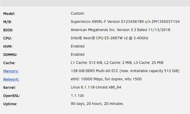

This is the server hardware.
I'm still running unRAID v6.12.14
PS: I also pulled 2.5.33-2-01, this version works for me.
Edited by Wimpie
this my setup, I will wait for an update

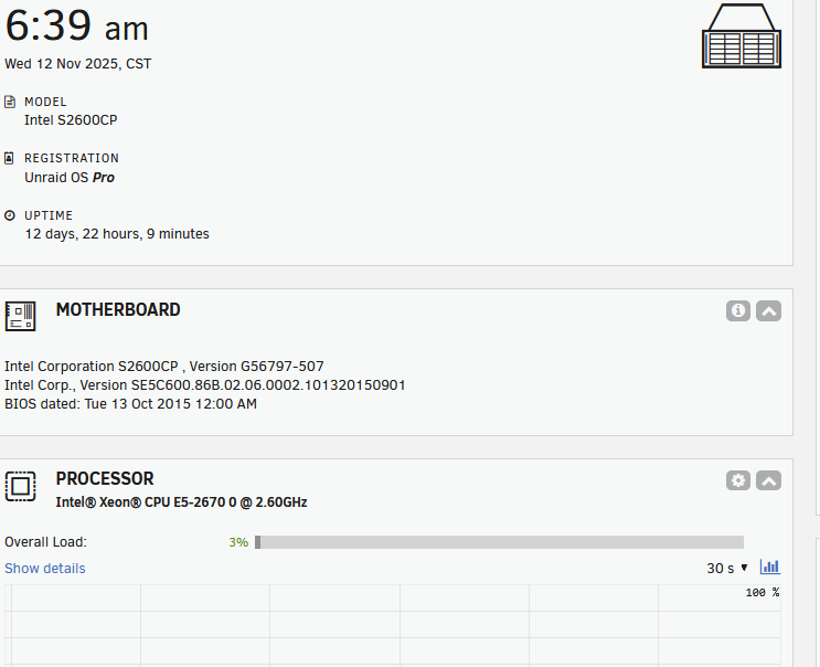

Also using S2600CP and same issue. I think it might be an issue with the onboard NIC?
How do we roll back versions again?
Edited by betaman
I'm using binhex/arch-urbackup:2.5.33-2-01
I don't use the onboard nic i use a intel quad nic,
Rolled back to the binhex/arch-urbackup:2.5.33-2-01 and it operational

Hi all, i have pushed a new image which i hope fixes the issue with the image for certain people (does not affect me), please update and let me know.
Hoi @binhex,
Saw your message just now.
I tried the new image (latest and then update), but it doesn't work for me.
Hope the log helps, if you need anything else, let me know...
In the mean time, going back to binhex/arch-urbackup:2.5.33-2-01...

2025-11-25 13:05:43,041 WARN exited: urbackup (exit status 132; not expected)
2025-11-25 13:05:43,041 DEBG received SIGCHLD indicating a child quit
2025-11-25 13:05:44,043 INFO spawned: 'urbackup' with pid 81
2025-11-25 13:05:44,058 DEBG 'urbackup' stderr output:
/home/nobody/start.sh: line 20:    87 Illegal instruction        /usr/bin/urbackupsrv run --config '/config/urbackup/config/urbackupsrv' --no-consoletime
2025-11-25 13:05:44,058 DEBG fd 9 closed, stopped monitoring <POutputDispatcher at 23114002441360 for <Subprocess at 23114002792864 with name urbackup in state STARTING> (stdout)>
2025-11-25 13:05:44,059 DEBG fd 11 closed, stopped monitoring <POutputDispatcher at 23114002296480 for <Subprocess at 23114002792864 with name urbackup in state STARTING> (stderr)>
2025-11-25 13:05:44,059 WARN exited: urbackup (exit status 132; not expected)
2025-11-25 13:05:44,059 DEBG received SIGCHLD indicating a child quit
2025-11-25 13:05:46,062 INFO spawned: 'urbackup' with pid 88
2025-11-25 13:05:46,079 DEBG 'urbackup' stderr output:
/home/nobody/start.sh: line 20:    94 Illegal instruction        /usr/bin/urbackupsrv run --config '/config/urbackup/config/urbackupsrv' --no-consoletime
2025-11-25 13:05:46,080 DEBG fd 9 closed, stopped monitoring <POutputDispatcher at 23114002296480 for <Subprocess at 23114002792864 with name urbackup in state STARTING> (stdout)>
2025-11-25 13:05:46,080 DEBG fd 11 closed, stopped monitoring <POutputDispatcher at 23114002717232 for <Subprocess at 23114002792864 with name urbackup in state STARTING> (stderr)>
2025-11-25 13:05:46,080 WARN exited: urbackup (exit status 132; not expected)
2025-11-25 13:05:46,080 DEBG received SIGCHLD indicating a child quit
2025-11-25 13:05:49,084 INFO spawned: 'urbackup' with pid 95
2025-11-25 13:05:49,098 DEBG 'urbackup' stderr output:
/home/nobody/start.sh: line 20:   101 Illegal instruction        /usr/bin/urbackupsrv run --config '/config/urbackup/config/urbackupsrv' --no-consoletime
2025-11-25 13:05:49,099 DEBG fd 9 closed, stopped monitoring <POutputDispatcher at 23114002923872 for <Subprocess at 23114002792864 with name urbackup in state STARTING> (stdout)>
2025-11-25 13:05:49,099 DEBG fd 11 closed, stopped monitoring <POutputDispatcher at 23114002926320 for <Subprocess at 23114002792864 with name urbackup in state STARTING> (stderr)>
2025-11-25 13:05:49,099 WARN exited: urbackup (exit status 132; not expected)
2025-11-25 13:05:49,099 DEBG received SIGCHLD indicating a child quit
2025-11-25 13:05:50,100 INFO gave up: urbackup entered FATAL state, too many start retries too quickly
Thanks for trying, could you try pulling down the latest image again (just tweaked it some more) and let me know the result.
We might have a winner...
