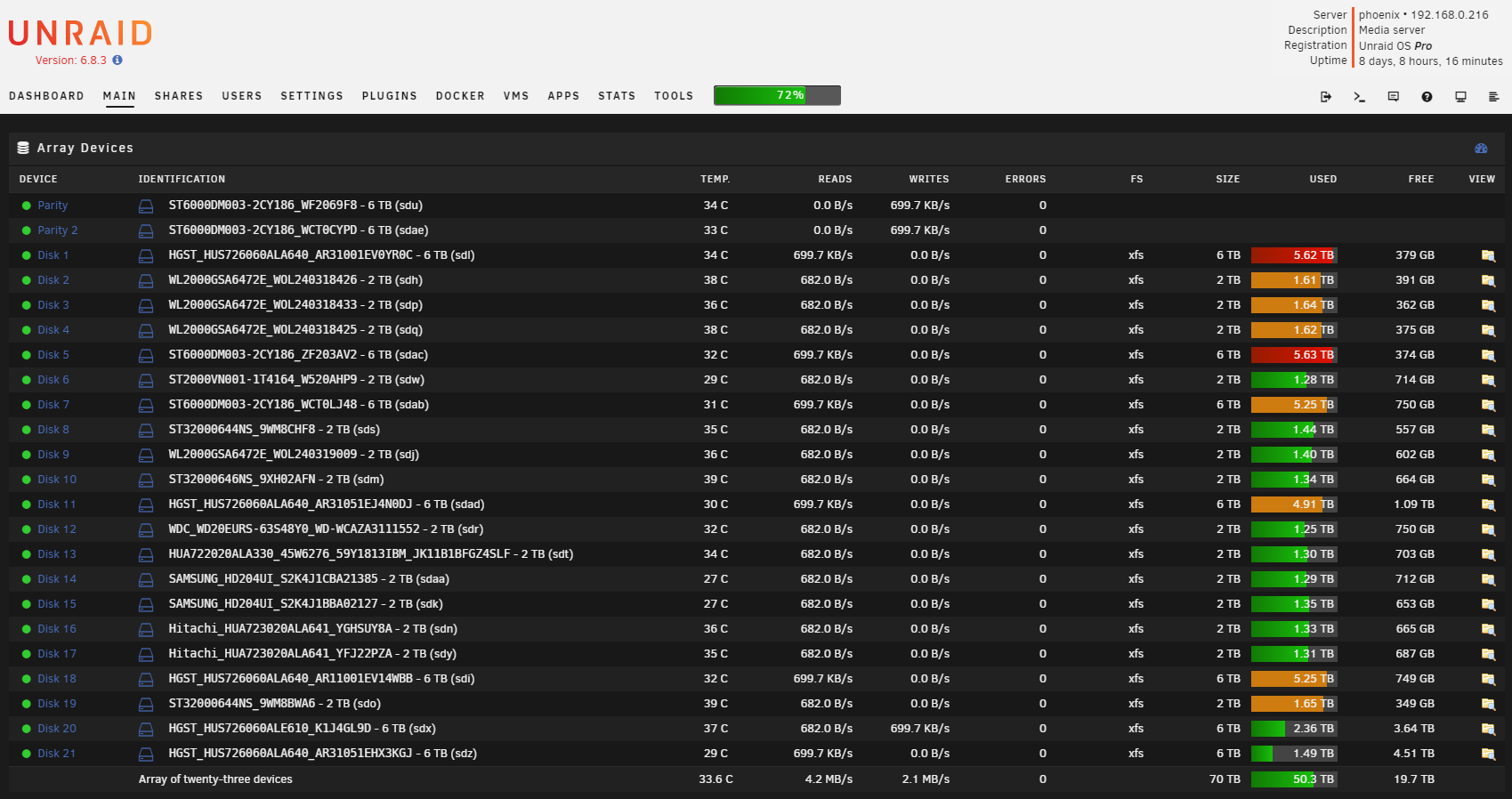

I really like what it's doing, having de-duped backups of a number of systems is great. Thanks @binhex for building and maintaining this docker.
Now, a few questions...

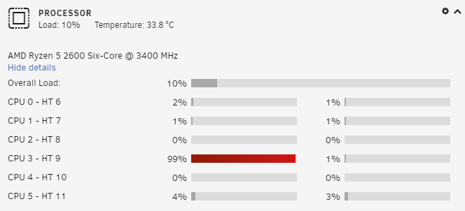

I am noticing that when a backup is running  (full image backup in this case) that urbackup maxes out one cpu core. It alternates every minute or so which one it is, but it 's unusual in doing this.
Also, I initially allocated a single disk for backups, outside of the array. Then I thought I might run out of space, so set it to be inside the array instead (avoiding cache). Due to the number of links (I believe) if I run "Compute All" on the shares then the size of the urbackup share can't be calculated. Would I be better off putting this back onto a dedicated disk instead, and is there a good way to move the backups or do I have to start over again?
i use urbackup myself but ive not really monitored cpu usage when a backup kicks in, but i would assume this is just how the app has been written, why it hops to a different core/thread i couldnt say tbh, maybe one for the urbackup forum.

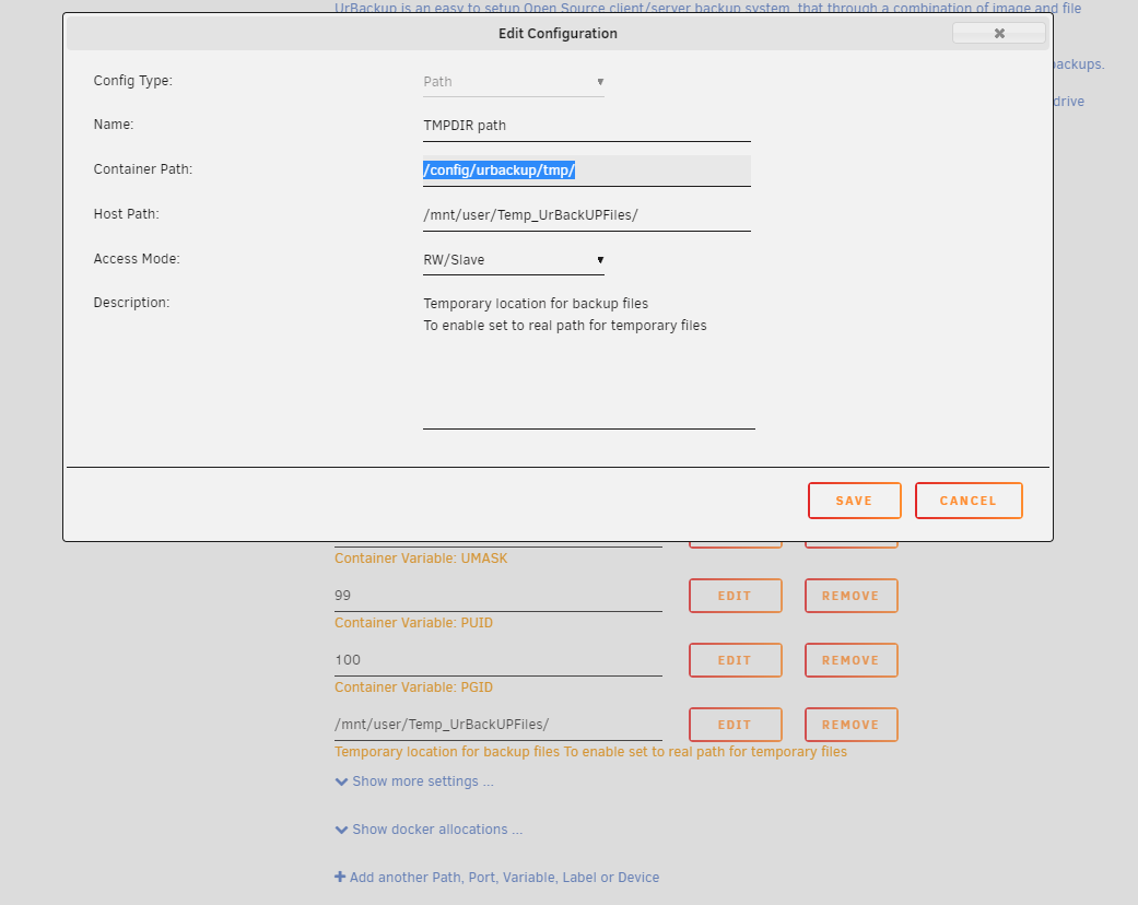

I wanted to enable the temporary file buffers (section 8.5.1 in the manual, this can speedup the backup when you have a slow array), but when I did, all the temp data was (temporarily) saved in the appdata dir.
This meant that if CA Backup started to do a backup while UrBackUp was working, that it also saved all those temp files.
I tried to set a TMPDIR variable with docker, but that didn't work.
It appeared that the TMPDIR var was set in the UrBackUp config file to "/config/urbackup/tmp/", and that the config file overrides the variable.
In the end I solved this by just redirecting the docker path to a external (to the docker) directory.
The "/mnt/user/Temp_UrBackUPFiles/" dir is on the cache drive with a "prefer" cache setting.
Edited by Wimpie
small additions

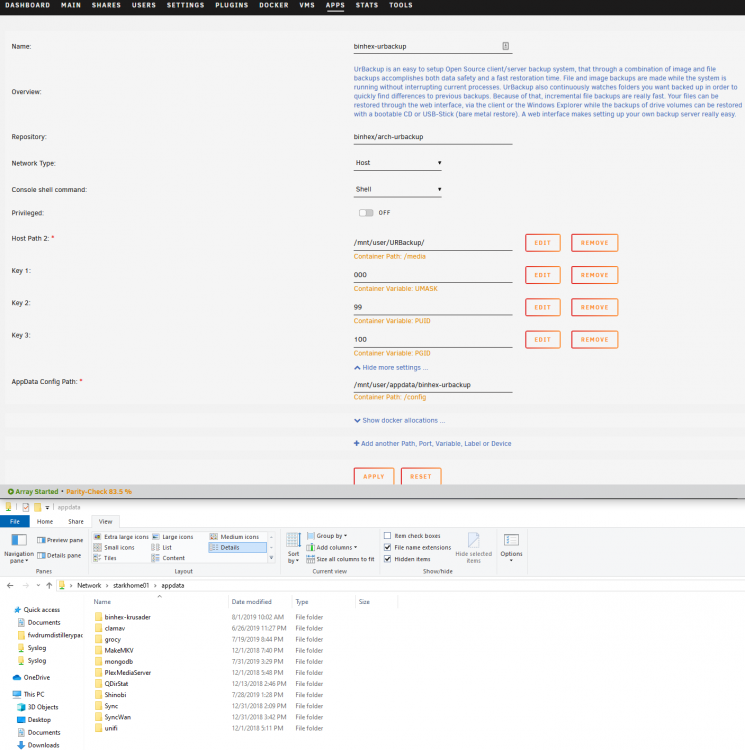

I am having trouble accessing files in the appdata UrBackUp directory (eg saving an edited urbackupsrv config file).
I noticed that the root dir has other file rights than my other dockers.
Is this a bug or a feature?

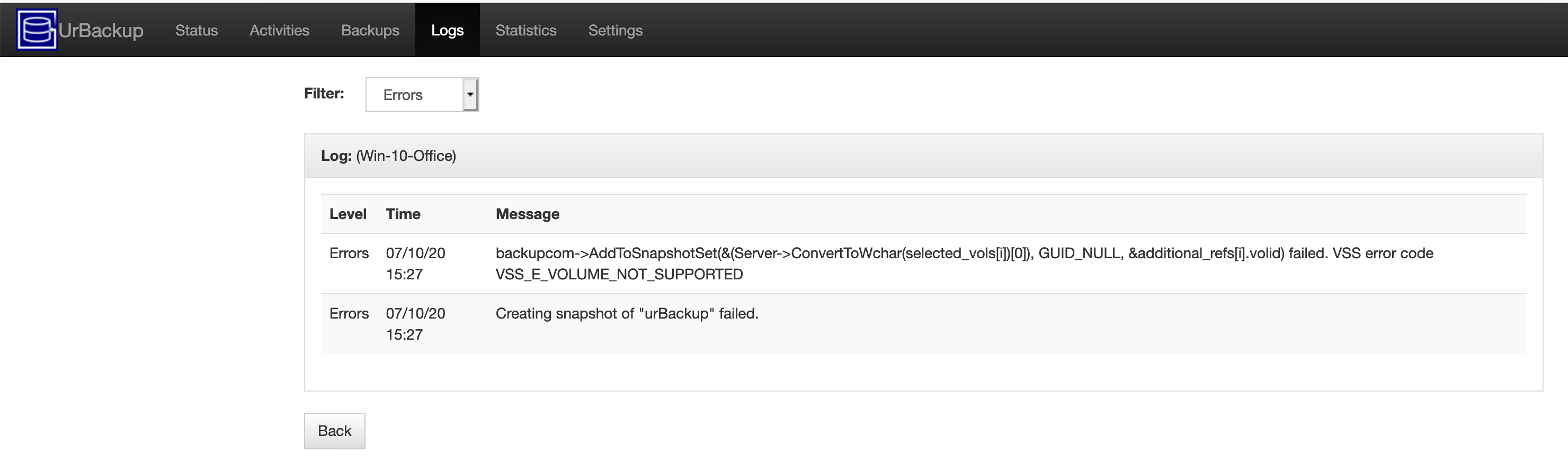

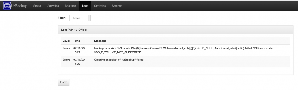

Thanks for putting this together mate.  I got it all configure but I get some errors during the backup.  See attached pic.  Couldn't find anything related so I posted here.  Any ideas?

I guess it either works or it doesn't. I have multiple clients of various flavours, linux, windows 7, windows 10, and they all work just fine.
Did you find any references to your error message when you googled it?
I did google it and found some similar errors but not a real clear fix.  I already moved on but I guess this is free support right :)  I am glad it works for others :)
the issue is a windows one not urbackup, VSS (volume shadow service) is crashing for some reason and thus you are unable to get a working backup of the machine, as you mentioned above there are a lof of google hits for this so you would need to do some trial and error to figure out what the problem is with your machine.
just to confirm i also am using this with zero issue, backing up Windows 10 LTSB image and file level backups.
Hey thanks much for taking the time Sir.  I will keep googling and see if any fixes works.  No rush on my end as is not critical.  Thanks again mate

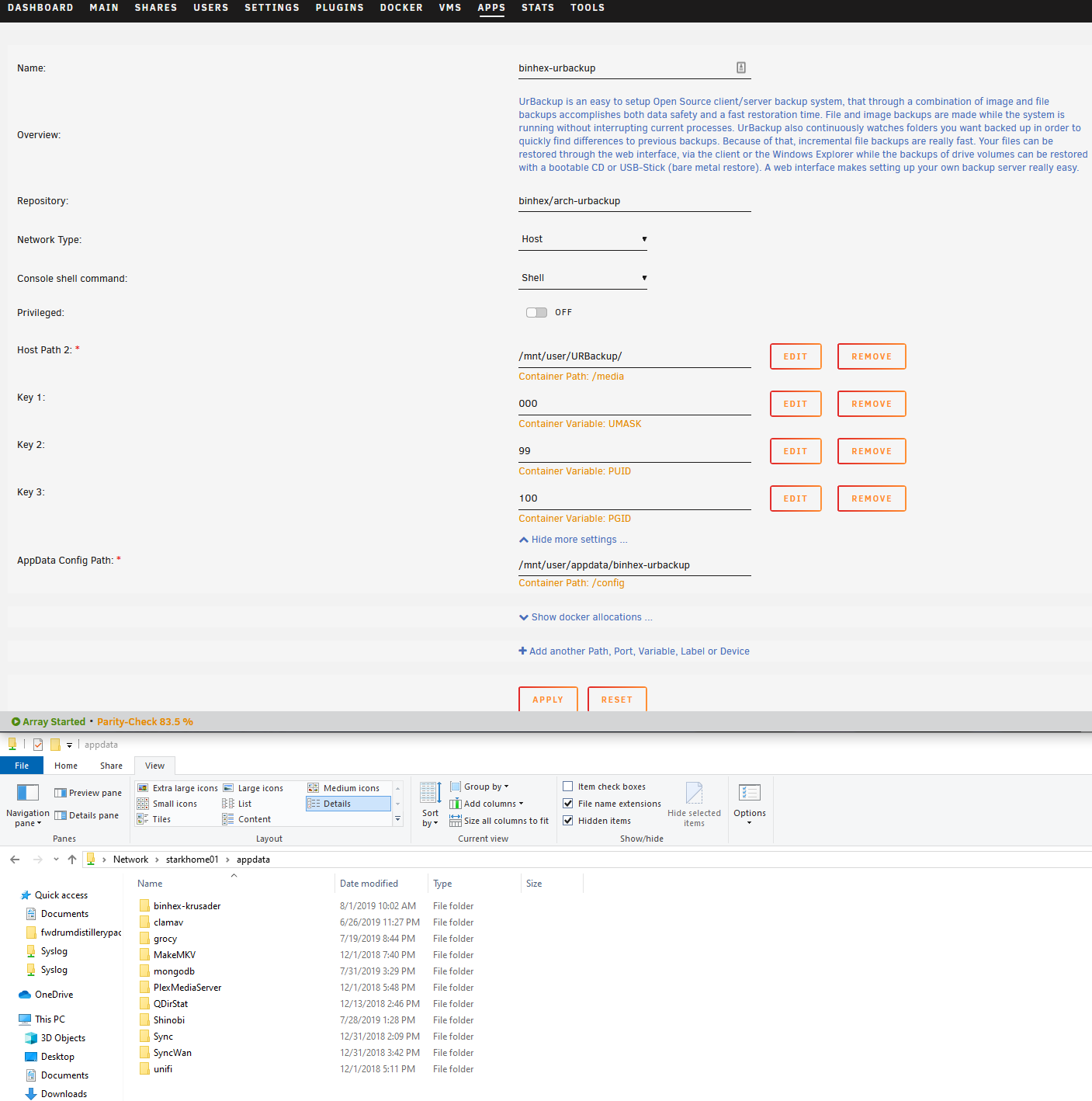

If I manually specify a user share it will create the temp folders, client folders in that share?  I'm trying to keep my root share as "clean" as possible w/ just like backups, TV, Movies.  It seems like it would work in my head and wanted to throw it out here before I try it this weekend...or next weekend.
Edited by cbr600ds2

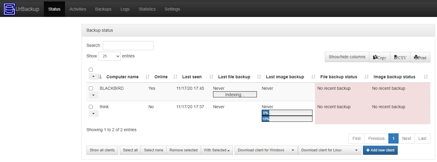

For those that have completed backups with this from a Windows Client to unraid
How long did it take?
What was the docker app pointing at to store the backups?  Unassigned device / Unraid Cache / Unraid Array
I have this setup and it appears to be working but my 500GB SSD on my windows host has been running for nearly 24hrs now and its still listed in the webUI as "indexing"
I'm seeing writes to the array in the <1MB/s range
I have it set to a share that doesn't use the cache.

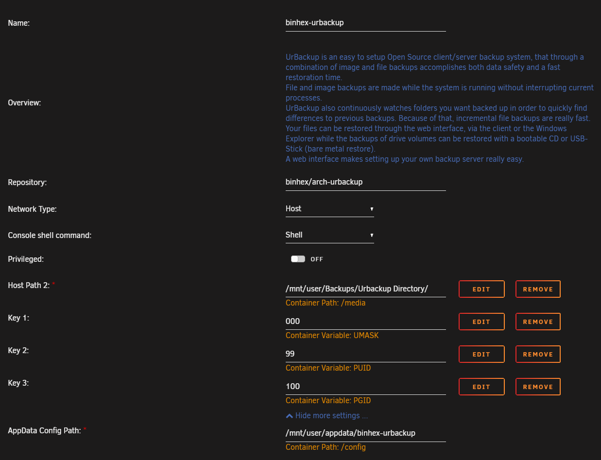

I have 2 Windows 10 clients hardwired on local gigabit LAN. Logs on one of them are showing an average speed of about 170 MBits/s during full image backups. This works out to about an hour and 15 min for 100 GBs of data. I'm writing straight to the array as well and I think it usually goes to my 5400 rpm drives in the array since they're the least full. Grafana shows my array disks getting hit with about 15MB/s from urbackup during backups. I also haven't had turbo write mode turned on for Unraid until yesterday so I might start to see higher speeds. Oh and I use the compressed format offered by urbackup which probably makes a difference! Seems this is only a single threaded workflow so speeds may vary depending on your CPU capabilities as well (I'm running a Ryzen 7 1700 Stock).
Here are my docker settings in unraid, I had a couple other things I wanted to keep in my Backups share so that's why /media is directed to a subfolder:
Just a couple thoughts you may want to check:
  • I have my minimum free space set at 300GB for my Backups share, what is yours at? This might have something to do with it but I doubt it since you said it's stuck on indexing...
  • Have you gone through the Client settings in the urbackup UI?
    • This one was big for me, I could not get it to back anything up for awhile because of default directories, excluded files, some windows file paths it didn't like that were hidden deep in AppData, among other things I think...
    • Would recommend using the documentation (link in WebUI) to populate all of your settings appropriately from the server side and then uncheck the option allowing clients to change settings. When I allowed clients to change settings and adjusted them client-side, it never seemed to want to sync up!
I'd probably recommend removing the docker image for urbackup completely, cleaning out its spot on your array, uninstalling the client-side software and starting over with a clean slate! Had to do this when I added my second client since I screwed it up somehow. I can share pictures of my server side settings if you'd like as well.
*Disclaimer: I am definitely not an expert on this, just happen to have it running smoothly on my setup so results may vary lol

Thanks for the advice.  I'll try starting again from scratch.  I know around the time I was first trying this I was also setting up timemachine, and some other stuff, and ended up filling my cache drive.  That was where I had appdata and all my VMs.... they were not happy about that...  I've since moved all my appdata and vms to a 2TB nvme ssd, but its possible some left over config either server or client side is still messing stuff up.  So I'll nuke it all and start from scratch.
I also found a docker container in CA that will test each drives read and writes.  I'll turn off everything else and give that a try, as well as just try to move some files to the array via a windows share.  That should give me some comparisons between urbackup speeds and what I can verify the system can do.  My end up pointing out some bigger system problem... though I can't imagine what atm.
