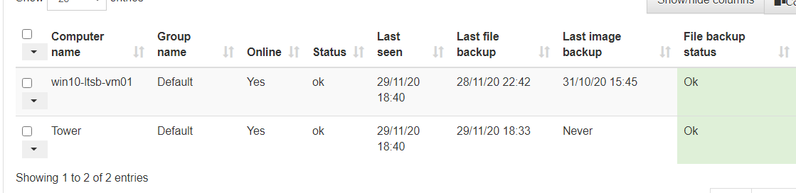

Great! This is exactly the thing I was missing with UrBackup. I already had setup a Win10 VM to backup Unraid directories.
A couple of questions:
- Where does it install the binaries?
- Is it automatically restarted whenever the server is restarted or did you do something to enable it?
by look of it:- /usr/local/bin/urbackupclientctl
as its installed to ram (keep in mind everything is in ram in unraid, other than cache, array disks and flash drive), so you will probably(i dont know yet), have to re-run the script i mentioned above, or perhaps just copy the urbackupclient that gets built and shove that on your flash drive and then copy that to /usr/local/bin/ and execute that as part of the go script - whateve the mechanism there is a bit of fiddling to be done but its def doable!.
